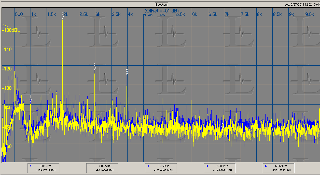

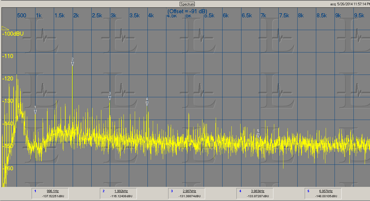

TPA6120 measurements
Here are a couple of measurements. More soon. . .
This is running 15 v supplies. The input Z in 1K and its running inverted. First no load second, 50 Ohm load. The second harmonic is the only offender really. If I can graft an opamp around it using the proposed circuit it will be interesting to see where I end up. I will explore dead-buging it over some ground plane.

Thanks--what level? For the application under discussion I'd check with +20 dBu.

Right now, with the 1K input and unity gain my lowest distortion source will only get around 2V out and it still has the 10 Ohm series output resistor. I need to so some more surgery to get it right. There are zero ohm resistors to ground on all the inputs and there is no solder relief on the pads so its not quick to reconfigure.
I think the second harmonic is actually better than shown. The 725D still is a little high on that harmonic. Not sure why. The older 725 seems to be better on this right now.
If it responds to the dual loop things will look pretty good.
The 2H shown on the 725D is about same as AP2722, as I recall.
