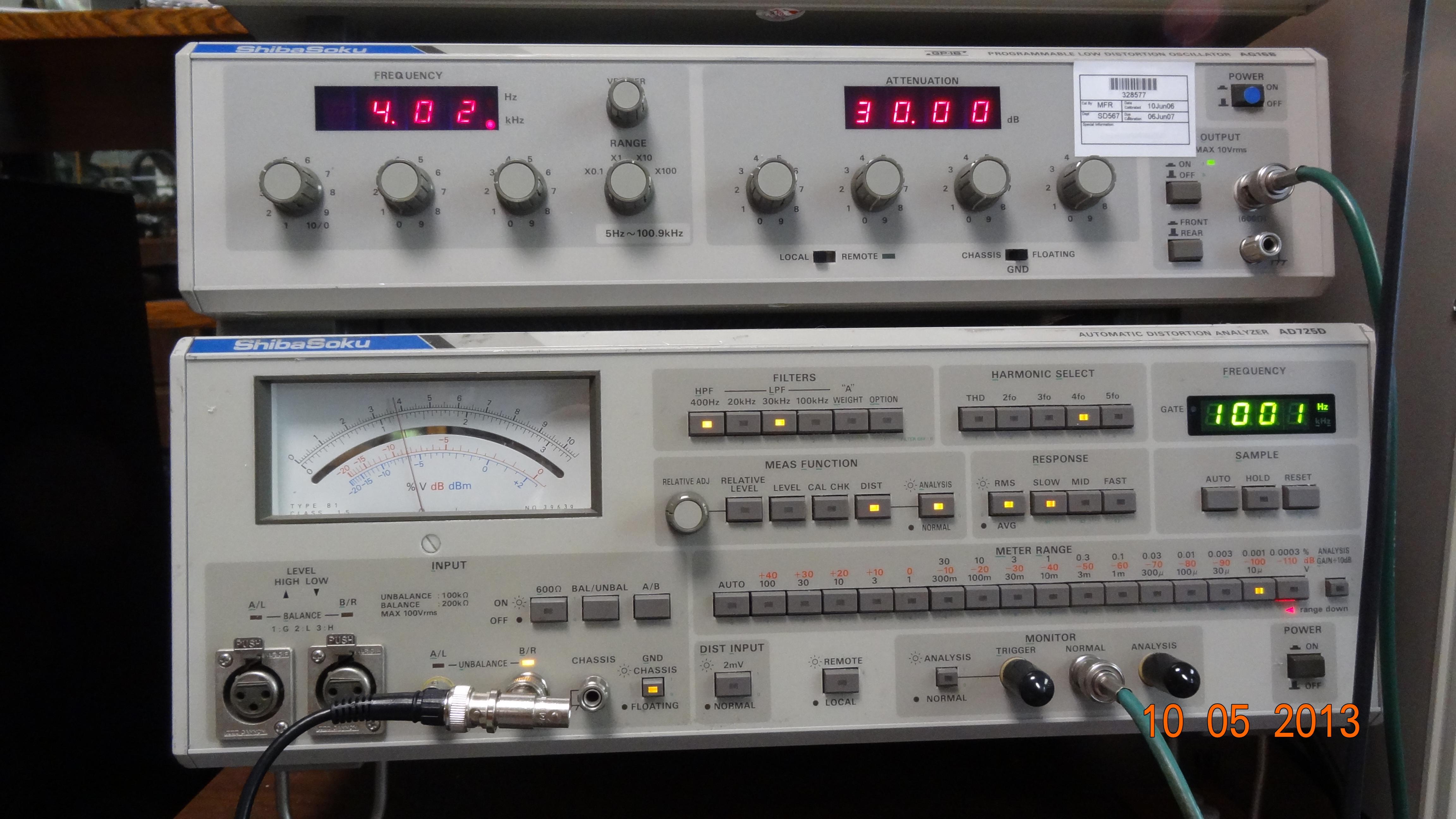

Demian.... it isnt relavent to these pictures. You only need to see the 3H is lower in some analyzers -compared to the 2H. It could be 10% THD... or .001% THD it doesnt matter.
[I also did as you suggested already and pointed out some interactions with that signal a few lines back.]
Here, I dont care what the absolute levels are. I am showing differences in the recovered Harmonic levels for the same input voltage/source/freq.
If the 2H and 3H do not have the same relationship in level to each other then what are some of the possible explanations for it ?
With the 725, the 2H and 3H are at similar levels to each other. With the other analyzers, the 2H is much higher than the 3H.

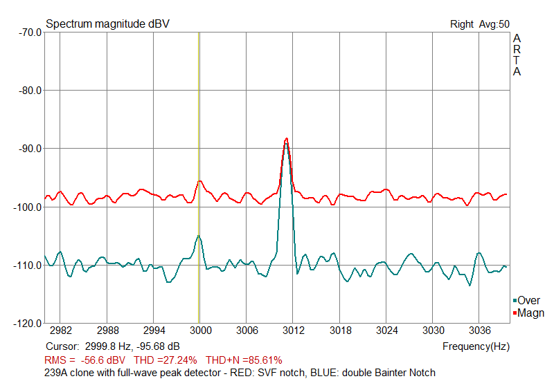

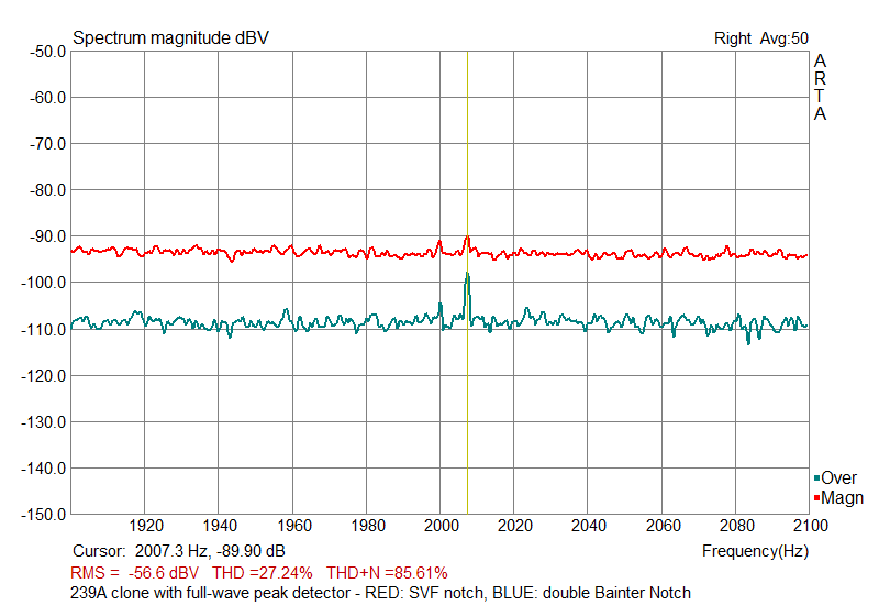

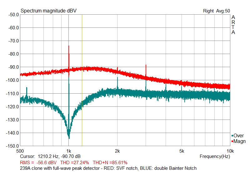

Here is what I get when I look at residuals of my 239A clone thru a double Bainter notch or a SVF notch with auto nulling with the same post-notch gain (40dB): the two notches agee on the level of 3rd h, but the latter overestimate (or the former underestimate?) the level of 2nd h. When measuring sources of higher THD (eg the true 239A) the agreement between the two notches is almost perfect.
L.

Pretty sure ; at least when residuals from source and THD analyzer have comparable levels. Using two analyzers based on different topologies and/or technologies helps to figure out the problem, but doesn't solve it.
L.
This indicates the analyzer was getting a bit nonlinear at very low levels? Then at what level, for your system, is it accurate or become inaccurate?

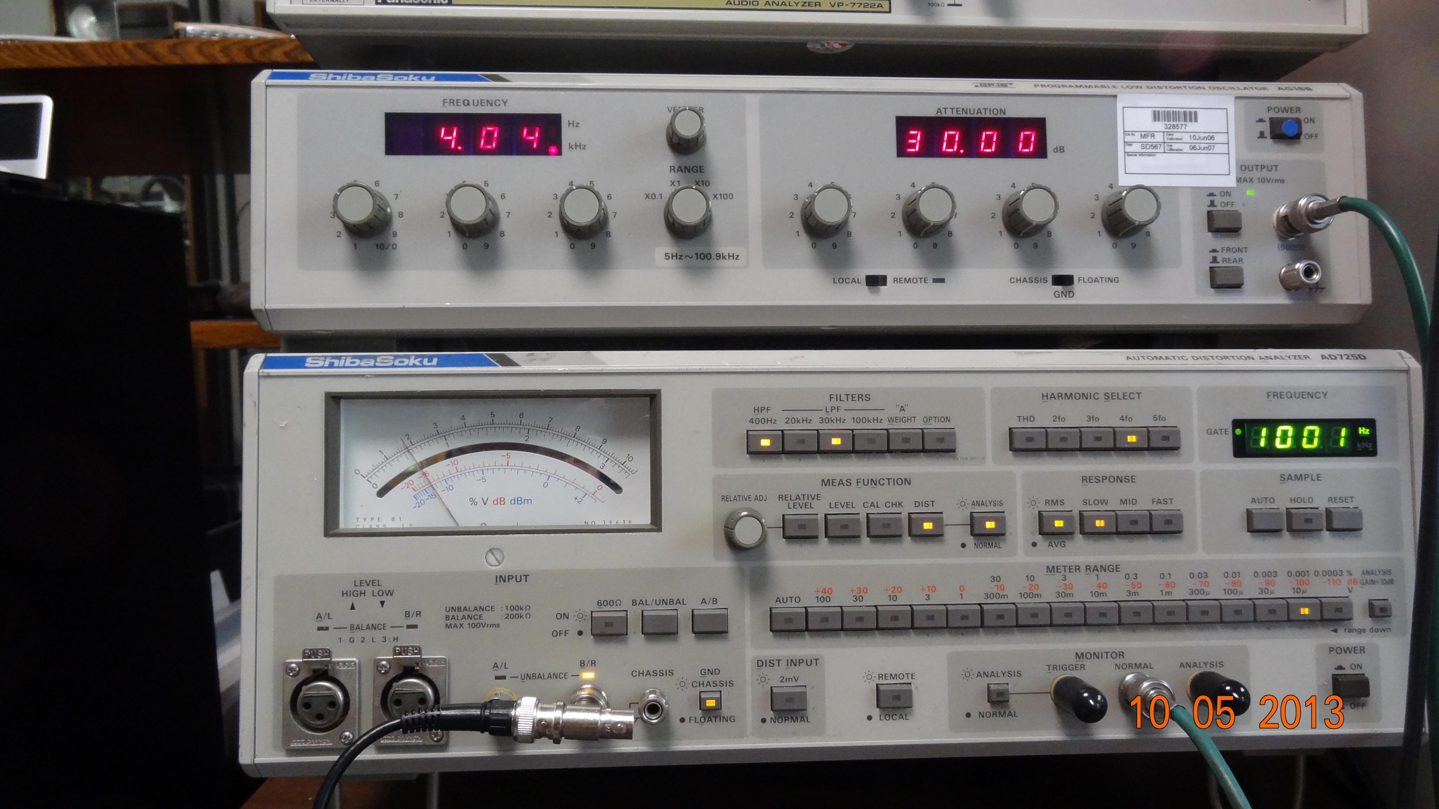

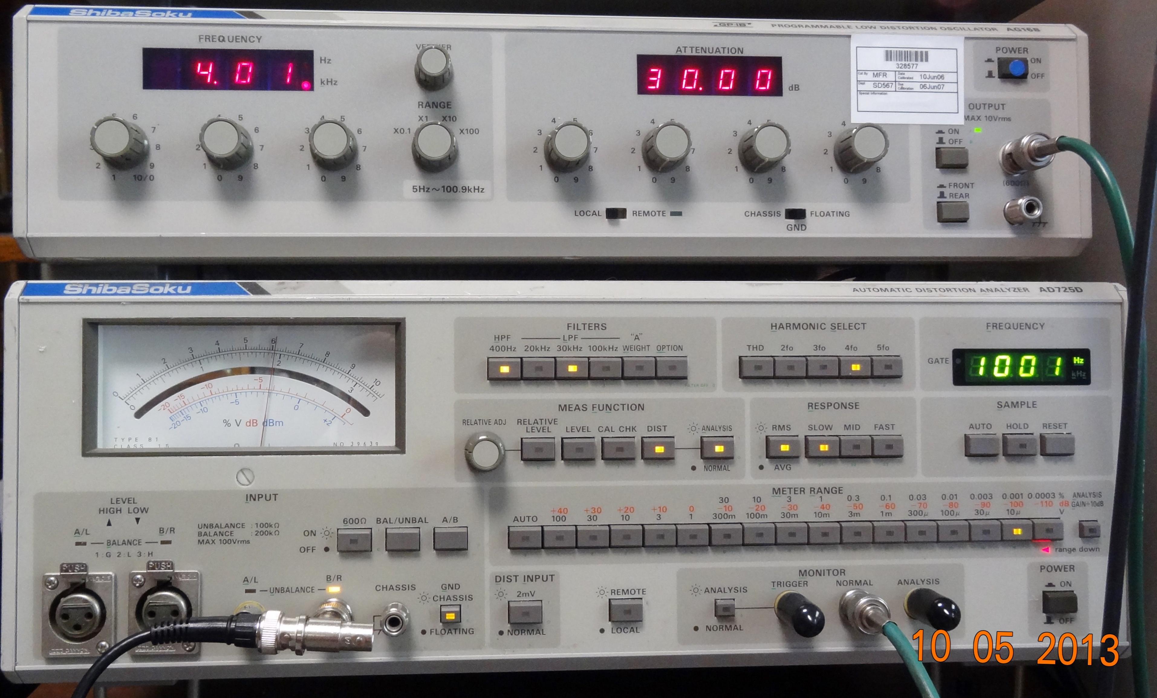

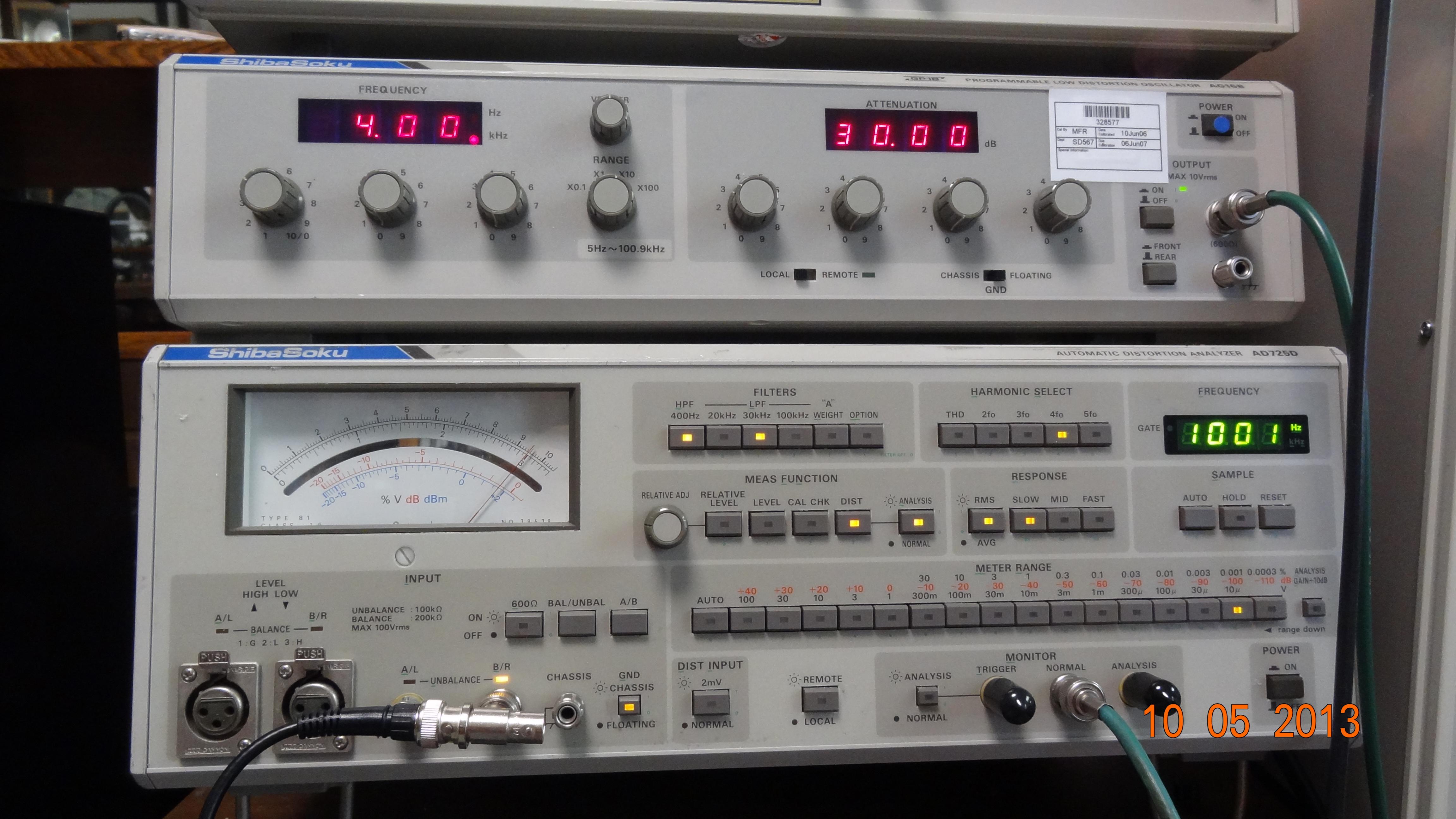

OK. I ran the analyzer with dual freqs.... 1Khz/1v The other freq was passively mixed in with a precision 1000:1 atten. The osc were the 339A for the main freq osc and the AG16 ShibaSoku osc for its precision atten and freq adjustablity.
The AD725D was flat across the first 5 harmonics.
But, it did point out how important the tracking must be between osc and analyzer. If the harmonic freq filter is a fraction of a percent off of the fund freq, the harmonic level drops fast (very high Q). How much? See attached:
Just One percent difference is a disaster... big drop in measurement level.
Thx-RNMarsh
