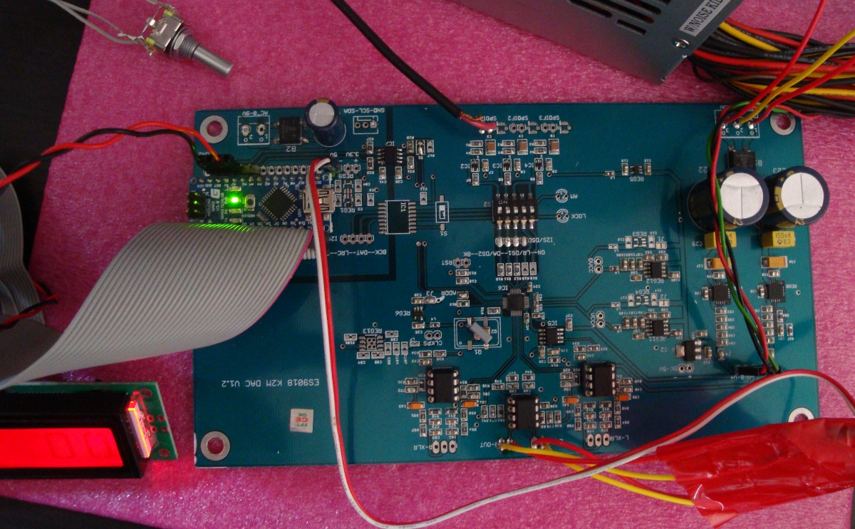

Are you sure you got the adress right in your code? If you use the code as it is from Hifiduino, I believe you have to move R13 to the paths just below to connect Addr to Gnd. Did you check your signals reach the chip? I just tell you this without having the board myself and based on the pictures! Good luck

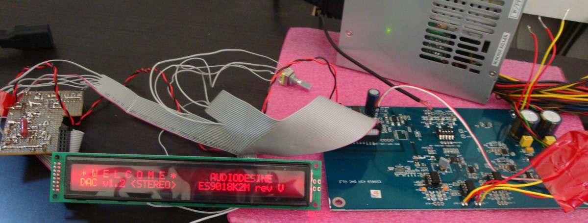

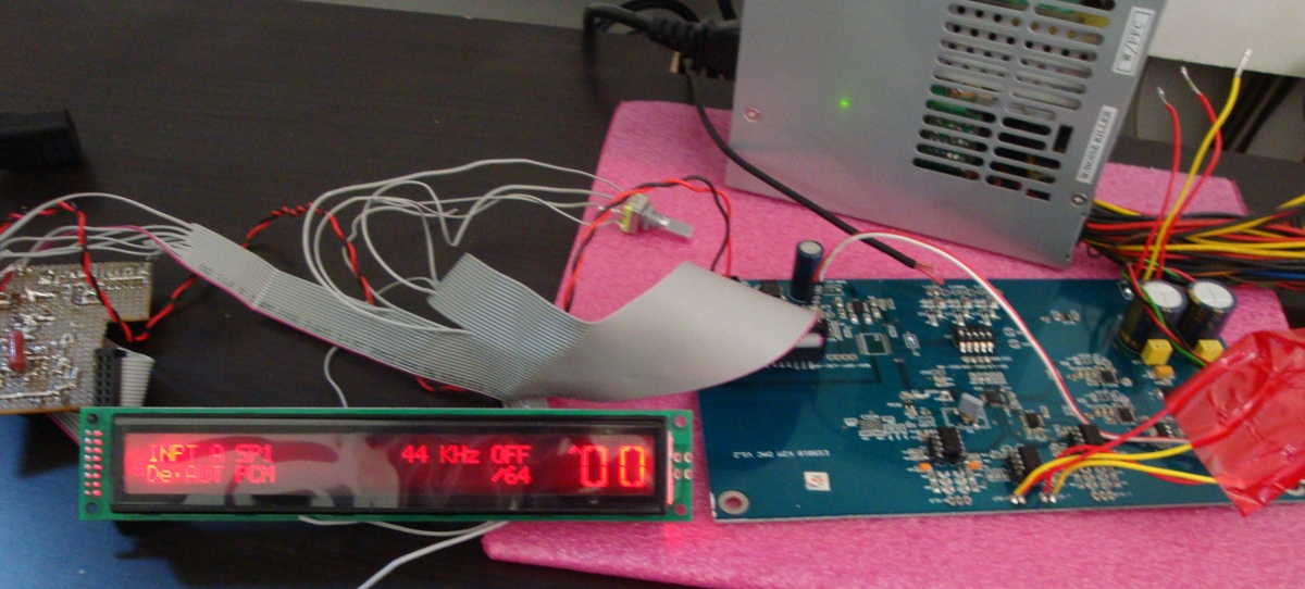

The DAC with MCU works.
The ADUM1250 works perfectly but D1 should be remove and short-circuited and R17 only remove.
I used PC supply for tests!
Always two problems:
- input gate oscillates when start the DAC with spdif signal ON.
- cutoff during playback however the software parameters.

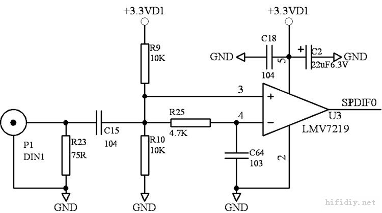

Does this mean I MUST use the MCU to make the Spdif to work?
You shouldn't have to use one for it to work - what SDF has done is a work around, not a cure. I suspect it's either the earthing between input and DAC, or some detail of the input stage not switching cleanly. Or SDF just has an extremely jittery source.

It's an airport express which works perfectly with a DCX2496 or denon AV receiver but I have some troubles with Meridian 518 and tact RCS2.0...and know with the ES9018K2M in stand alone mode.
By the way, increasing DPLL bandwith solves the problem!

For those using spdif input without MCU, DS1 and DS2 should be connected to ground.
