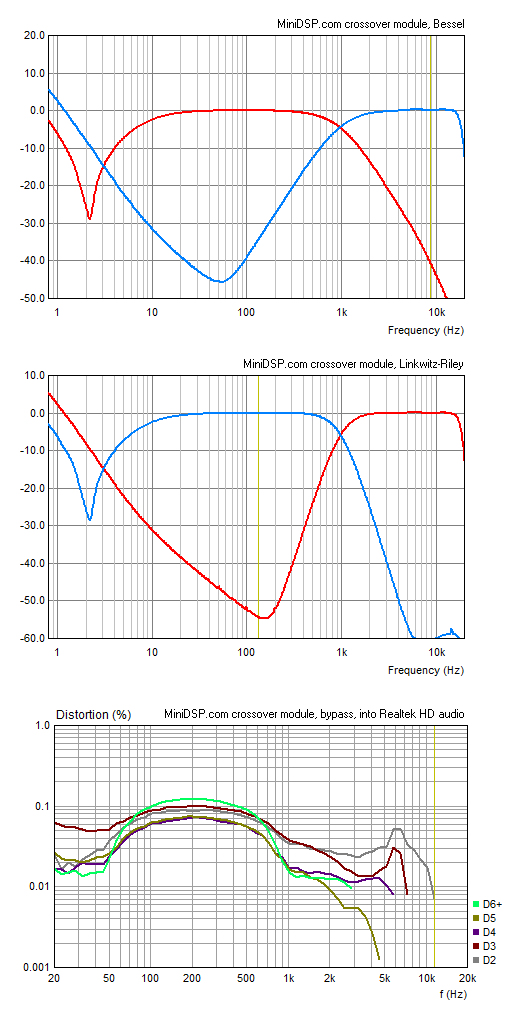

I've had a closer look, and sent them an email.... I have a suspicion that this board may be too limited by the hardware.
The existing analog i/o is not good quality - it will be up to them to make a high quality daughter board with enough outputs to make this actually useful. And then you might be running out of DSP power.

Hi jzagaja and crossoverman
Really interesting board, and quite reasonable in price.
Can you see what ICs the board is based on???
DSP, ADC/DAC codec etc.
You said the audio performance lacked a little. Compared to what?

Hello Baldin,
FYI, We're trying to answer all technical related question DIY audio members may have in the following thread:
http://www.diyaudio.com/forums/minidsp/158963-minidsp-kits-our-answers-your-technical-questions.html
You may want to have a look at it.
As for the low frequency measurement that jzagaja was refering to, I believe that he was talking of his PC ADC performance since we're certainly not able to see this rise on our measurements.
