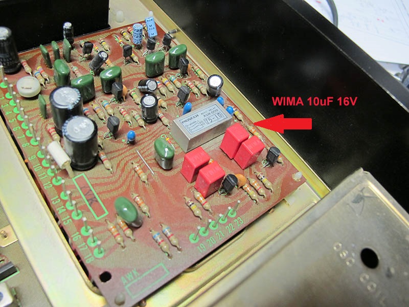

My TX-9500 has stopped working -- not like it's the first tuner I've fixed --
Easy -- the 10uF tantalums on the audio section were shot, replaced them with 10uF/16V Wima's which I happened to have on hand. I guess they can fail "all of a sudden".
Cleaned up the selector switch with a couple squirts of DeOxit.
Sounds great!
