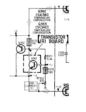

What are your suggestions for the bias network?
More playing around:
I will reduce R7 to 1.3K and R8 to 1K. This will increase current through the drivers and balance them a bit better.
With the increased current, I will probably use 2SC4793/2SA1837 for these rather than the 2SC3503/2SA1381.

Apply square signal at the input and watch close fully the voltage across new bias circuit for any signs of instability. D.Self warned us about possible stability problems that may arise when using this kind of bias circuit.
I have used this circuit (in simulation only) and I have seen some ringing with square signals. Putting an compensation capacitor between BC of second bias transistor helped a lot.

The way I understand it this new Vbe multiplier will hold the bias current steady, more accurately than the single T one - probably a good thing in a class A amp.
Having ran a few simulations, I will (potentially) change cdom to 22pF, depending on the real amp performance. The sim shows unstable operation at 15pF (confirmed in the real amp during tests and I didn't have a 22pF to try at that time) but proper compensation at 22pF. Worth a try.

I agree with Blueskynis, CFPs like to dance and I'm still not through finding all the oscillation possibilities in my own sims.
I did find it helpful to include some degeneration on the emitter of the slave device. I think on your schema that means 22R on the emitter of U5 (actually U4 but this is where you want it I think).
How do you adjust the 'dc' offset at the output ? - I know there's a cap, I'm thinking about the fact that you want the 'dc' on the amplifier side of the cap to be half way between the supply rails to maximize the up and down swing you can get. How do you set this - or is it simply close enough from the symmetry of the topology ?
Bigun said:I did find it helpful to include some degeneration on the emitter of the slave device. I think on your schema that means 22R on the emitter of U5 (actually U4 but this is where you want it I think).
A quick breakdown of this topology (if I understand it correctly myself )
Q2 and Q3 are the closet to a CFP - they are the "differential transconductance amp" Rick referred to with the base of Q2 as the non inverting input and the emitter of Q2 as the inverting input. R13 is the feedback resistor.
Q3 is effectively the VAS with U5 as a voltage buffer with current gain.
Q4 and U4 are the Vbe multiplier.

I might be mixing this up, but I thought you have introduced a CFP as your Vbe multiplier ? And in this design the master is U4 and the slave Q4. The master provides a signal to the slave via the collector - base connection. Current flow in the master is held low by R12, the slave does the heavy lifting of course. In my LTP it is the emitter of the master that required degeneration, which if this is at all relevant in your design would mean including a resistor between the emitter of U4 and the emitter of U5. Even I have confused myself now
