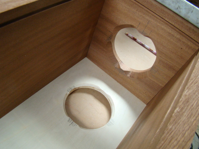

Right. I knew you meant the inside, driver hole chamfers. I was referring to the text in the MT document which said it may not be necessary, but what I forgot was: it says "for thinner baffles." So Evan's logic to do the top baffle matches up. Thanks for being a step ahead of me.
Here's a shot of a dry fit showing the chamfer behind the driver. I did the solid as well as the ply.

And please remember Evan:
1. The braces should not be centered to the driver, they should be slightly offset on one side - say by 20 mm or so (width of the ply/wood)
2. the brace should make contact with the rear of the driver magnet, but should not so tight that they stress the basket.

Evan,
In the attached pic I see you've left some of the wood behind the mount hole without chamfer - is that for the driver screws?
AFAIK you need to chamfer the whole circumference - don't worry about the screws. The basket depth of the MA EL70 is 6 mm, so even after rebate and chamfer, you should have enough wood/ply board left for screws to go in and hold the driver.

Going to the CSS website I see that the screw holes are in line with the spokes of the basket. Bearing this in mind I can't see how leaving some material here for the screws to grab would effect anything. This said I would still defer this decision to a more experienced builder......Evan
Evan - I'd leave them as they are.
Even the smallest models of Mark Audio drivers have thick enough flanges that when rebating for flush mounting there can be very little material remaining for screws. You want as much core thickness as possible at those points, whether using wood screws or threaded inserts.
If you're applying any damping material to the areas surrounding the cutouts, leave a little extra margin immediately adjacent to the screw mounting holes to prevent clogging of bit when drilling pilot holes or woods / machine screws that will likely penetrate.
