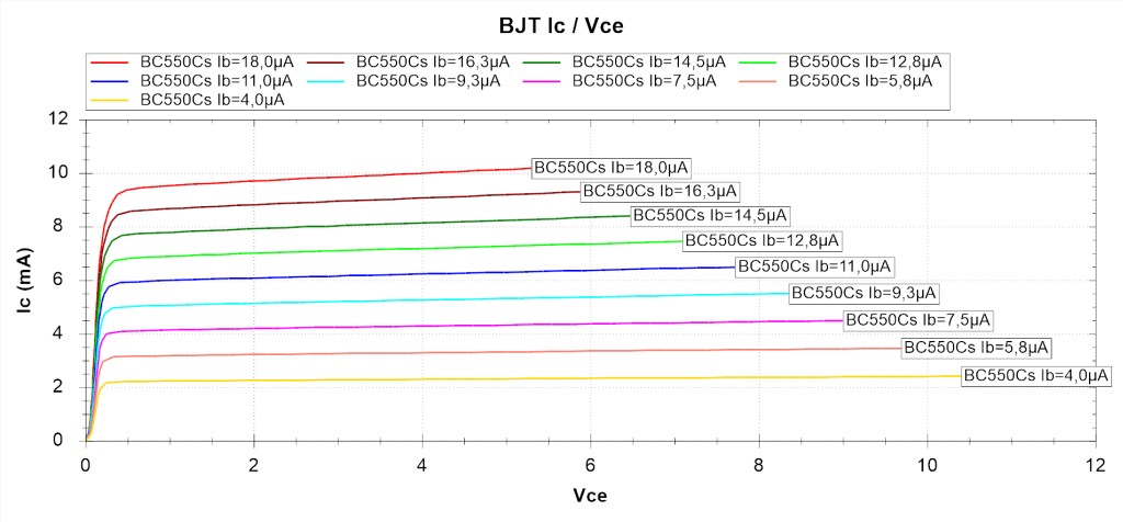

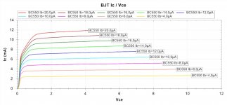

Two BC550C transistors from different manufacturers. First one with black faceplate and the second with silver colored faceplate.
BC550Cs = silver faceplate
After viewing the two plots in post #43, I am reminded of the wisdom of my very conservative first boss: Qualify Your Vendors! Then keep re-qualifying!
This was a guy who insisted on writing seven (7) copies of a mask database tape during IC tape-out. Then send three of them to the mask shop. Now those lazy oafs in the mask shop can't put your job aside and party all day, claiming "the tape won't read."

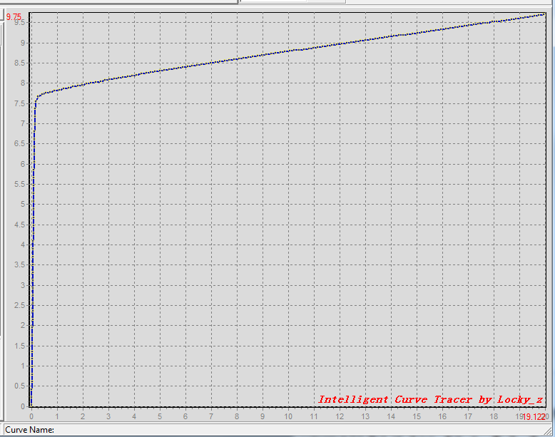

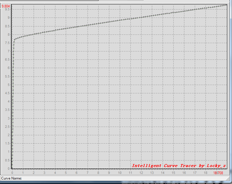

Found this "sleeper" in one of the tables in The Art Of Electronics, 3rd edition. It sure doesn't exhibit any quasi-saturation! Early Voltage "VA" is 590 volts. Nice.
_
Hi Mark,
This does indeed look like a nice device. I'll have to look up its datasheet and see if it has a complement and what the ft is.
BTW, I noticed that the Locky curve tracer was used for this plot. Did you do the test that produced these curves? I bought a Locky curve tracer over a year ago, but never had the time to set it up and use it. Was it easy to get it up (assuming this was from yours)?
Bob
Yes the LockyZ curve tracer is easy to set up, once somebody tells you the magical secret:
BD437's complement transistors seem to be BD438 and BD442, neither of which have a large Early voltage. Measured VA is 87 volts, pew.
When it comes time to install the USB driver software, right click on the installer and select "Run As Administrator". If you fail to do this, misery awaits you. The drivers will appear to install but they won't work properly and you will mutter many bad words from a sailor vocabulary.
Handle your curve tracer gently, LockyZ is not currently selling new ones or repairing old ones.BD437's complement transistors seem to be BD438 and BD442, neither of which have a large Early voltage. Measured VA is 87 volts, pew.
Yes the LockyZ curve tracer is easy to set up, once somebody tells you the magical secret:When it comes time to install the USB driver software, right click on the installer and select "Run As Administrator". If you fail to do this, misery awaits you. The drivers will appear to install but they won't work properly and you will mutter many bad words from a sailor vocabulary.Handle your curve tracer gently, LockyZ is not currently selling new ones or repairing old ones.
