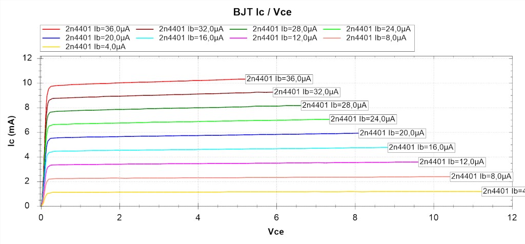

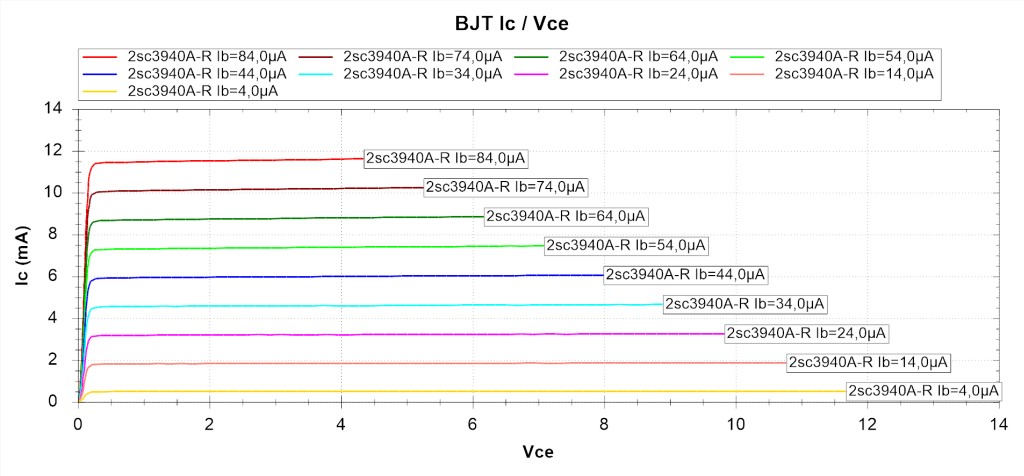

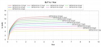

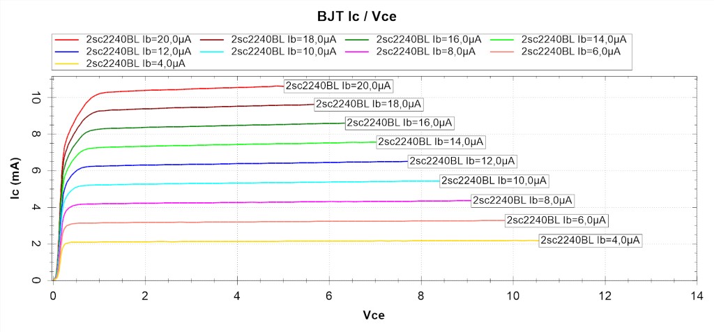

I measured some medium-power (TO-126) and high-power transistors (TO-220) to see whether they exhibited any quasi saturation. Only two of them did.

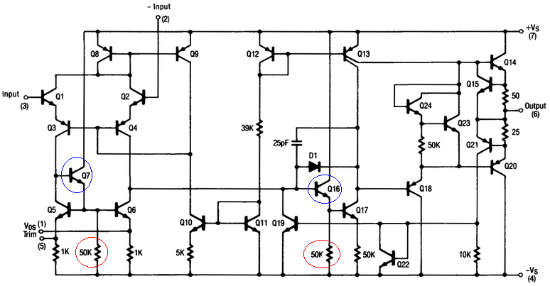

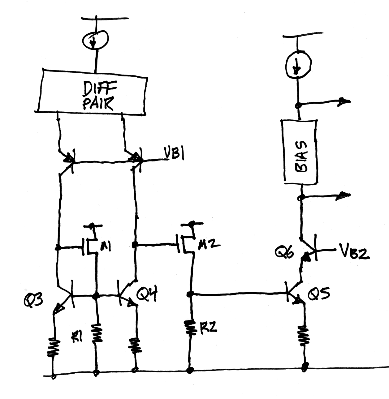

Easiest way to get the benefits of MOSFET infinite input impedance, is to redeploy the original 741 opamp's current mirror load, but replace bipolar emitter followers Q7 and Q16, with MOSFET source followers M1 and M2. Be sure to match the MOSFET load resistors R1 and R2, just as Fullagar matched the 50K emitter load resistors in the 741. We're not building a low power opamp so we can use source leg resistors a lot lower than 50K! Fortunately we can buy dual MOSFETs whose two devices are manufactured side-by-side on the same wafer, see pdf datasheet attached. Although the circuit doesn't require excellent matching, we get it "for free" by purchasing a monolithic dual. USD 0.111 in qty=100.
Now the first stage has enormous voltage gain (= gm * ro_Q4) because it's driving a very high impedance load: M1. And the second stage amplifier Q5+Q6 is driven by a reasonably low impedance source: M1. Very nice!

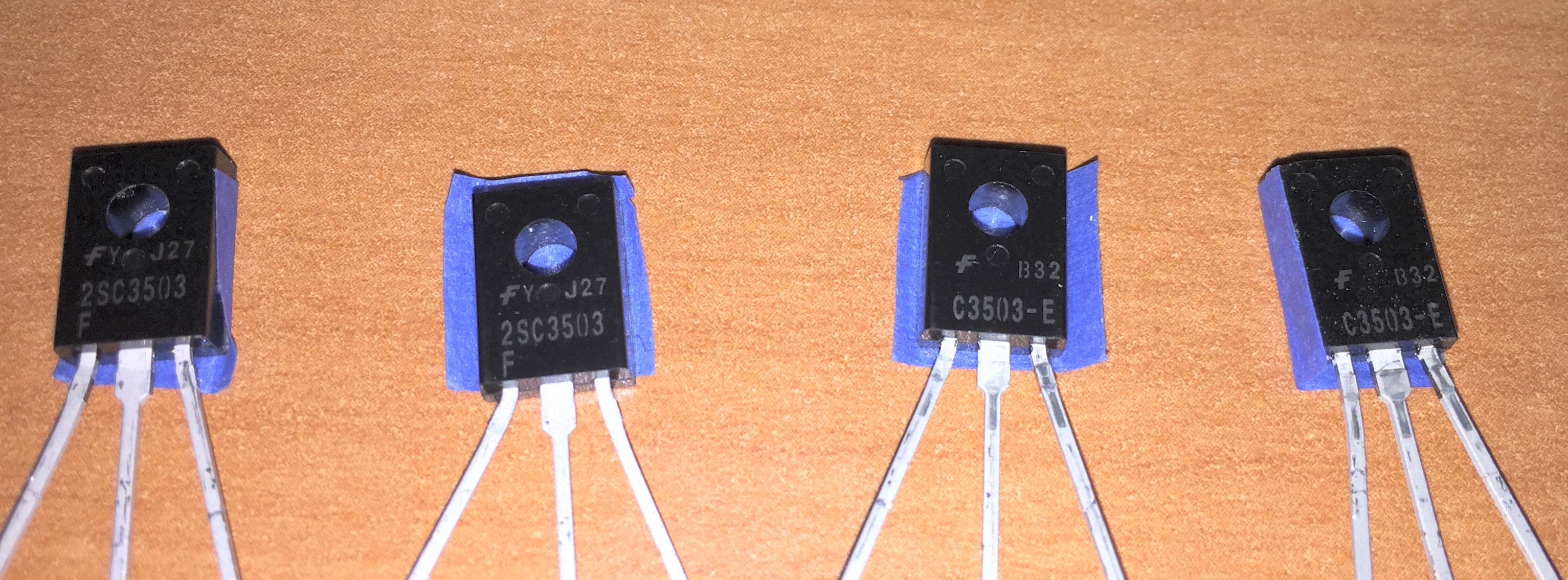

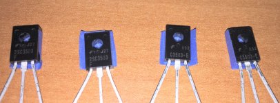

It does begin to appear that the 3503's really do exhibit quasi saturation. I dug out two units of 2SC3503F (highest beta grade) and two more units of KSC3503E (2nd highest beta grade). They are shown in the attached picture. Unit#1 is on the left, Unit#4 is on the right, and they are shown in ascending numerical order. In the photo the stylized capital_F is the Fairchild logo. Blue tape on the back gives me a place to mark the unit#.
All four transistors showed quasi saturation on two different curve tracers. The first is the LockyZ "intelligent" curve tracer sold right here on diyAudio. The second is a low-price, medium-quality, commercial device "CTR101" I bought online. Google can tell you more about it if you're interested.
LockyZ curves include the word "LockyZ" at lower right.
CTR101 curves are solid red lines. Their filenames end in the letter S: Unit_1S.PNG et cetera.
To recap: two units of part type 2SC3503F , and also two units of part type KSC3503E, all show quasi saturation. They show it on two different curve tracers. Pretty convincing if you ask me.

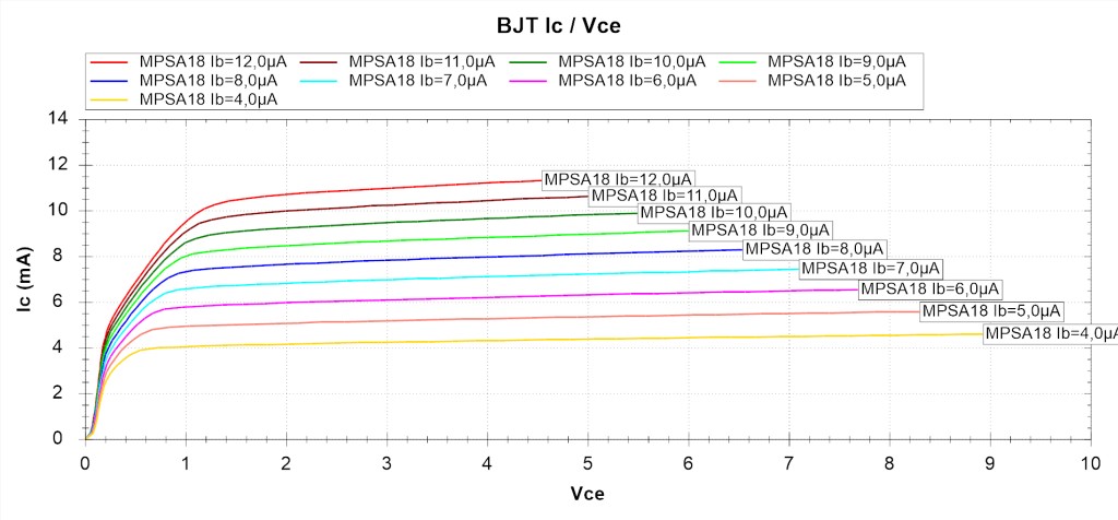

Thanks John! Based on the curve tracer data presented here, I would expect the BC337-40 and the ZTX851 to have the greatest success at 1.5 volts: their IV curves act like transistors at the lowest Vce of all. Datasheet IceMax values are 0.8A and 5.0A respectively. Recall that ZTX851 is the world's champion lowest rbb' NPN at 1.67 ohms according to AOE 3rd edition.Other large area transistors worked as well, but the LOWEST rbb' devices that I could find, didn't. The only clue to the difference in the devices was peak current (50ma vs 600ma) so what Scott just said might be the primary reason.

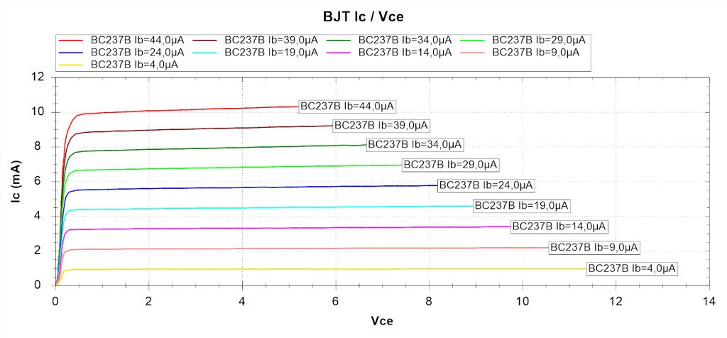

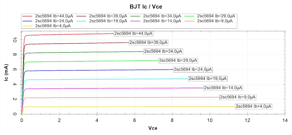

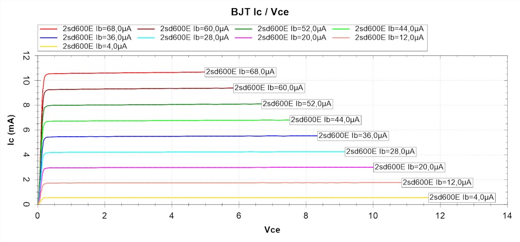

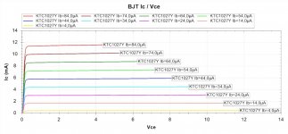

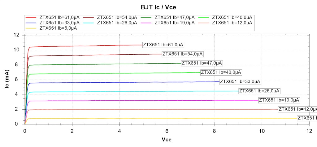

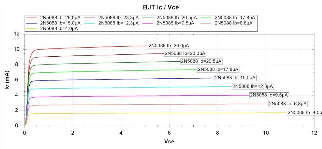

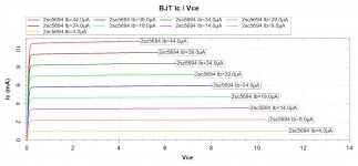

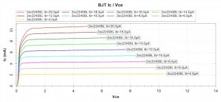

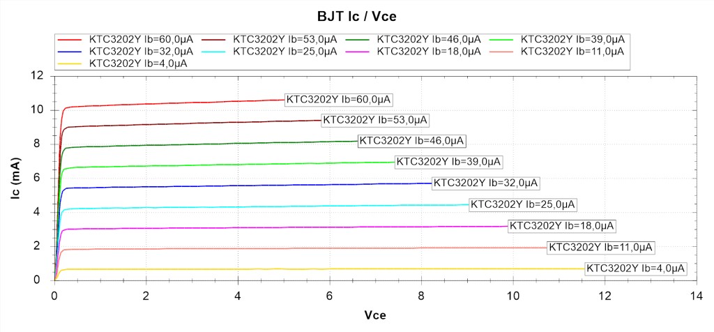

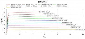

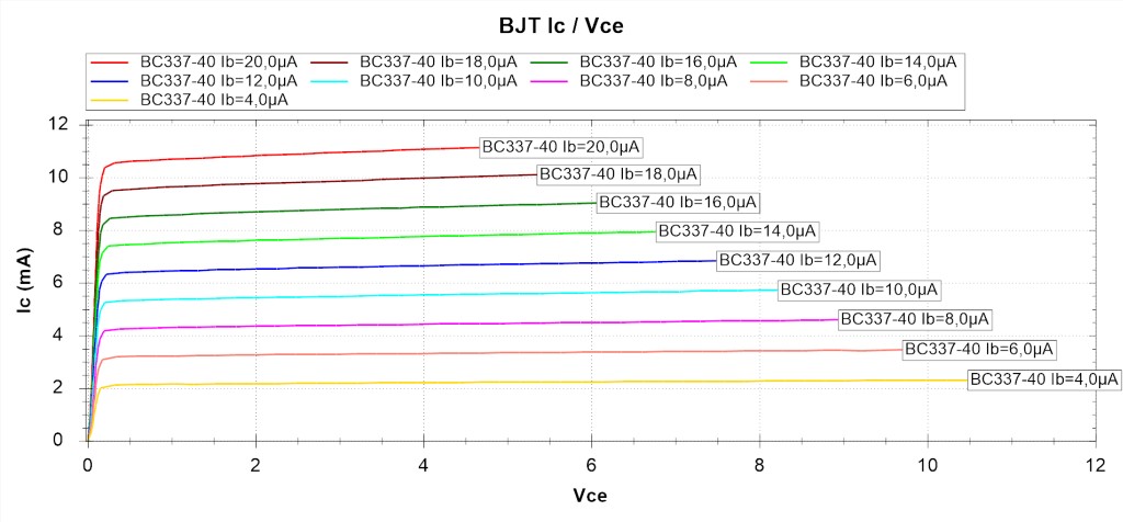

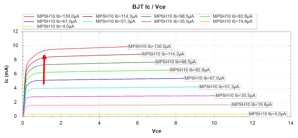

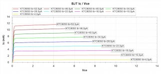

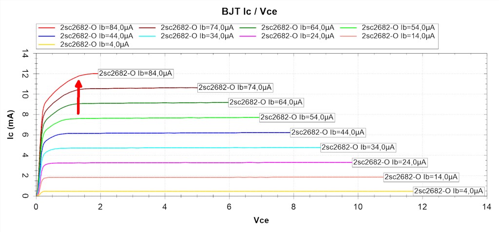

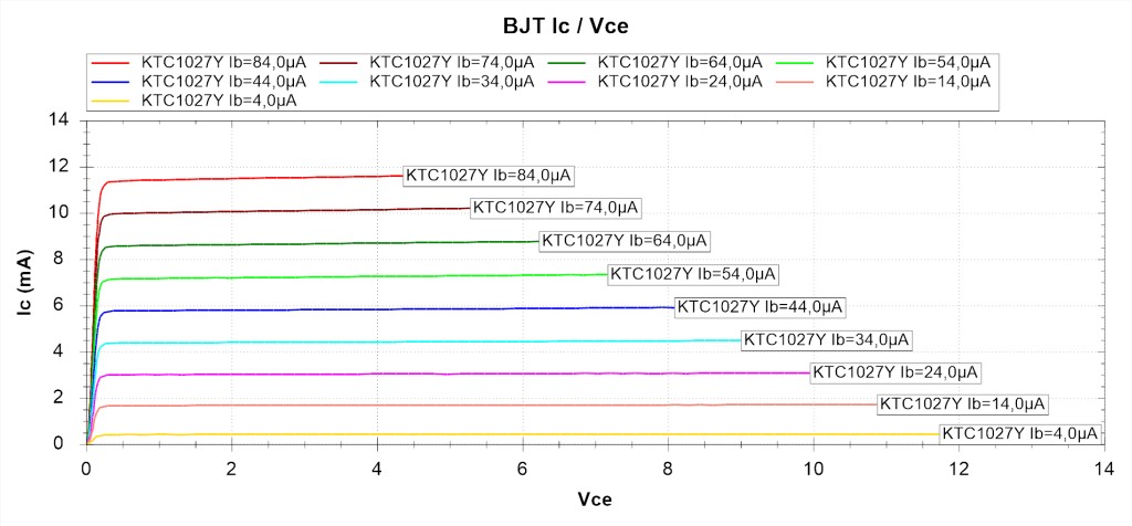

more traces
- Looking for a small signal NPN with no Quasi Saturation: MEASURED DATA
