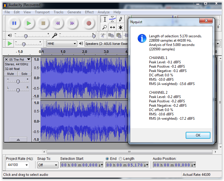

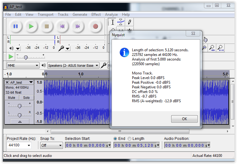

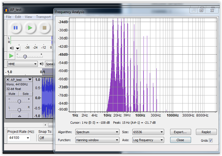

Music vs test tones
Tom, you had a discussion with BrianL earlier regarding the AP test tones. I was curious about this because I felt that Brian had a point. I have analyzed the test tones, and I now understand your point. The average signal of the AP signal is in fact pretty close to a music signal. I compared it to a pretty intense music signal from "Tool" (The pot) and they are both at roughly the same RMS level. See pictures of both RMS analysis and FFT. I will use the same signal for my future testing as well. Thank you for the tip.

About the test tones, I havel always wonder what type of music they really equate to, or whether it is some kind of average?Tom, you had a discussion with BrianL earlier regarding the AP test tones. I was curious about this because I felt that Brian had a point. I have analyzed the test tones, and I now understand your point. The average signal of the AP signal is in fact pretty close to a music signal. I compared it to a pretty intense music signal from "Tool" (The pot) and they are both at roughly the same RMS level. See pictures of both RMS analysis and FFT. I will use the same signal for my future testing as well. Thank you for the tip.

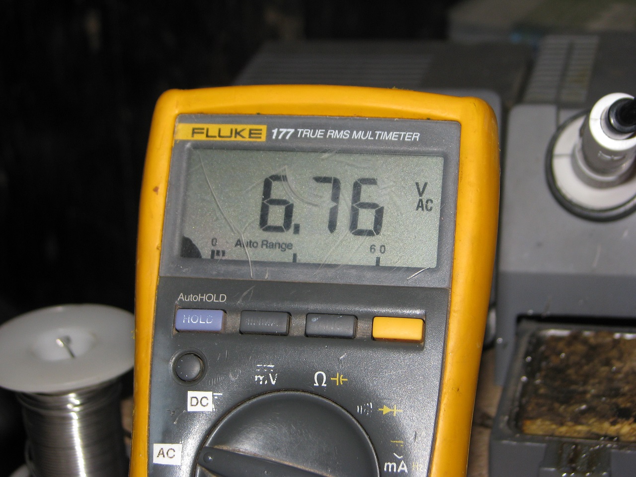

if lm3886 can output 6,7v at 50hz continous sine(not that averaged thing of yours), to speaker of 4 ohms ,without turning on spike and running at that output for full hour from +-12v psu, could you calculate how much heat is being transfered from chip to heatsink of dimensions 94mm *72mm *3mm , that same heatsink being mounted on front side of lm , and somehow prove to me and everyone else that it is worthless as you say it is.
as i am feeling good today i would like to propose a test,if you would like i will mount lm facing front to some huge heatsink i have available(better say water cooling with 240mm radiator) and connect it on better power supply to try to pull more power out of front side of chip than your comercial design can pull out of back of lm (but not "with vanishingly low THD and phenomenal sound quality" just as far as it goes without spike.).but that will i do only if you would be nice and actualy try this you call "new" mounting method for yourself and maybe measure whatever you measure to feel fine.

i dont understand physics and what they say but this small heatsink of mine got hot so what physics say about that, and it was 6,7v measured with true rms meter if that makes difference?
