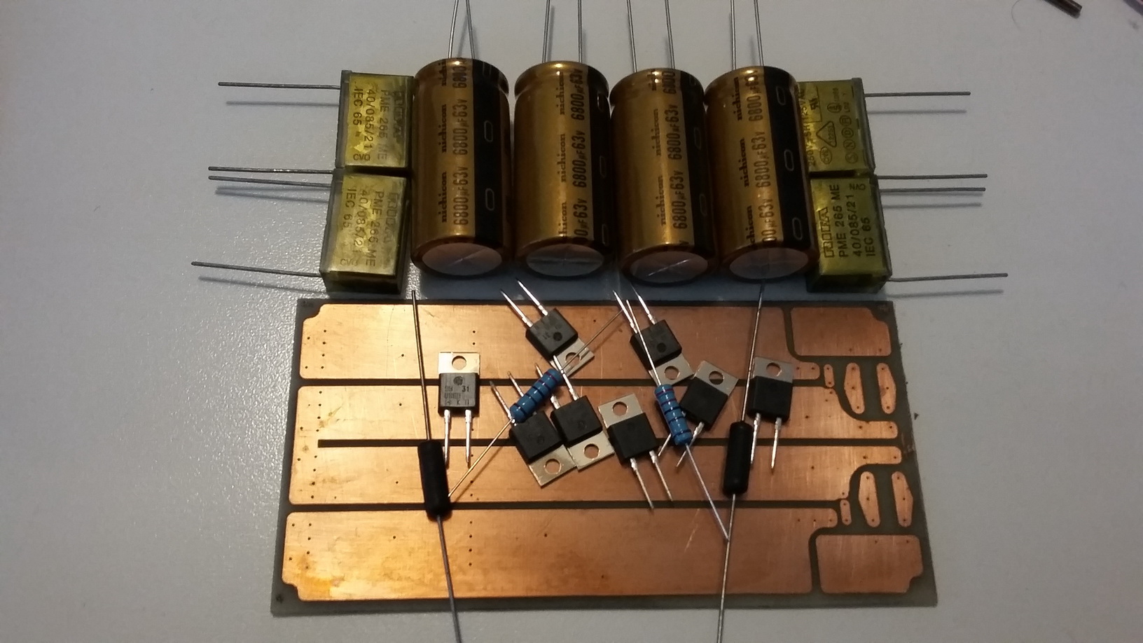

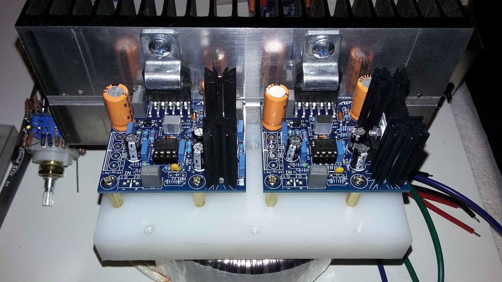

Getting going on a APEX Super Gainclone. Purchased some boards and parts from prasi a while back. He put together a great kit for me. Really really good. Thank you prasi.
Second pic is of the power supply that will be next to put together. Hopefully in the next couple weeks I'll post pics of a finished amp.

Hello bender,
Thanks. Nice build!, even better than me!
The kit included everything, even the op-amp, its socket, heatsink and its insulation, all passives, terminal blocks, except I think the LM3886, am I right?
The orange Keltron caps, ubiquitous/omnipresent in India, finally make it to USA!.
All the best for firing it up!
Are you using CRC filter on that PSU?

It was a complete kit. You even included the 3886 chips. Was very well put together. If I remember right I wasn't expecting the 3886 chips but they were in there. Big thanks to you for a great kit. I've seen no better!!
I don't know about CRC filters. Power supplies are something I wish I knew more about. Just an old design I saw and will implement... So what is a CRC filter?

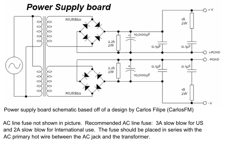

R and C form a low pass filter. Here is an example of an CRC PSU filter.
However, I don't think CRC or CLC or capacitance multipliers filters are adequate for class AB(current pulses) as they bring more trouble than good.
I saw several caps and four resistors so I presumed it was a CRC without seeing a schematic.

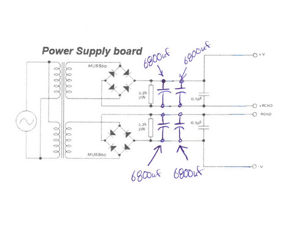

Delete this part and add 1x 10000uF in parralel with existing ones.
Hi bozoc, you delete the snubber, why?
Why delete?
RC snubber is specific to transformer, so using random values is not optimal.
Also, those 0.1uF caps are in the wrong spot, put them parallel to the secondaries.
Something like this work??
Very good.. Move the .1uf's before each bridge or add them? Thanks!
