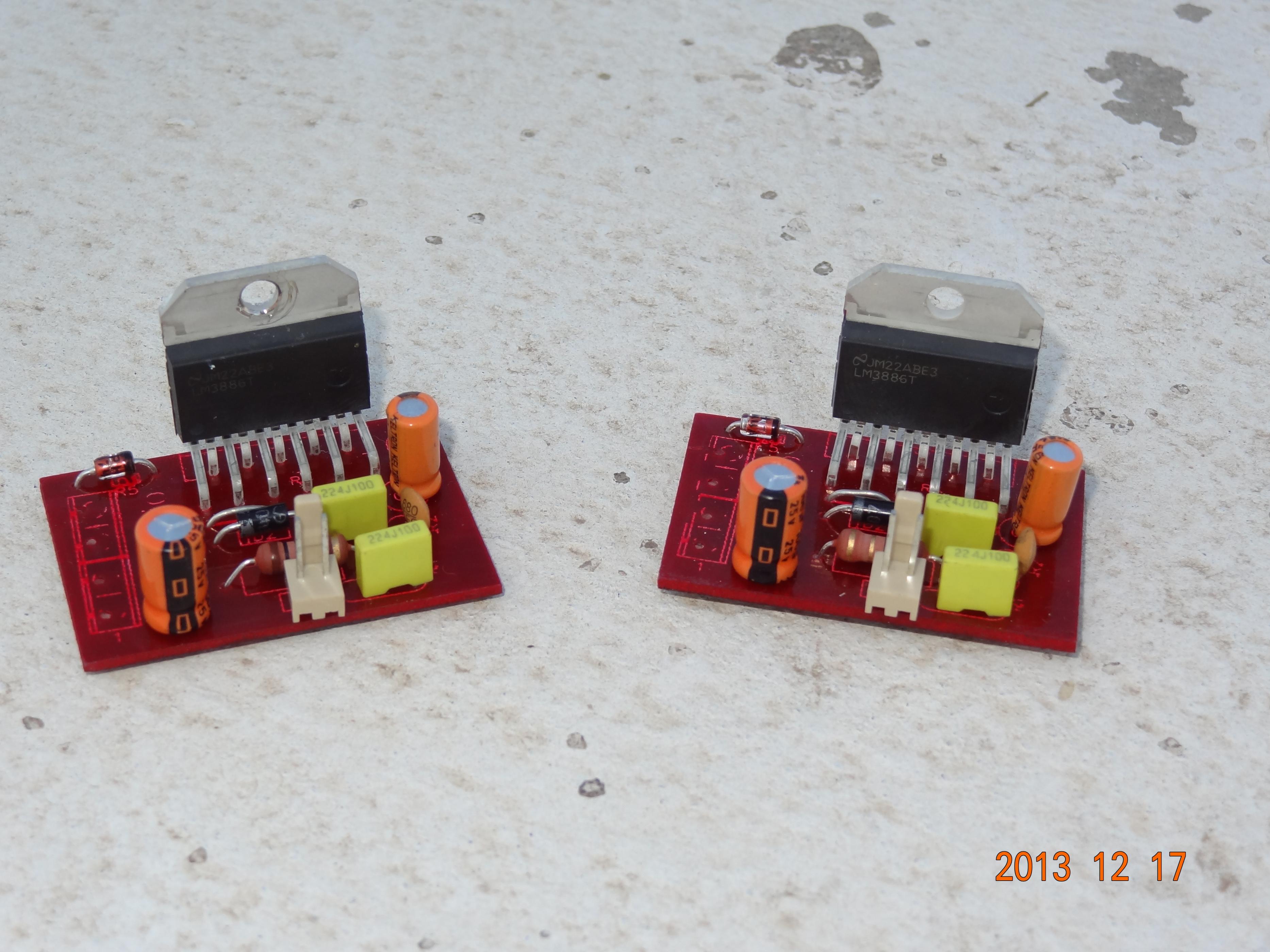

Nice pcb! Even nicer being on a single side (I haven't quite cracked etching my own double sided boards yet)
Can I ask what the gain is in this circuit?
Also, is this your own design or is it based on the Lm3886 reference circuit on the datasheet?
It looks similar,and also simple (which is why i like it ��

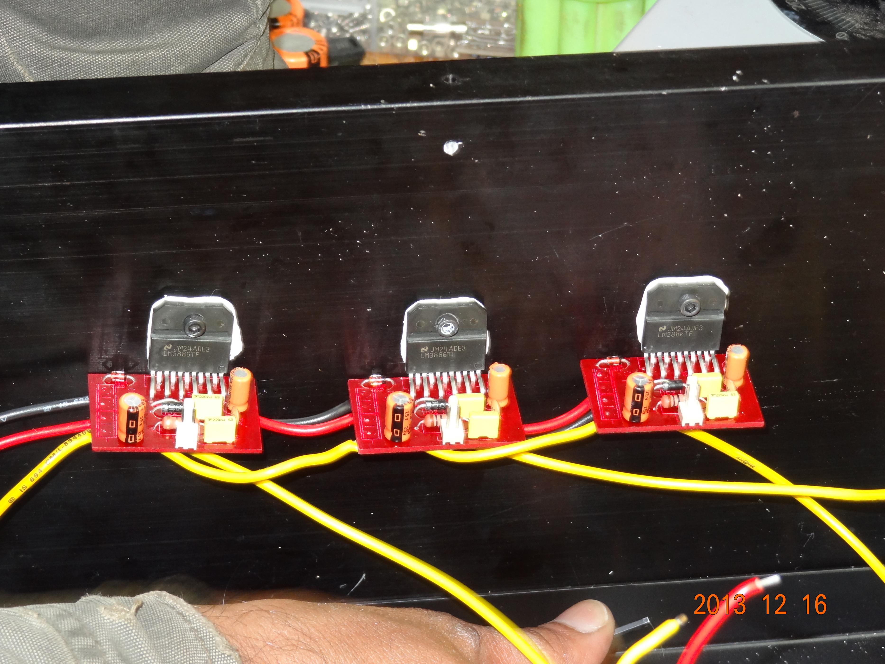

my 2channel LM3886 chip amplifier
Great work! Congrats Shravanth!
It's a pity we can't find good amp cabinet in India easily.
Nice work,my 2channel LM3886 chip amplifier

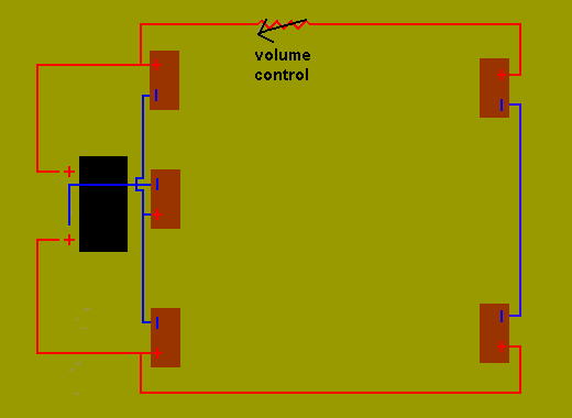

Hi all, I hope this is not off topic here. I have built and used for some time a stereo amp with LM3886 chip. I m using 8ohm full range speakers and wanted to add a third center channel (also 8ohm) to enhance dialogue when watching movies (hafler mode). This can be done by shorting the output negatives into the return of the third speaker and then connecting the positive of the third speaker into the returns of left and right speakers (summed output). I guess this effectively translates in bridging the amp.
I was wondering if this pose a risk with the LM3886 because of the reduced impedance or if this can be easily handled. Also anyone can tell me what would be in this the actual load that the amp would see?

Thanks for the info udaley, I am aware of the hafler matrix and surround effect by adding the "differential signal" to rear speakers wired in series out of phase. What I was trying to accomplish was to add a center channel that narrows the field for dialogue when watching movies. I have seen this accomplished by a summed left and right signal into the third center channel speaker in the way it was described in the schematic that I have attached. It is a sort of an extension to the hafler matrix. I know it works, what I do not know is if the LM3886 amp tolerates shorting the negative outs or what the impact is in terms of load for the amp.
The way You have drawn that diagram, it won't work.
You have both terminals of the speaker connected to the (common?) ground. There will be nothing more than silence.
You need to put the center speaker between the positive of each amplifier.

So you would need to sum the left and right input signals and use the sum as the input to another amplifier.
