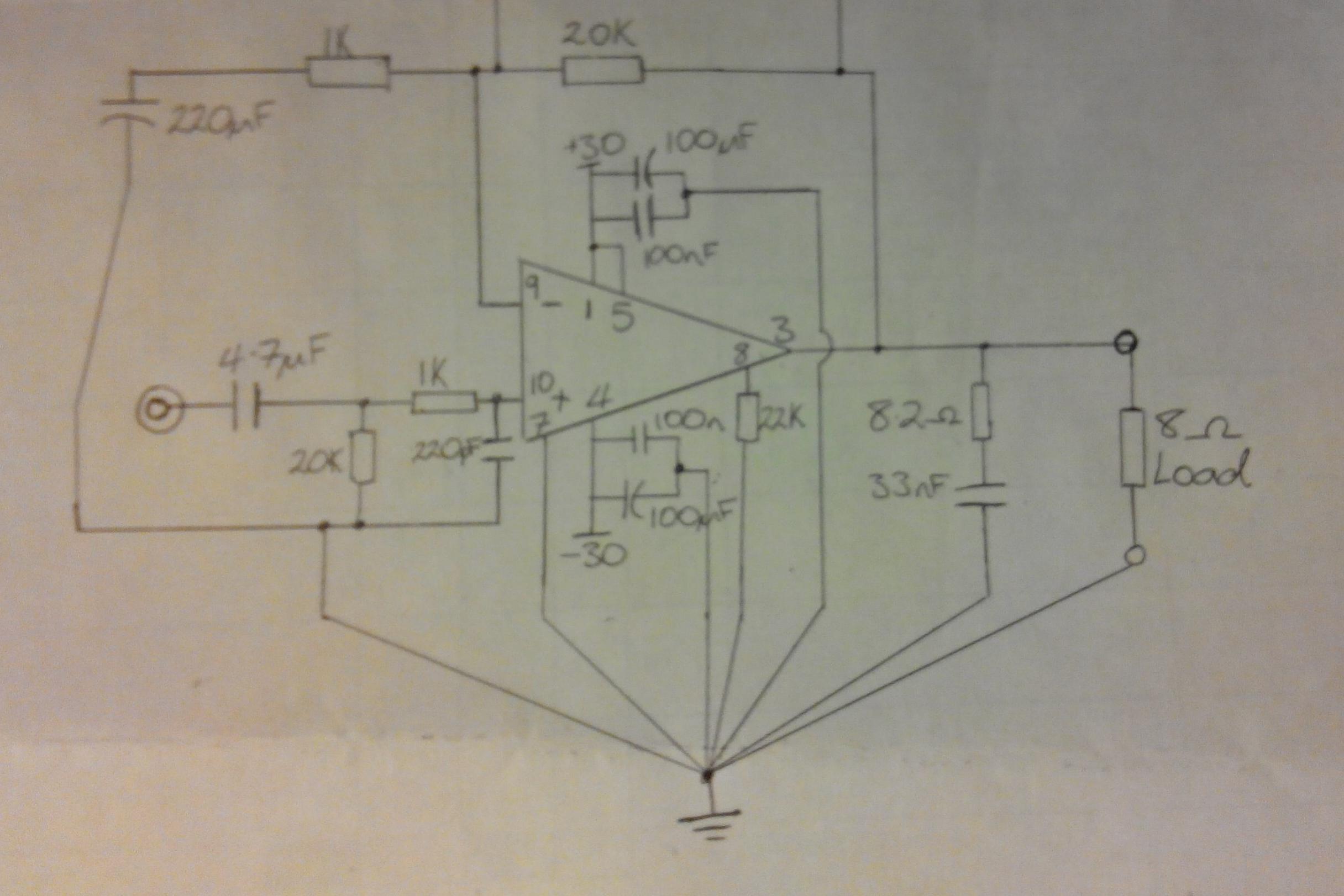

Another LM3886 schematic with data
I have some data I can add to the discussion. I built the circuit based on my past experiences with the chip and used the grounding scheme of "IN+FB Long GND" from post #30.

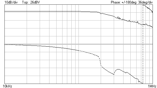

All data was recorded with the amplifier connected to an 8ohm dummy load and at 10V peak.
The amp is connected to a +/- 30V regulated supply.
Pic 1 - basic circuit
Pic 2 - Bode plot from 10kHz - 1MHz

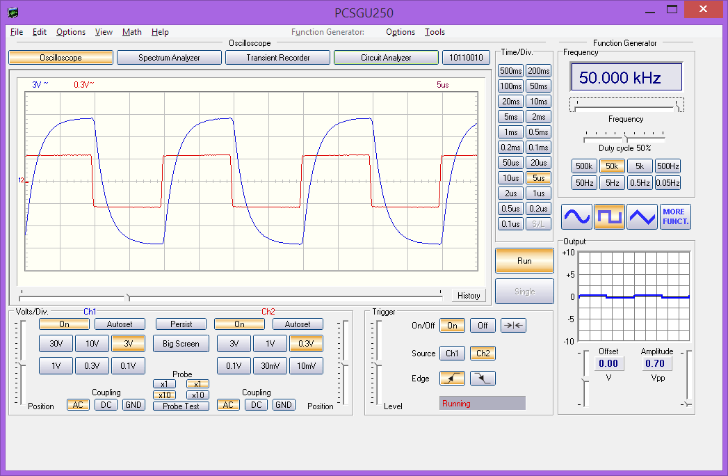

Pic 3 - 50kHz Square wave response

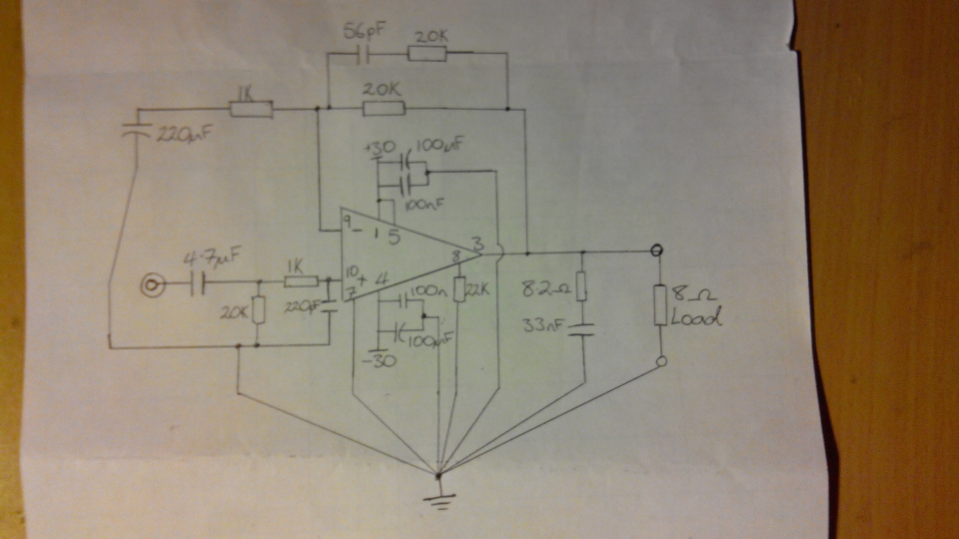

Pic 4 - Circuit with compensation added

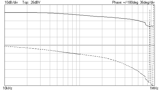

Pic 5 - Bode plot of updated circuit. 10kHz - 1MHz

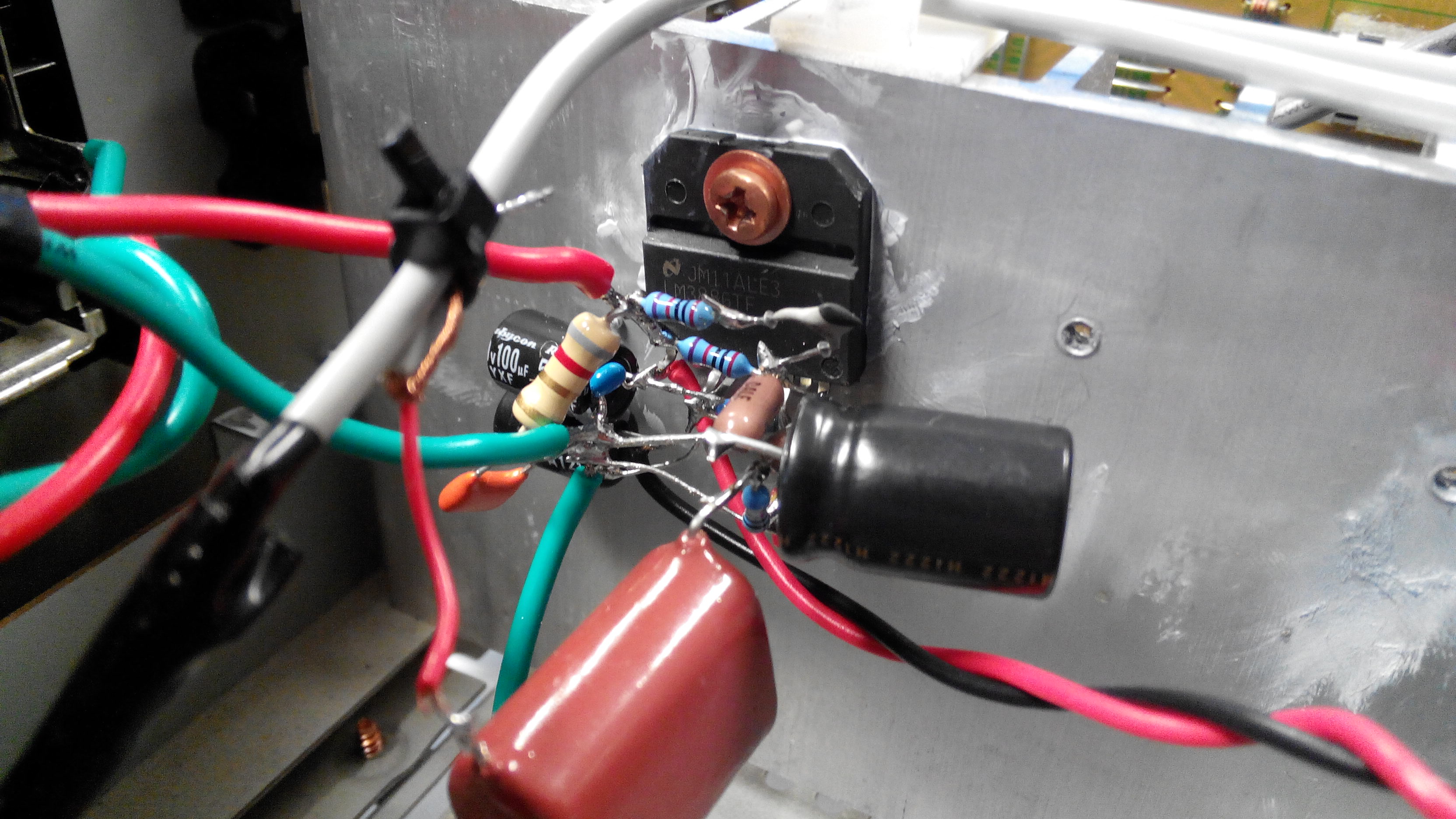

Pic 7 - photo of the circuit.

Maybe test it with all the optional components removed. Some of the phase shift could be caused by the filters at the input.
Oliphant, your pictures show overshoot on the negative going squarewave without your added compensation. I think if you went with the recommended zobel you would not need your added compensation. I believe Tomchrs so called instability with the "right" zobel is actually heating in the zobel resistor caused by square wave testing at high frequency and amplitude.

Testing with 50kHz square while the zobel is set to 60kHz?
Shouldn't it be set lot higher? Or totally removed?
A Zobel of 8r2 & 33nF is F-3dB @ 588kHz
Instability is caused by poor phase margin or poor gain margin. This relates to the amount of open loop gain in the forward path and the gain (or in most cases, rather, attenuation) in the feedback path. Note that the inductance in the output trace and the Zobel network play in here. Lout, Cload form a 2nd order filter in the feedback loop and the Zobel network a zero.
The source of any marginal stability I saw was excessive inductance (long leads) in the Zobel network. Once that was corrected, I had no stability issues at all.
Heating of the Zobel resistor will not cause instability as long as the resistance remains within spec (i.e. as long as the resistor doesn't emit smoke).
