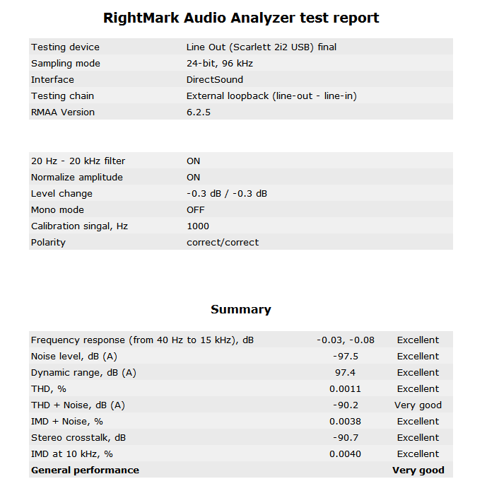

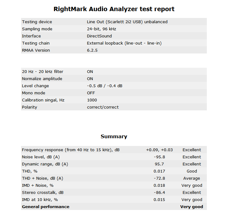

Hi Tony that looks pretty nice. what software are you running? I guess getting some measurement software is key, which then determines the interface hardware / sound card requirements. yes I think balanced interfaces are necessary will look into that some more
yes Tom was right. Holmimpulse and ARTA. I just used ARTA in free mode. I've also tried audiotester (in trial mode) and it seems very good. I do use RMAA as well. RMAA sumary for balanced and unbalanced mode attached. I think if I can make a decent balanced to unbalanced converter I will be able to use it quite effectively for amp testing 🙂 I'm unsure why the THD+N on the balanced is a bit low, some more experimenting probably needed.

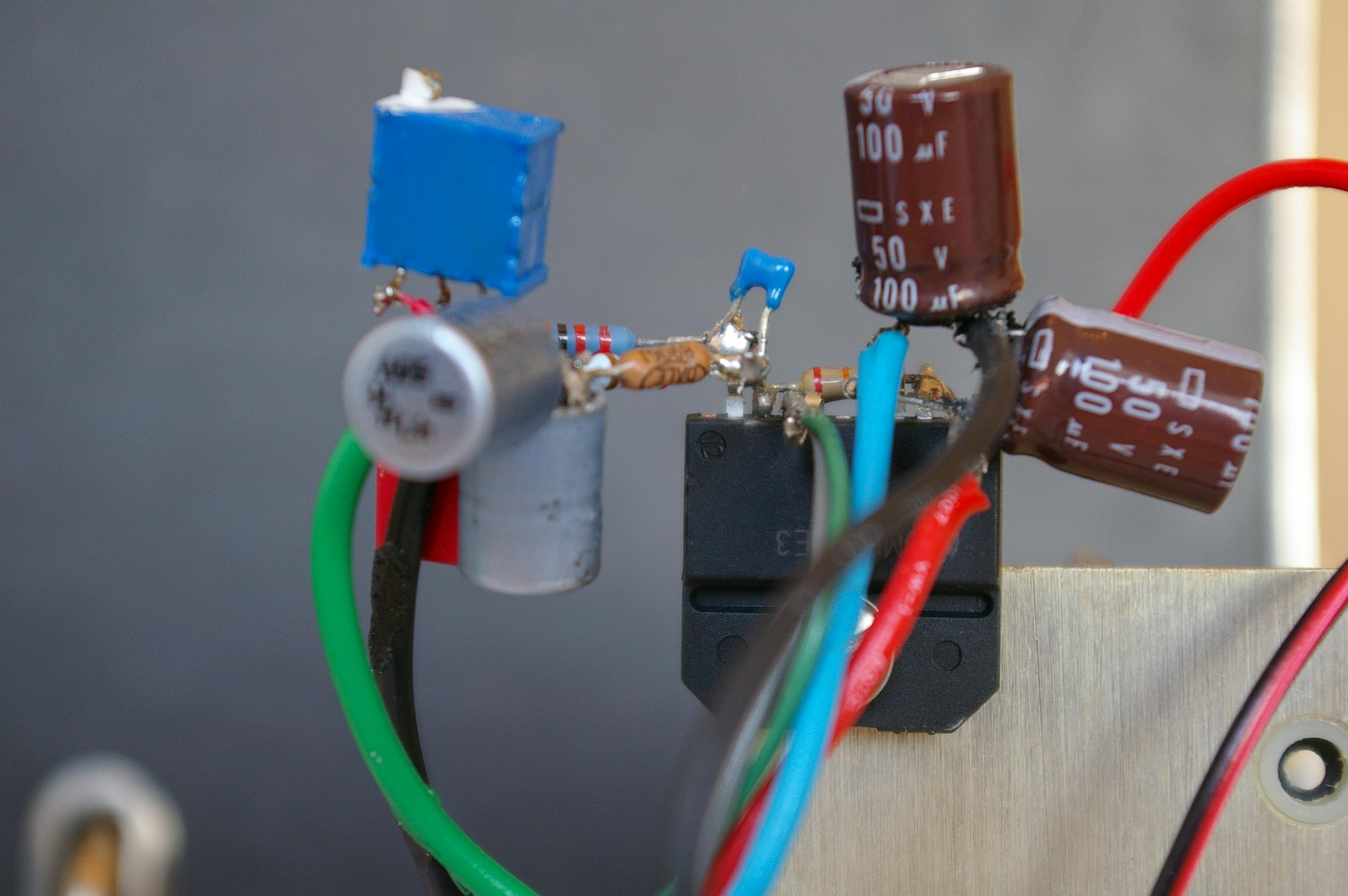

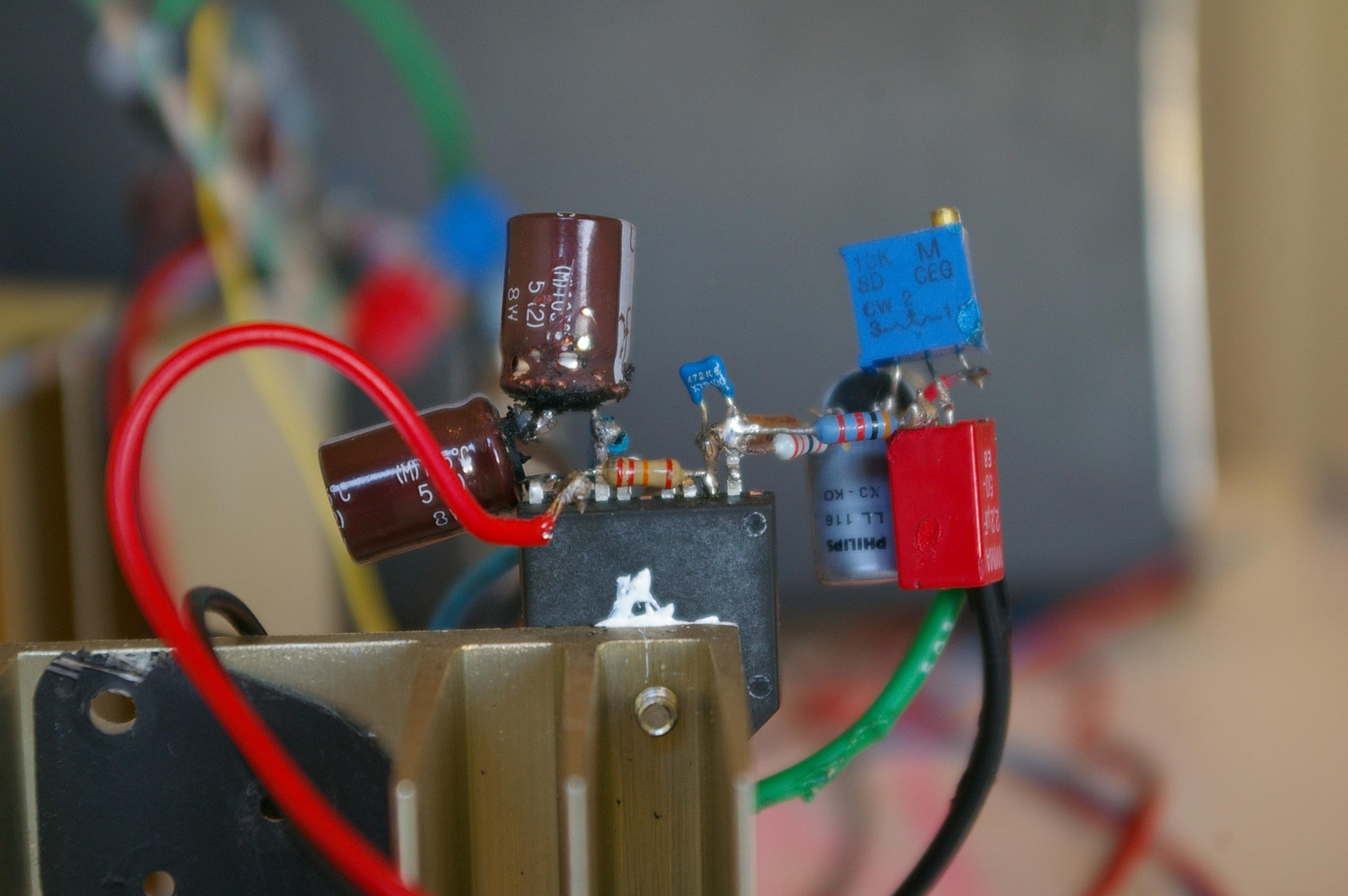

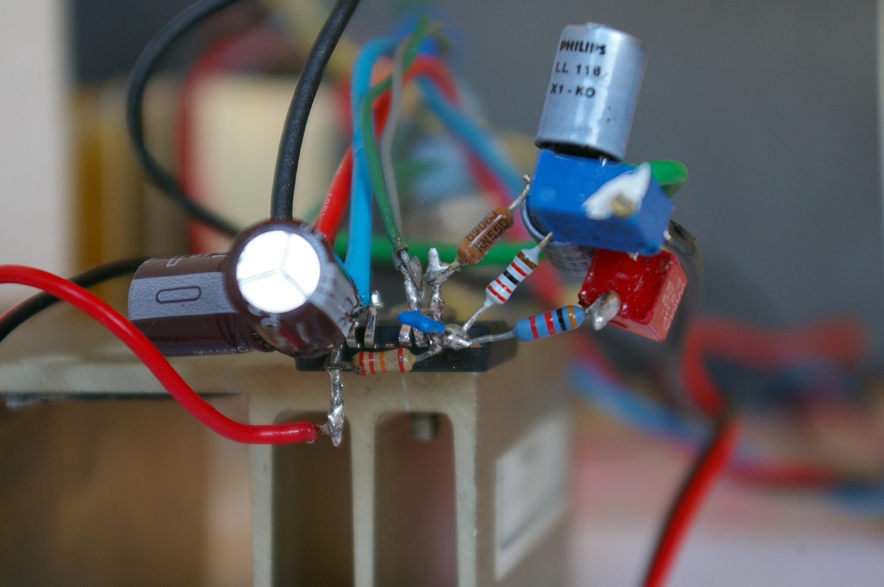

OK after going back over the posts again, It is starting to make more sense 🙂 Tom, Mark and aparatusonitus I think I get it now. Making any changes to this chipamp is going to be difficult because of the tight construction, but I could probably link the various points back to the decoupling caps common point (pic attached) and then run from their back to the PS. This would seem to be the most sensible approach based on everyone input (and the limitations of my build). I would probably (at least initially) leave the speaker returns where they are as that will be more difficult to manage, but I could probably manage to put them back to the decoupling caps star point as well. Something feels wrong about that but I get the point about loop area 🙂 Perhaps a short length from the star point to a second star with just the speaker return, and then the long haul back to the PS...
Picture attached with star point arrowed. Unfortunately not likely to get any attention any time soon (and I would like to have decent measuring capability before I embark on any changes so I can do before and after comparisons) but I will look at this at some point 🙂

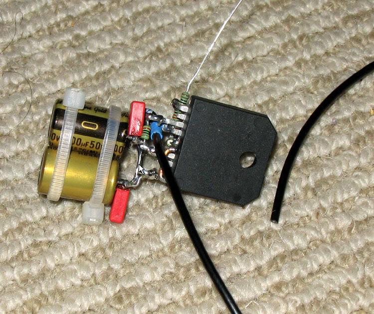

Move red wimas HF decoupling caps as close as possible to chip psu pins, the other ends of wimas form the amp power ground point where your signal (input, feedback) have to be referenced via separated wire. Don't make a power ground point a big surface area, it should be a point!
The 2 EURO GAINCLONE.
Not exactly to my schematic, you can see the speaker return and PSU return connected to the caps. this is the star 0V (ground). Its been rebuild a few times.

2 Mark & Tony,
If you haven't already done so, input and feedback resistors/capacitors network must be as close as possible to -In/+In pins. Also, use a non-inductive, 1W resistor for the Rf feedback resistor, gain seting resistor Rg can be of 1/4W power rating.
Even with 42 V rails, there's no need for a 1 W feedback resistor - unless you go really low on the feedback impedances.
Rf = 10 kOhm would give you 90 mW of power dissipation for rail-to-rail operation using +/-42 V rails. A 250 mW rated or 0.4~0.5 W resistor would work just fine. The thermals on the LM3886 would be a much, much bigger challenge than those on the resistor.
The critical part in the feedback network is the inductance from Vout to IN(-). I demonstrated that quite clearly in This Thread (Post #66). That's also mentioned in the datasheet. The parasitic inductance from IN(-) to ground through the outher resistor is less critical. Inductance between Vout and the feedback tap-off point sets up a complex pole pair (bad news for stability) with the load capacitance, hence, the output parasitics need to be minimized. Basically, Lout and Cload gives you a second order LC filter "for free".
~Tom
Um... This is obviously a prototype, not the final circuit, but in order for that heat sink to do anything at all, the back of the entire IC package needs to make good thermal contact.
Just saying... Thermals are important with the LM3886.
~Tom
