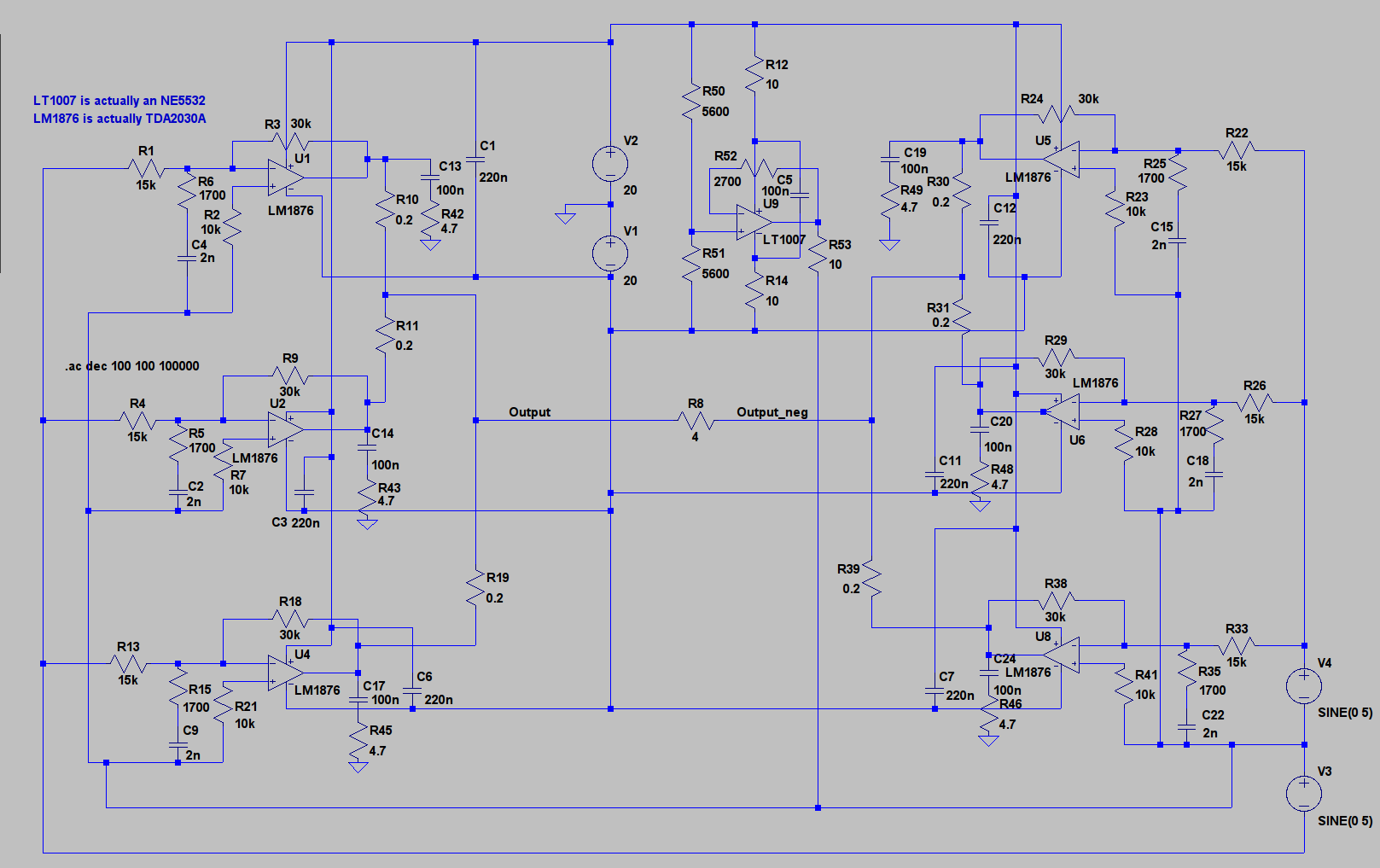

I'll post up a schematic soon as I have an 8 amplifier version I'm playing with. Just need to chop out two devices.
Tribal TDA2030a
Well here's the schematic.
A few caveats:
1) I haven't tested this as a subwoofer amp, only as bass/mid in my digital active system. This means I've not run it into clipping so can't vouch for how well it behaves when over driven. I recommend a soft-clipper (like the one Bob Cordell shows in his new book) to prevent hitting the rails and potential instability.
2) Its set up to give only 6dB of gain, with a balanced input. More on this in my blog shortly. Gain setting resistors (30k, 15k) must be 0.1% matched or better.
3) Its using the amp chips in inverting mode for lowest distortion, with 'gain stealing' to keep them stable with such a low gain. Its DC coupled with low offset because of the low DC gain. The gain stealing components (2n and 1700R) are not optional - this most certainly will oscillate if you omit them.
4) The input signal is floating. A non-floating input would need some attention paying to the grounding as the opamp ground (active supply splitter) won't be able to cope.

Yes, more efficient into the load we're contemplating (4R) than the two LM3886s I ran the calculations for.

No, I meant less power wasted overall, when listening to music. In fact, if measured at identical output power from the same voltage power supplies, the TDA2030a solution would be less efficient overall as there are 6 chips drawing quiescent (32mA each, measured cold) versus 2 chips drawing 50mA each (from the datasheet). The TDA solution is more efficient overall at turning mains electricity into sound overall, for music signals.
If so, how much more efficient are they?
Hard to say, given that the TDA2030a datasheet is fairly sparse and it depends on the music being listened to. I've estimated that the saturation voltage is going to be around 3.6V into the 6R load, compared to 5V into 2R for the LM3886. The upshot is the TDA solution will play a bit louder for the same input power because less will be going into the heatsink at higher levels.
And is that valid for all output power levels from 0 to 100 %?
No, its not valid at the lower power levels because of the higher quiescent. If you're keeping the volume down low all the time then the LM3886 solution is going to be better from the pov of efficiency. It remains a considerably more expensive solution though.
That means the TDA may achieve a 1,4 V higher output swing, not that the resulting higher power output comes for free.
I don't see higher efficiency at any power level. Power dissipation is voltage drop x (output current + quiescent current). Voltage drop and output current are the same for any given output power and the quiescent current of 6 TDAs will always be higher than that of 2 LMs, not only at low power levels.
That's all correct, but doesn't change the result - the TDA solution is more efficient in practice. If you believe otherwise, then do show why. After all, I haven't done the detailed calculations myself so I could be wrong here. Have you done them? If you show me I'm wrong I'll take back my claim that its more efficient. I'll still recommend that solution though because its cheaper (in silicon and, I reckon in aluminium too) and likely to be lower distortion.

The flaw in posts #12 and #13 seems to have gone unnoticed so far. BTL into the same load will of course give four times the output power, not only twice. You could expect 128 W into 4 Ohm from a BTL amp with those SMPS. Good news for you?

I was already thinking in that direction.but didn't dare to make that statement here. Logically when 4 Ohms is connected in BTL mode then each half bridge sees it as a 2 Ohms which makes Wattage 2X and the same is the same thing happens at the other half bridge. so the total power is 4X.
Correct if my simple logic is wrong.
