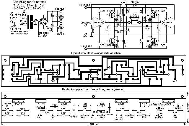

I was already thinking in that direction.but didn't dare to make that statement here. Logically when 4 Ohms is connected in BTL mode then each half bridge sees it as a 2 Ohms which makes Wattage 2X and the same is the same thing happens at the other half bridge. so the total power is 4X.
Correct if my simple logic is wrong.
Yes, but only if the output stage can deliver the necessary current and the power supply can support that. In practice, you will rarely see 4X, perhaps something more like 3X.
Another way to think about it is in terms of voltage swing. You get twice the voltage swing across the load when bridged, and since P = U I, and I = U / R, then P = U^2 / R. So if the voltage swing doubles, the power delivered to the load quadruples. But the current also doubles, and it needs to go through both ends of the bridge, so each amp needs to support twice the current for the same voltage, which is equivalent to dropping the load impedance by half.
yes, I agree, I mean the ideal BTL amp & ideal Supply. ( just for understanding of concept).
