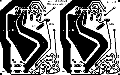

carlosfm said:
I meant the voltage drop on the chip's pins, on the amp.
On an unregulated PSU that is modulated with the music, depending on how much current the amp is asking from the PSU.
I understood what you meant, I was just trying to say that to achieve a sag free PSU, we have to add a regulator that permanently drops, in this case 8 volts. The power used by the regulator is not avaliable to the amp. That's all. :xeye:
i think logically, less regulated power is better than more but sagging power.
also, chips have a voltage limit, so if you like listening to them at say 32 volts, use a 40V trafo regulated down to 32. so in this case, yes those extra 8 volts are not available, but you dont want them to be anyway.
but i see what you mean if you are using the same trafo for both situations.

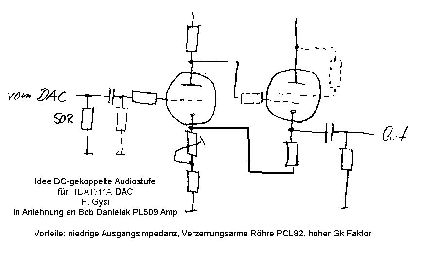

... I am planning and building my external DAC, with tube (sorry, valve) output stage, based on a CS8412 and a TDA1541A
This is the idea about the audio stage:
cheap but very good PCL82, voltage gain with the triode part of it, DC-coupled to a cathode follower, the pentode part, to reduce the output Z.
carlosfm said:
If you have the time for that, be my guest.
I have no time for this, sorry.
The snubber in your configuration does little to cure a possibly non-existent PSRR problem.
Better to put the 1 ohm resistor IN SERIES with the power supply pins, and use a 100nF/10uF immediately adjacent to Vdd/Vss.
Better still, put a ferrite bead on each power supply pin -- and save the watts for the music.
