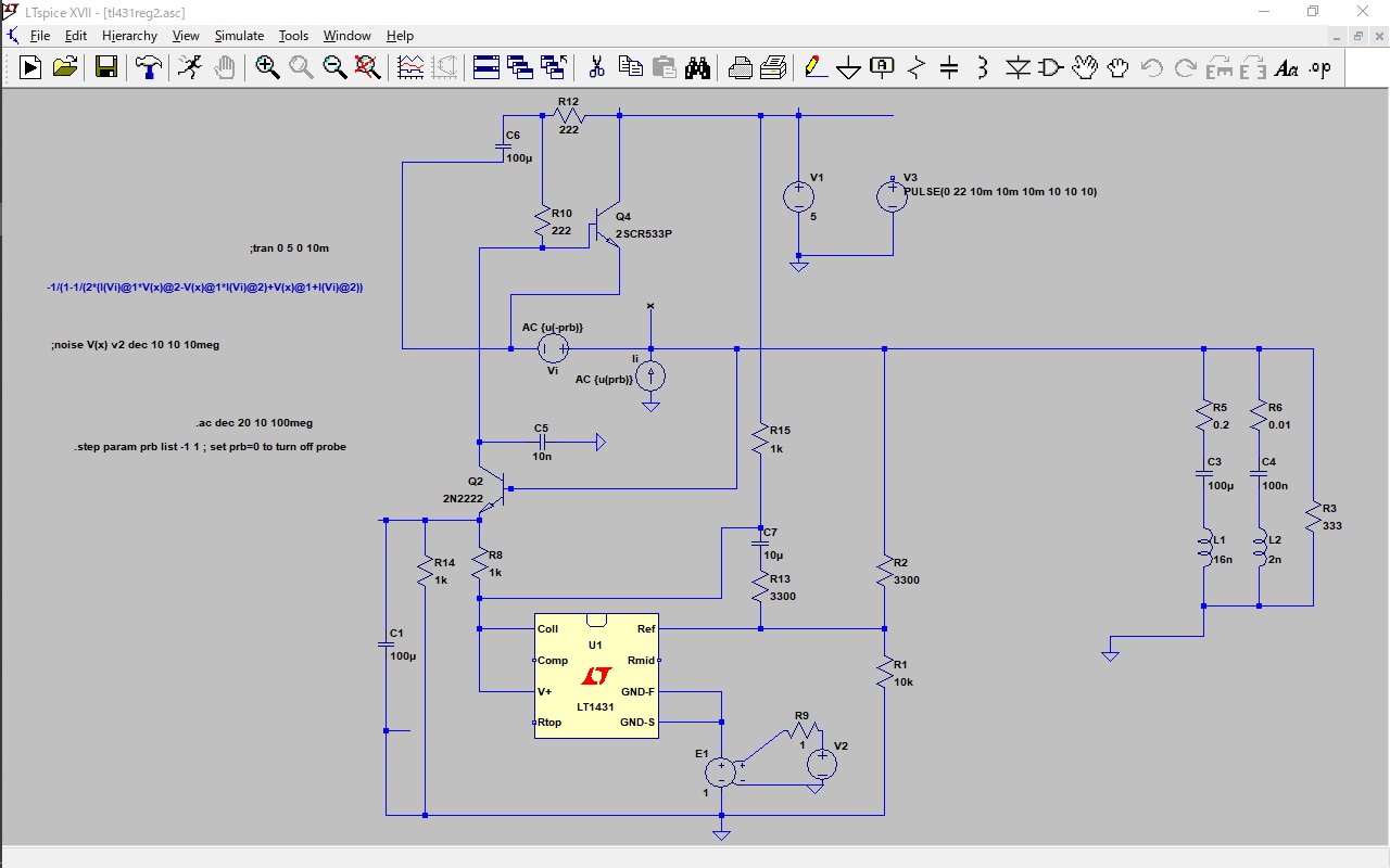

Isn't a TL431 going to be noisier than a low-voltage zener? Maybe reducing noise is more desirable than a low dynamic impedance, given that by the operation of the LM317 its operating as a CCS from its Adj pin and any zener is already going to have an order of magnitude lower dynamic impedance than a resistor hanging from Adj.

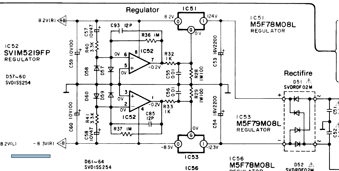

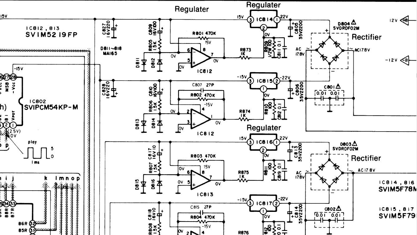

you might be interested in technics regulators too:
_
In this Technics regulators, I see the same trick used in the Elvee' s Denoisetor:
Sense the noise at the output, amplify then inject at the Adjust pin of the regulator.
I don't understand the -0.2V at the op amps outputs. Why not 0 ? and there is 0V marked at the regulator' s adjust pins.
Must be the offset from Ibias. I had not found which op amp is used.I have no idea...it might be some offset and there's 3ua bias current over 1megohm resistor for m5219 anyway...here's a different better version that has some mistakes in it:
Last schematic looks the same, but with no offset, could that be, they use a JFET input op amp here. 27pF compensation caps are missing.

Yes, TL431 is noisier than low voltage low noise zener diodes. TL431 is 120 nV/√ over 1KHz, 220nV/√ at 10Hz. Zener diodes widely depends, asking for a careful selection to make sure about a lower noise.

the op-amp is the same, probably the panasonic version of mitsubishi m5219(bipolar, low noise, powerful)/.They just missed some notations here and there.SLP-1000 has 470k//27pf, slp-990 has 1meg//12pf.Obviously the slp-1000 has half the output offset, whatever it may be...I built their regulators with some minor mods , didn't have the time to fire it.Must be the offset from Ibias. I had not found which op amp is used.
M5220 is even better.Both m5219 and 5220 were used in some of the best cassette players as the first playback stage op-amp and as i/v converter in some high end jvc cd-players. There were made especially for phono preamps as they can take max +-25v supply.Unfortunately extinct as many other good things over the time.Every time i get a scraped cassette deck i look for m5220.
