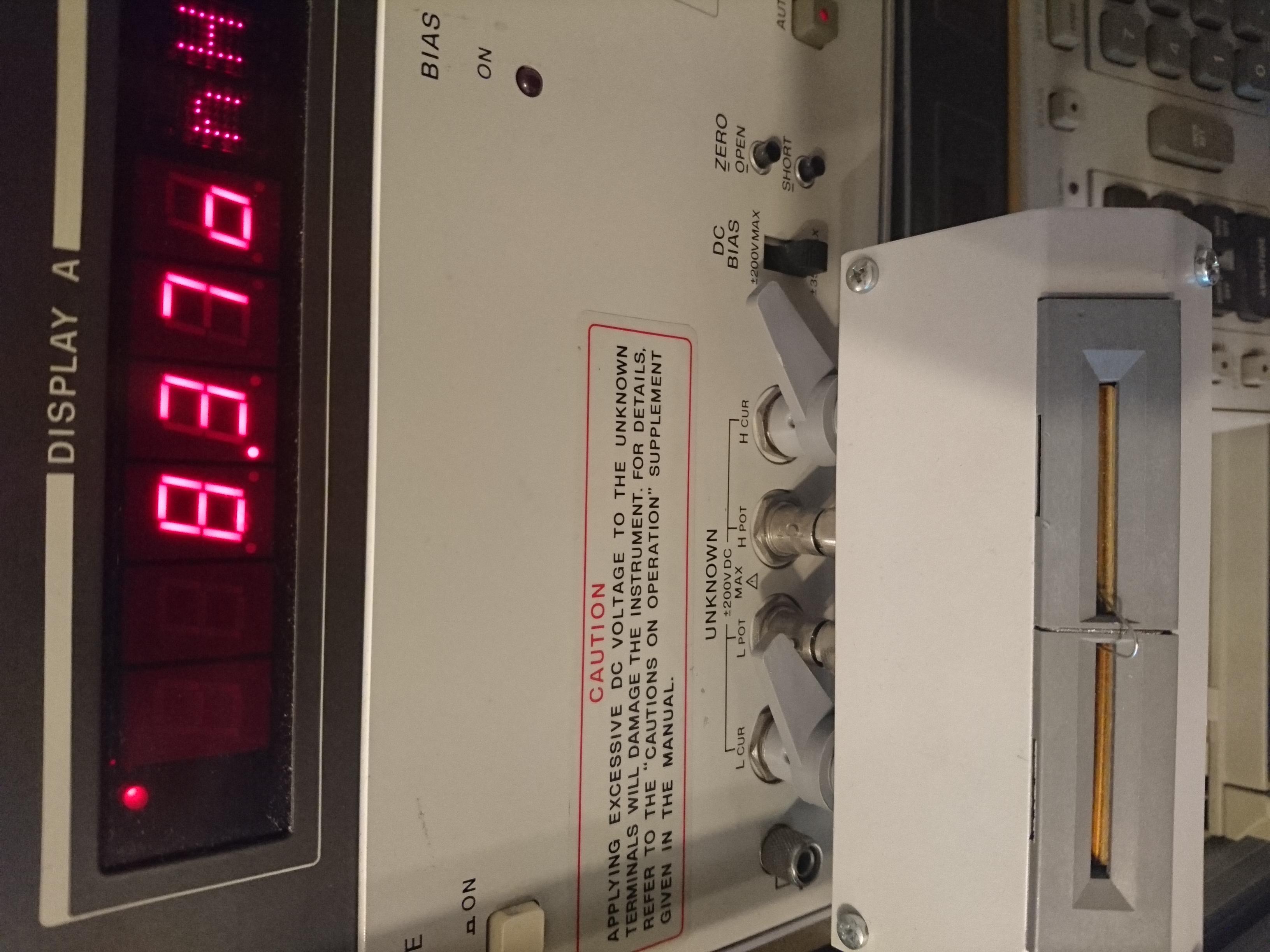

This is the inductance of a really small hair pin:
I pushed the U-loop fully in, zeroed the bridge and pulled the loop out
maybe 3 mm.
As some DEC engineer once said: Each mm has a nH all for itself.

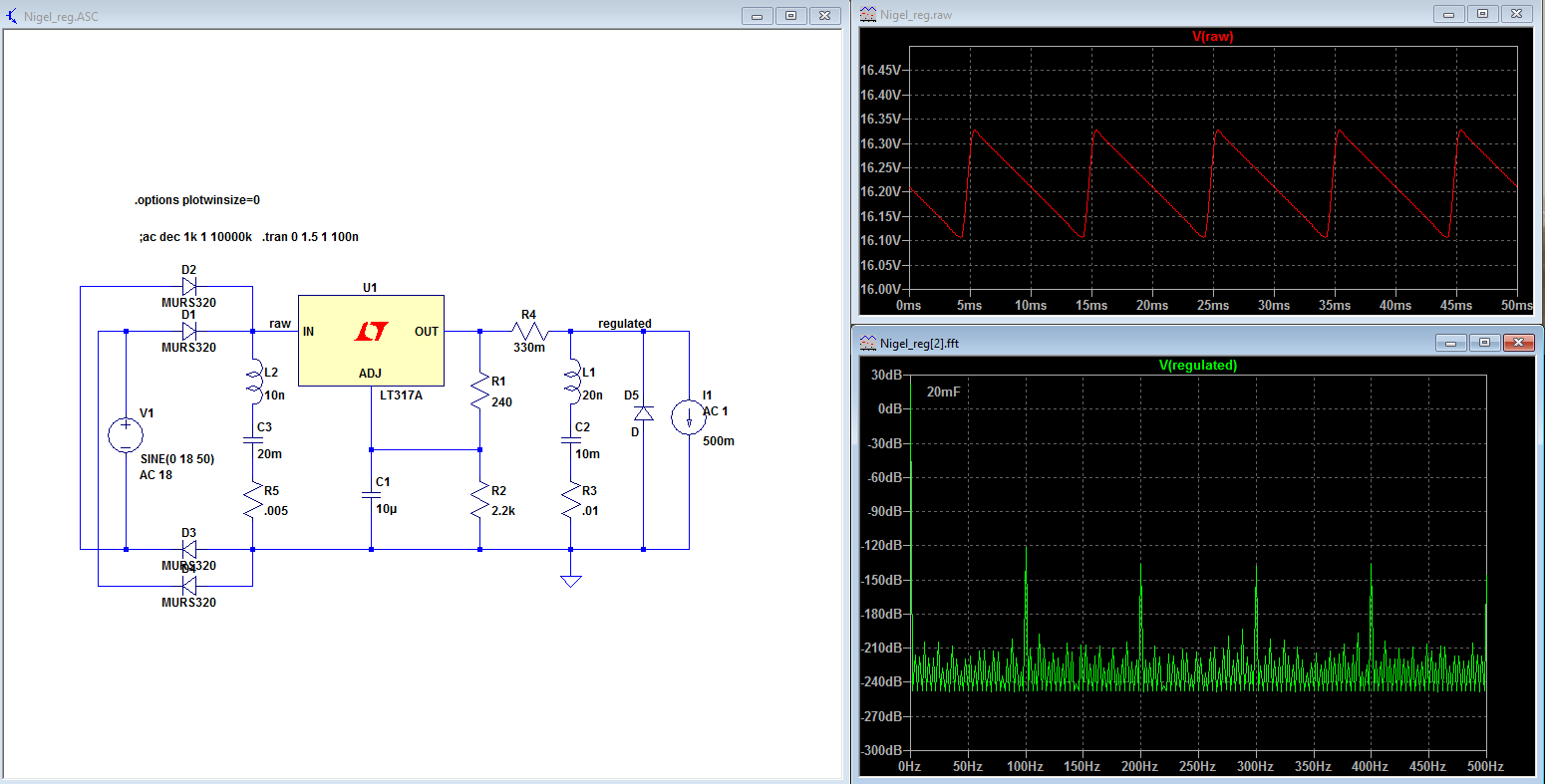

Here's a sim.
40000uF before the regulator. 100Hz is -128dB on the regulated output. Current draw from the LM317 is 500mA.

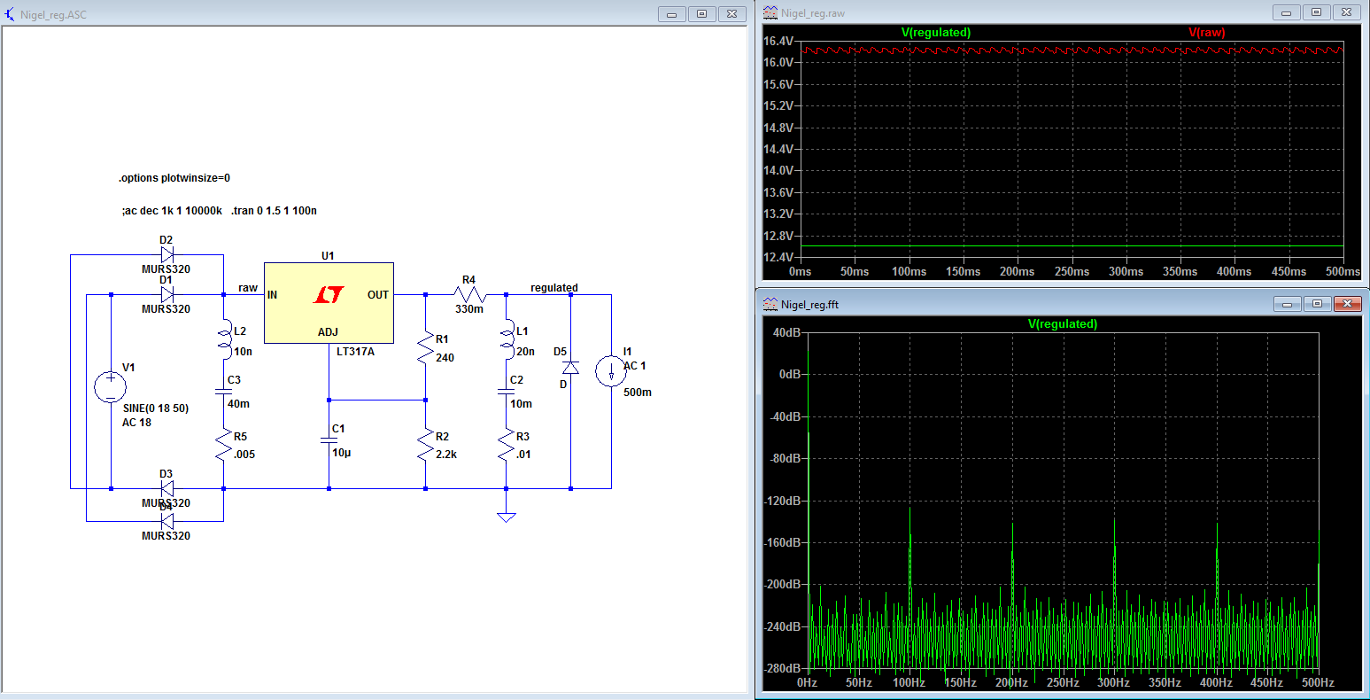

Here's another sim. This time with 20,000uF before the regulator.
100Hz is now about -120dB.
