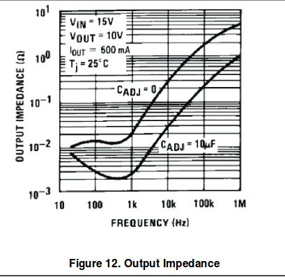

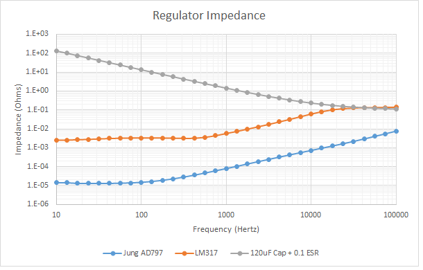

Take the impedance of what ever capacitor you want and overlay it on a graph of the regulator's output impedance.
a la:

IMO The output impedance should correlate exactly with loop gain and the pass transistors Re. The frequency break point is adj pin capacitor Xc = gain setting resistor.
LM317s aren't all created equal, most vendor's don't change or update the specs to reflect their processes esp the ones going aiming for market share (why rock the boat). In TI's case they couldn't even copy the data sheets correctly.

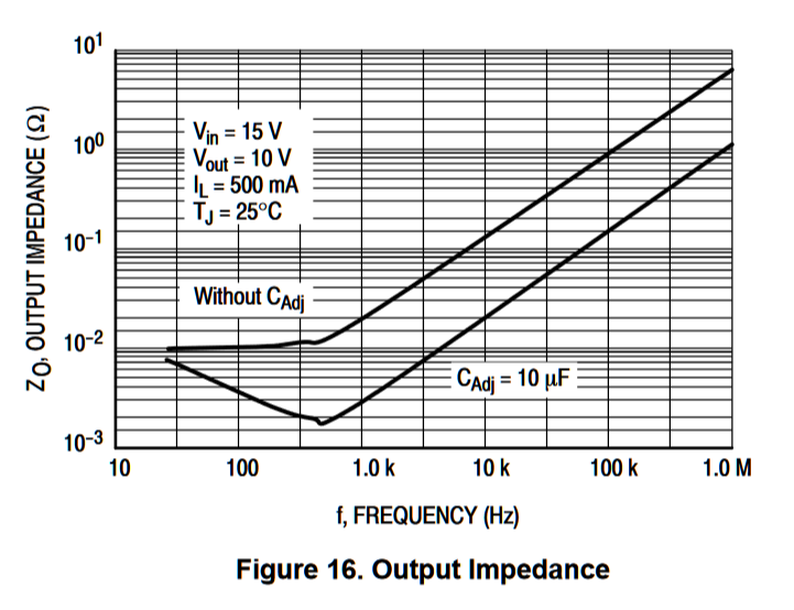

Here's one from TI:
Did you know that TI had that chart reversed for years, I hectored them into changing it.
Zout is inversely related to current drawn, so I would be disappointed if a TI LM317 had higher Zout @500mA than a Fairchild LM317 @140mA.
The load in all the tests was that used by Walt in his 1995 article, and the charts for LR, Noise and Zout correspond quite closely. So quod erat etc as the Romans used to say.
