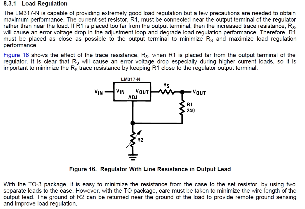

Note that the quote earlier (post71) stated that performance dropped by a factor exceeding 10times when 0r05 ohms was allowed between the sense point and the regulator output. It's the length of the output lead that affects this loss of performance.

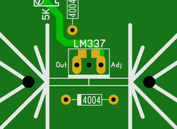

Just go out the back of the pad with the sense resistor trace (the sense resistor can be located anywhere then), and shove the 317 leads all the way in to the pads (which will mean a larger pad hole to suit the widened lead near the package). Move the output cap as close to the device/heatsink as practical. That will give you text book performance.Yes an SMD resistor directly on the pads between the pins would be another good option Andrew!

Just solder the smd direct to the lead outs. Not to the PCB.
Unfortunately the 337 (-ve reg) has these Out/Adj pins at the outside.
In this (-ve) case the smd is soldered direct to the OUT pin and a thin strand of copper from a stranded cable is soldered across to the far away ADJ pin.
A thin piece of insulation from a cat5 to insulate from the IN middle pin.

Just found the same thing Tony has been referring to about the resistor's location in a T.I. datasheet.
A Kelvin-like connection to the regulator's output terminal would minimize this problem.
Use a separate trace (from the opposite side of the output pad, where the top diode is)
to the feedback resistor.
Separate force and sense wires, see https://en.wikipedia.org/wiki/Four-terminal_sensing

Thinking about this some more, why can't you just solder a 1/8W axial lead resistor across the 337's leads(since they're spaced farther apart) and a 1206 across the 317's leads?

The sense point is the location where the voltage sensor taps into the output line. This applies to both the +sense tapping into the +output and to the -sense tapping into the -output. An LM317 has two sense points, one is at "ground/zerovolts" and is the -sense point....................
What exactly is the sense point?
post89 fig 16 shows the two sense points.
+sense is the black DOT at the top of R1.
-sense is the gnd symbol at the bottom of R2.

Guys, see what you think about my idea below of putting a 1206 resistor across the 337's pads. I know now I can always solder the resistors directly across the pins, but I'm not giving up on how to put them directly on the board also.
The 337 required a little more thought since the pins are on each end. So I put the 1206 on top of the board and made the center pad bottom layer only. That way the resistor can't touch or short it out in any way.
