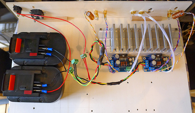

LM1875 P2P "solar powered"
Summer is coming, I would like to listen to music for free in the garden !
So this new amp will be connect with two Li Ion batteries (near 15 volts) and recharged with solar charger.
One LM is missing at home, and for P2P I choose LM1875, and cause I have.
Schematic :
Rz and Cz on output posts, distance about 5 cm between LM.
I will use two heatsinks, maybe cause pin 3 are connected to socket of LM.
I will try to have very short wirings.
Phil.

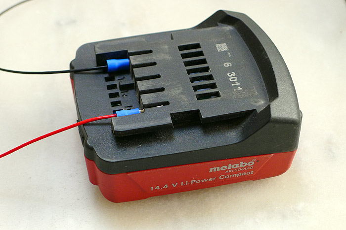

I found a idea for "solar powered", I already have a solar panel (on the roof), a 12v 45Ah bat, Li Ion charger and two bat 14,4 v..

Batteries are connected in serial (+ and - connected for 0 volt), so that give +15 volt, -15 volt and 0 volt at center..
Below, you can see LM3886 amp powered with two 1500 mA (14 volt nicd) batteries, it can works during about 7 hours at low level.
You can see also the wiring power.
Phil.
