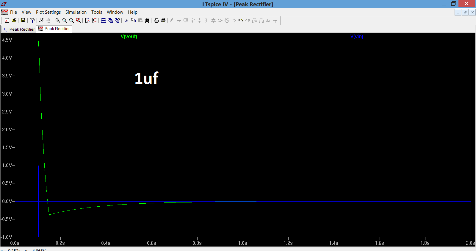

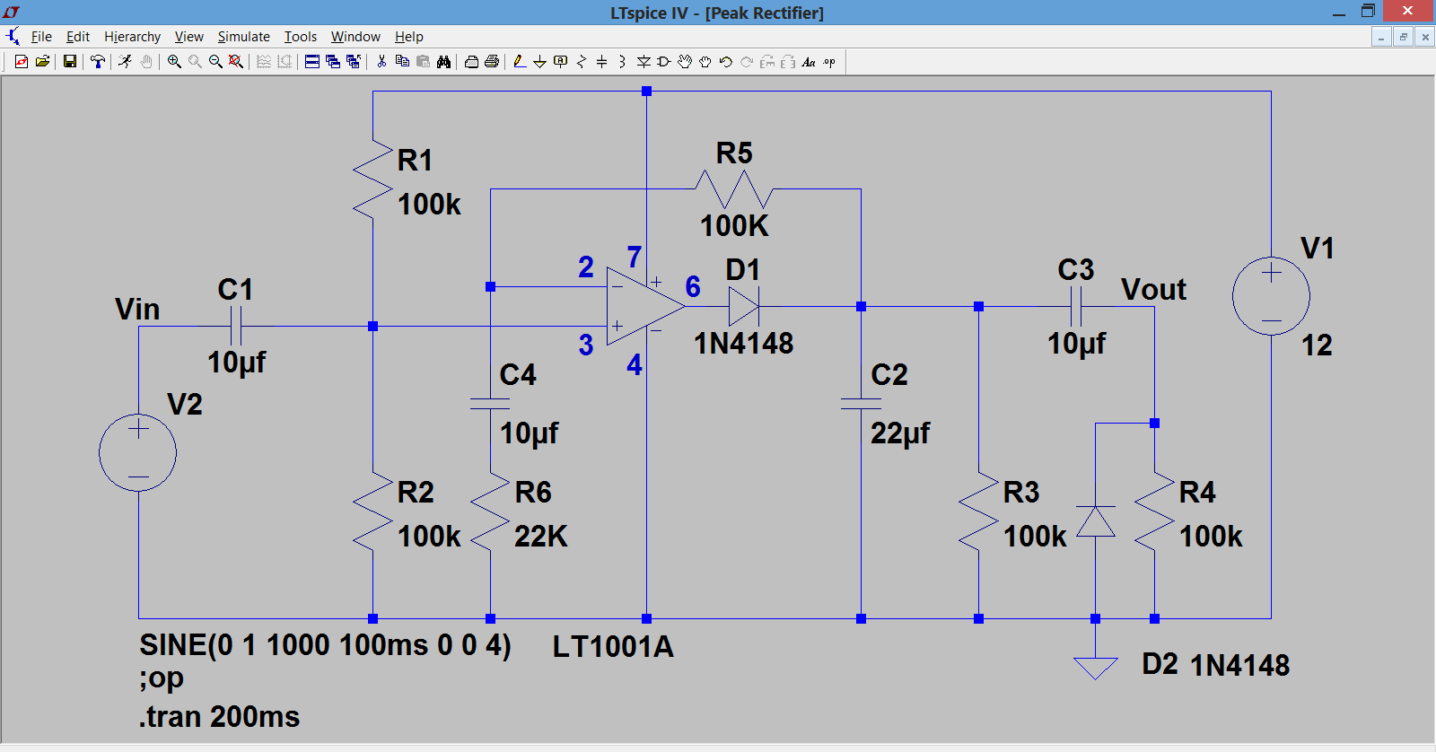

I just tried the circuit in simulation again. Just try altering C2 for a start. It should all work.
(it could be worth adding a 'clamp diode' across R4 as shown here to limit any negative going transients)

Like i have no idea what should happen if i change c2. I have no voltmeter or something.

everything seems fine but i have no idea where to connect C1. The positive in my circuit is connected to pin 3 and negative doesnt connect anywhere.. ;/ so where do i put it?

C1 is the input coupling capacitor. The 'live' audio input comes in at the left side of the cap. The ground of the audio input (the shield on the wire) goes to ground.
The markings on the opamp are confusing you. The + and - are not voltage supplies but the standard designators for the non inverting and inverting inputs. The power supply goes to pin 7 of the opamp (for a 741) and the negative supply to pin 4.

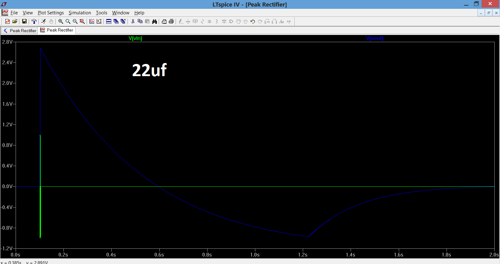

So you need to prove the opamp circuit. The pictures I posted earlier today show the output of the opamp circuit when fed with a just 4 cycles of an input signal. Here it is in detail. 1 volt peak at the input, and that is rectified, amplified and held. You can see the output (green trace) climbs to nearly 2.8 volts and then falls away slowly. This is with a 22uf cap for C2 to hold the voltage for a bit longer.
It should all work if constructed correctly.
