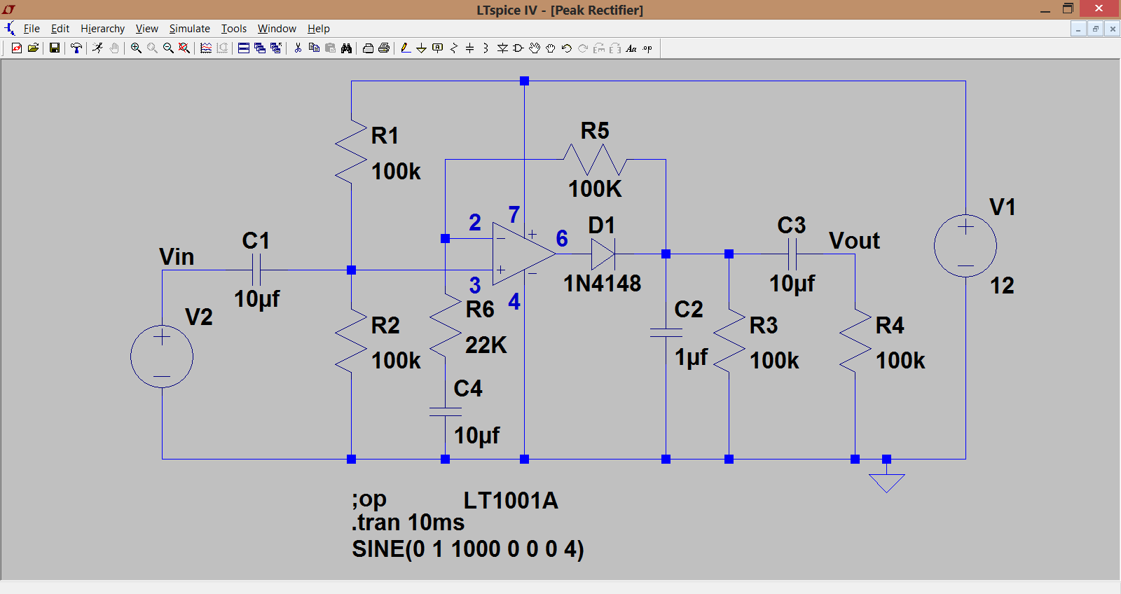

This is what you need. The opamp can be any common type, a 741 or TL071 would be ideal. In order for the device to work correctly on a "single rail" supply we need R1 and R2 to bias the opamp to one half the rail voltage. These resistor can be any value in the 10k to 220k range as long as both are equal. The audio comes in at the left via the coupling cap C1 (positive end of cap to the opamp for all the caps in these circuits). The diode can be any silicon diode such as a 1N4148. C2 and R3 set the time constant... how long the circuit holds on to the peak voltages. You can experiment with the value of these. The voltage output is AC coupled to the LM3915 via C3. The output is tied or referenced to ground via R4.

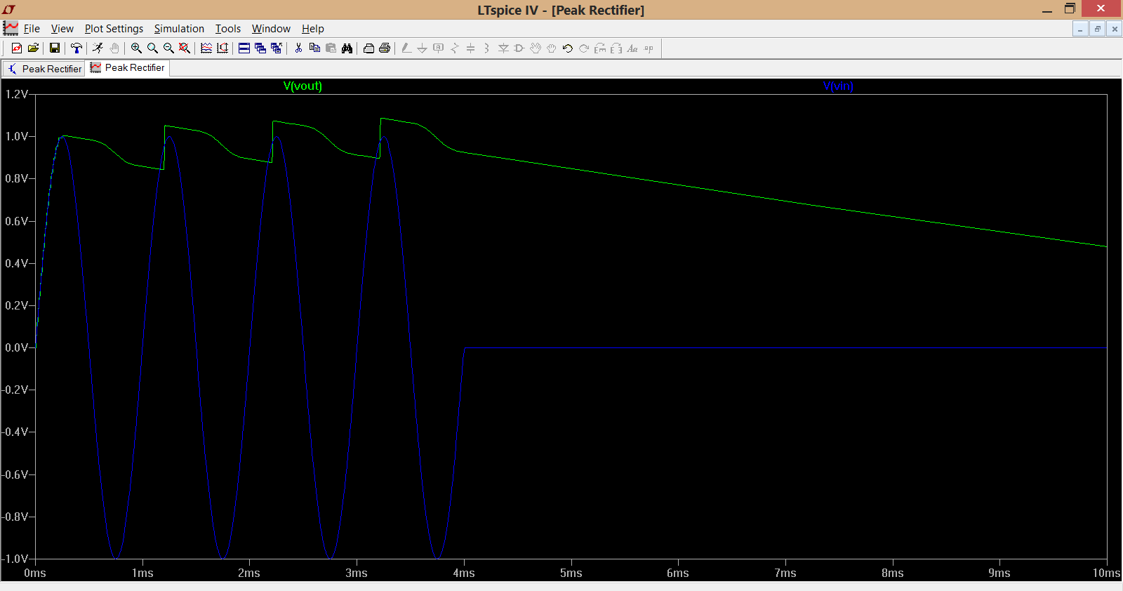

The waveforms show the input signal of just four cycles of a 1kHz sine wave. The green trace shows the voltage at the output. This is what you will apply to the LM3915. Notice how slowly it falls. This means the LED's stay on for longer which is what you want.

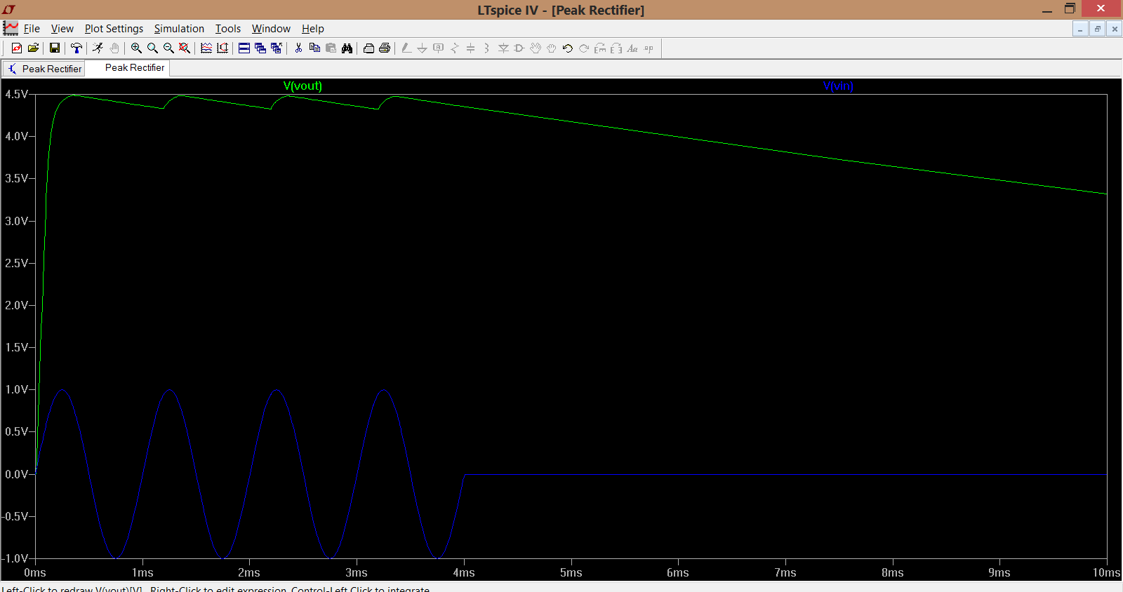

The circuit can altered to give gain by the addition of two resistors and a cap. The approximate gain is given by (R5+R6)/R6 and so we have a gain of 5.5. Notice the amplitude of the output signal now.

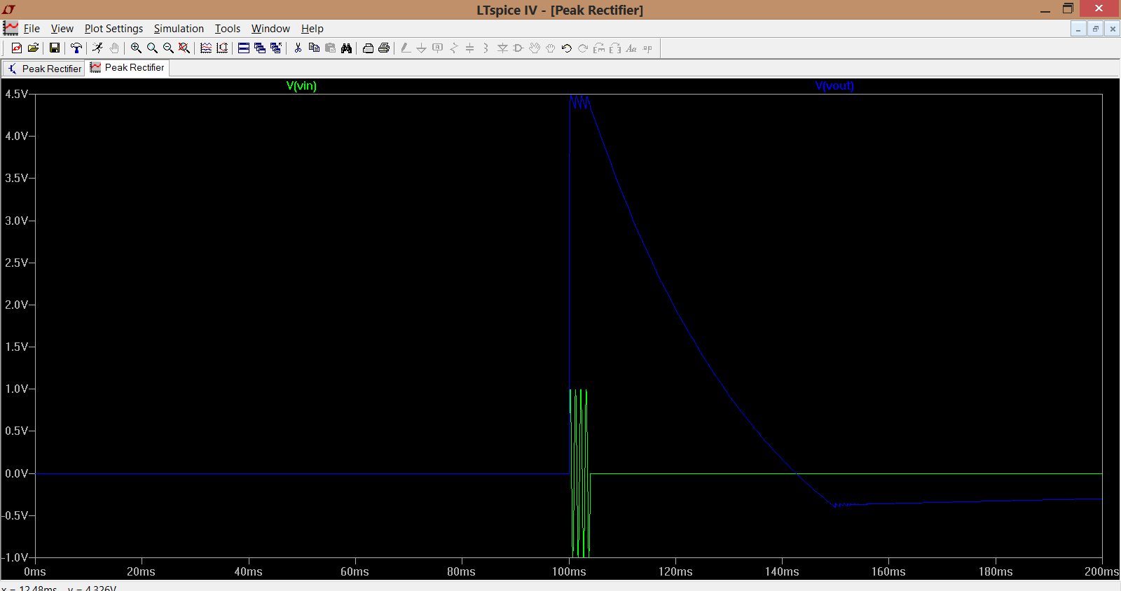

The final image shows it better. Four cycles of the input signal appearing in isolation. Look at the output voltage.

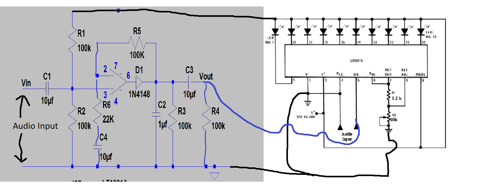

Yo thanks for the help.But i got some questions.. So all this opamp will increase the voltage? I thought i need to increase the current flow not the voltage? And my 2 audio wires connects where shown V in? ground to negative and R or L to the positive? and what do i connect to the right side? Do i have to connect right side to positive and negative rails on my breadoard?
Administrator
Joined 2007
The opamp will increase the voltage if needed by means of the extra resistors as I showed above. You may or may not need that as it depends how much voltage your signal source puts out. Its voltage we need to drive the LM3915.
So the audio connects to Vin at the left. Pin 7 of the opamp goes to main supply feeding the 3915. What are you running it on ? You need at least 9 volts. The output at the right goes to the input pin of the 3915 with the ground being a common throughout.
