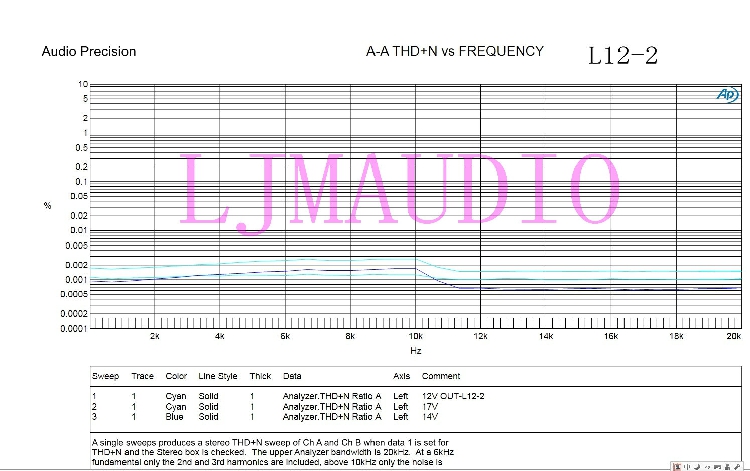

L12-2 smaller Smaller distortion than LME49810
MX50X2 more lasting appeal

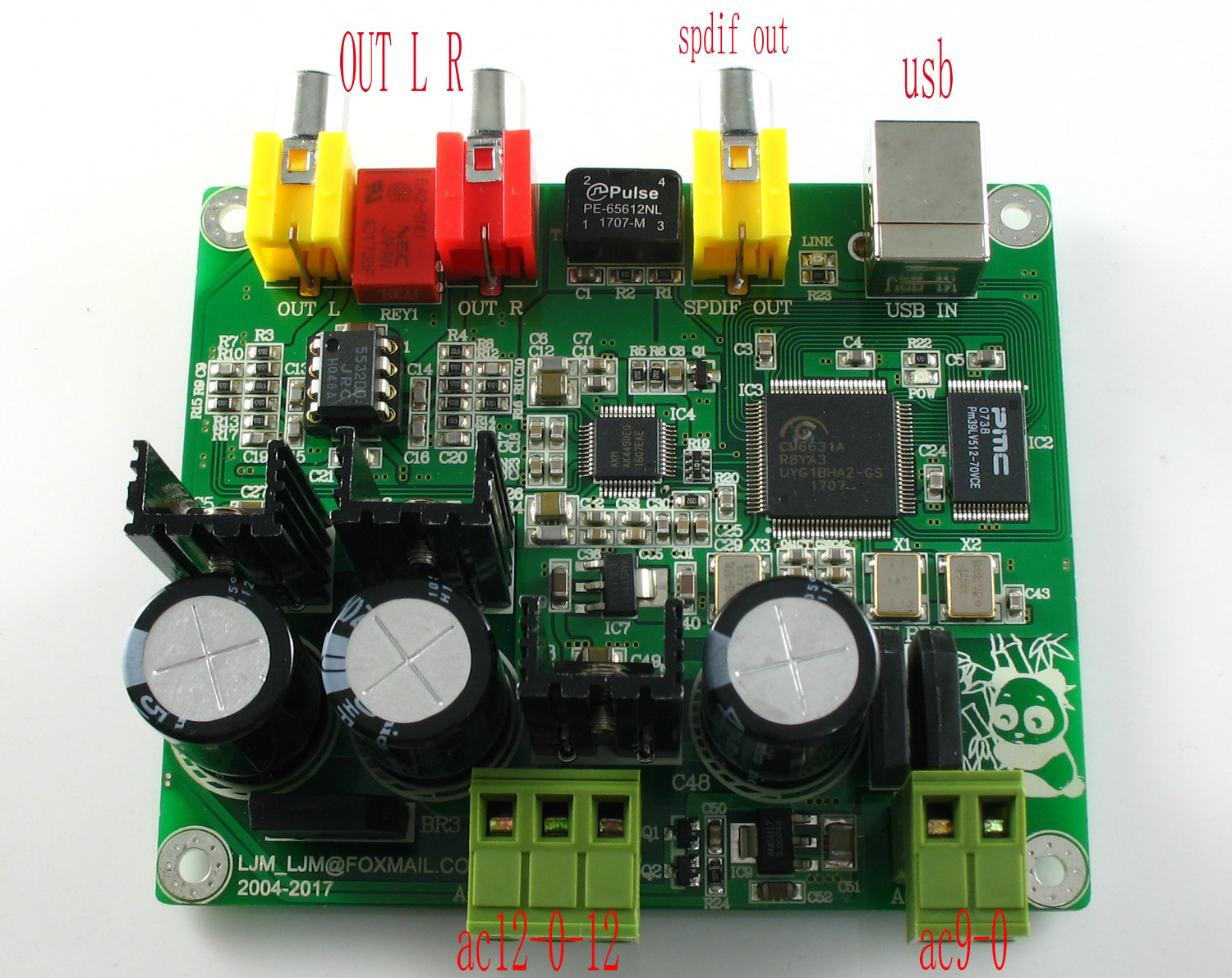

DIY 32BIT-384K USBDAC CM6631A+AKM4490
INPUT USB
OUTPUT Analog output stereo
Suit to launch and a specially designed for the USB interface of DAC decoder
USB USES CM6631A, CM6631A is C - MEDIA company production of special products for HIEND USB audio source
C - MEDIA is one of making sound audio established manufacturers, has a wide compatibility with many big companies
Such as Microsoft, apple and so on, have good compatibility, and compatible with all software is good.
DIY products are pay attention to the compatibility and usability, or even better performance again, is not working.
CM6631A under Windows 7 version of the need to install the driver. You can find the owner.
WINDOWS comes with 10 drivers, and friendly interface, convenient operation. Both use both.
CM6631A support 384 k sampling, is the highest standard of sampling.
In order to match the high sampling of high-performance ?

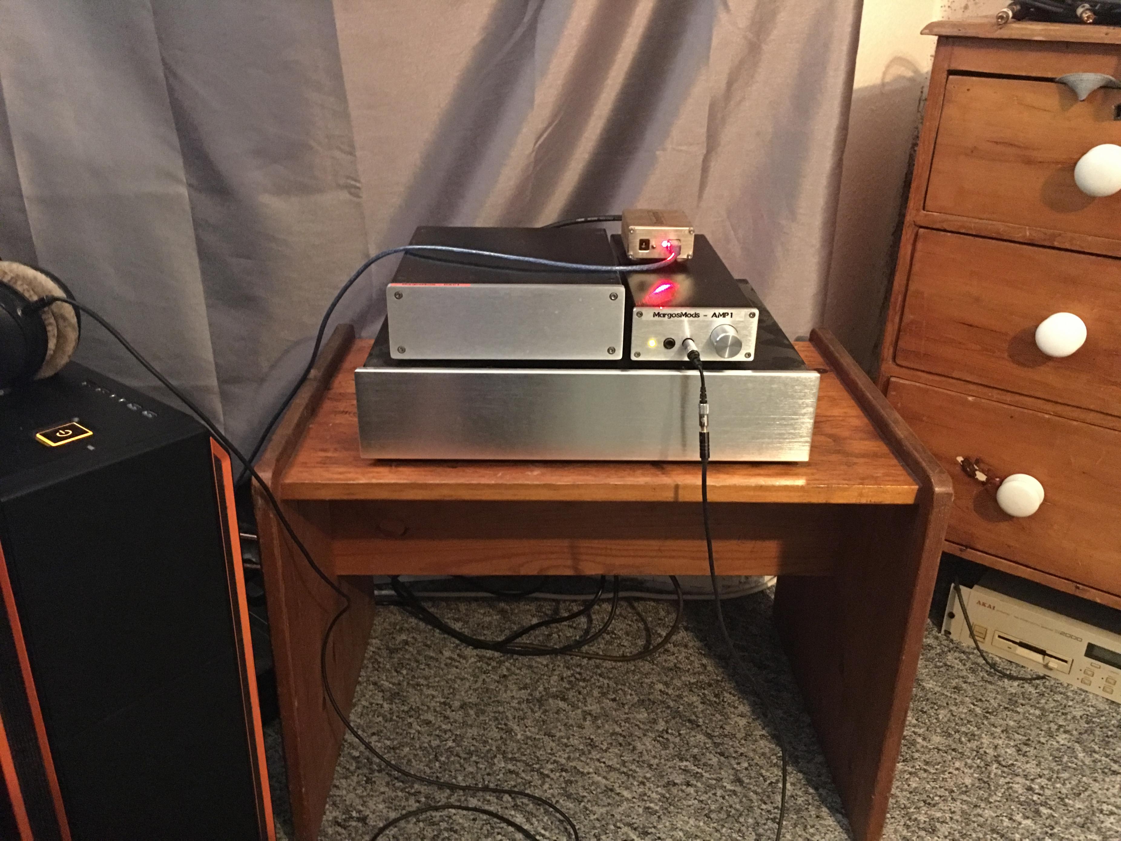

according to my knowledge, the gain of the L7 is about 30 times (30dB), do you think that this amount of gain is enough? do i need a separate preamp? i am a ordinary home user for stereo
You are going to want a preamp, not to give you more gain but to quieten it down! I have a simple lehmann preamp that I built on mine that is also a headphone amp, a little DAC I built, and it works great as a little stack.
well I had a 45-0-45 trafo for about 3 hours at the begining, then I swapped it out for a 30-0-30.
Your rig is great, thanks for advice

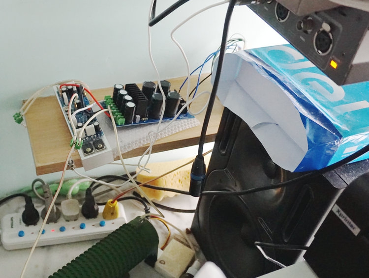

Does anyone can help me with my L15D boards?
I made two of them few months ago and they work well on a test support. They are feed with a connex SMPS800RE at +-58V on 8ohm load KEF speakers.
Few days ago one a the 2 boards starting to have trouble, the led starting to blink and then goes off. However, I couldn't ear any problem in the sound. All is good with power supply voltage and board temps seems good (nothing burning!).
I made few tests with the board and when I start it, the led is blue but it seems to fail slowly until temp is stabilizing and then led is off.
What can be the cause of this behaviour?
PS: as I understand, the blue LED indicate that PWM oscillation is present. So how my board can steel work with no PWM signal?
Thanks, Arno
Arno,
I had the same problem with one out of six boards. I have read this means carrier detection loss - as you suggest. I removed the board immedately so I cannot say if it continued working.
I soldered a new chip and the board works stable. Don´t know what the reason was. The chips are cheap enough.
It is hard to say what the source of the parts is. Are the parts fake or genuine? No answer. But this is a cheap try.
-helmut

Thank you for you answer Helmut, my first intuition was a chip fail but I wanted another opinion before trying to change it. I will buy some spares and tell you if it's ok.
May I recommend that you buy at least one spare chip for each board.
I had fried one earlier by a wiring error I had made and had ordered some. They were already phased out by popular retailers, so I reordered some more - which already took them some weeks.
The companies are phasing out chips at a phenomenal rate, since new stuff hits the market every day.
Also get a few mosfets into the bargain. Everything else is common.
-h
