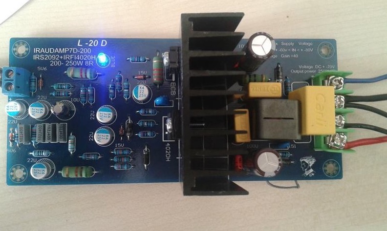

PS. I have a L15D Pro. Can I replace the default capacitors with the OSCON ones as in the picture below ?
I changed the standard 220uF/63V rail buffers with 820uF/63V Panasonic Low ESR ones ( RS 571521 ) they fit on the board and this is audible as a tighter Bass .The standard input caps were changed by Elna SilmicII 22uF/63V . At first I was disappointed by this mod , found the sound a bit dull , but after a couple of hours the sound opened up and after a week or so it sounded much better as the originals .I also added 10.000uF/63V capacitors to each rail at the PSU ( that's for 5 amps in my case , so 3300uF or 4700uF will do for 2 amps or you might trip the overcurrent protection on the Connex SMPS )

Thank's Rens. I'm glad you have also experienced the "opening up" over time of the this amp. I thought I was hearing things but the SQ definitely did change (to the better ). So, I am really happy with the sound at the moment even without any mods. But am looking forward to doing some anyways

Of course you can. Polymer semiconductor solid capacitors extremely well.
25V22UF or 33UF
ljm : if you build new boards, you should consider leave more space for the power capacitors. Just moving a few components would be sufficient.

Larger capacitors. You can consider the use of Cans capacitor?
