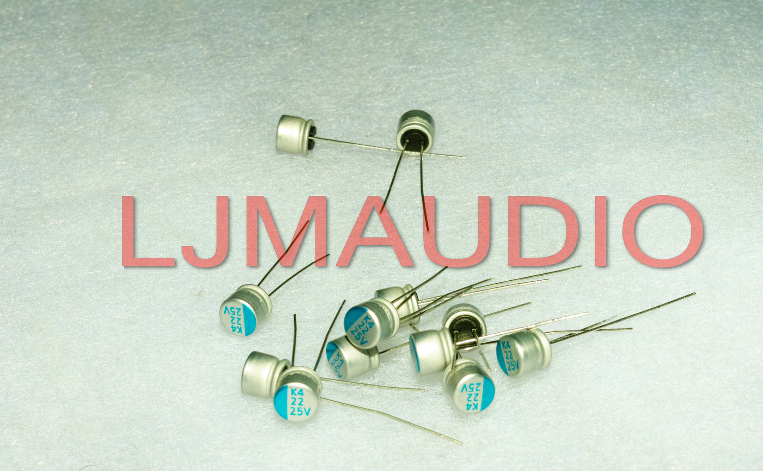

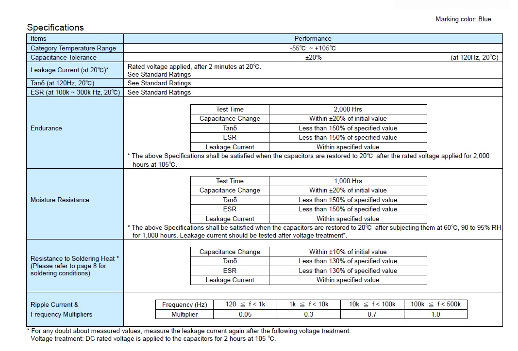

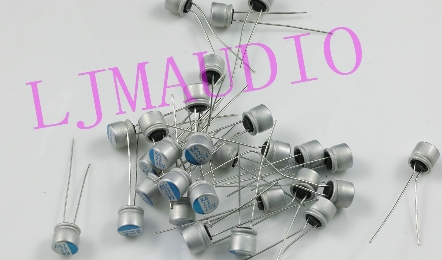

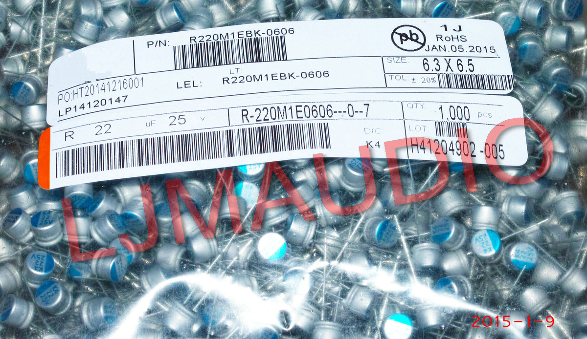

May have to tell you a good news. I spent a lot of time to order a OSCON capacitor.
The specification is 25V22UF it is for L15D, L20D, L25D customized products.
Its parameters is very good, about 20-50 times of ordinary electrolytic capacitor. The value of loss of about 0.016% 1KHZ.
Its price is very high, about 5 times that of ordinary capacitor. I was ordered to it but. Will appear in future products.

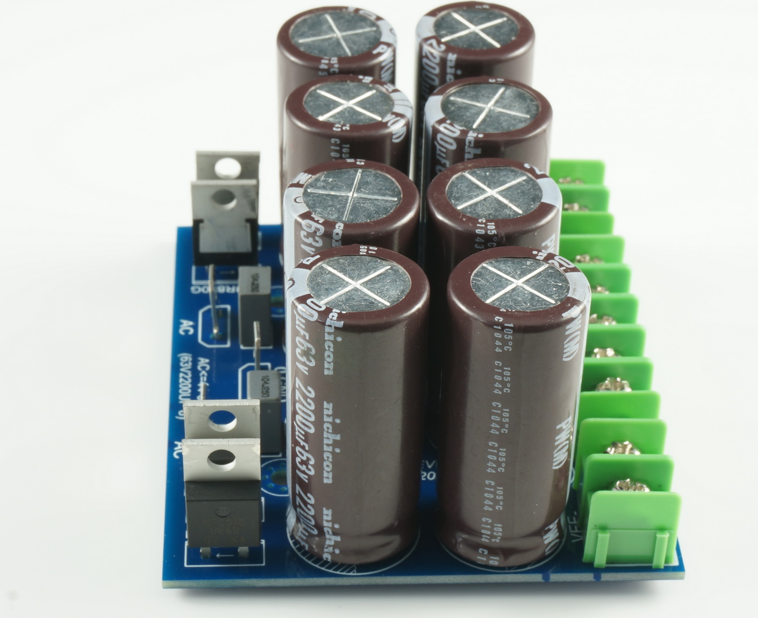

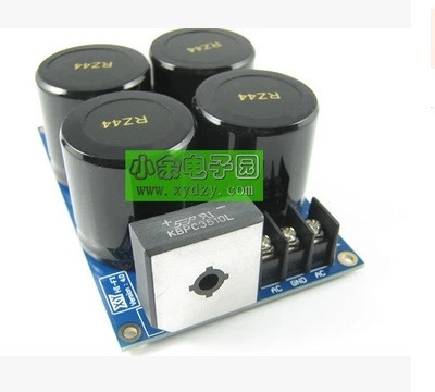

The user feedback information.
I received feedback information from customers, the power supply board is provided by the China businessmen, the reference photos.
Make stereo power amplifier board produce noise, noise performance for the DU, DU, voice, and contains high frequency noise.
Please do not use this power strip, I don't know who it's production.
Suggested use my power panel design with any power amplifier.
