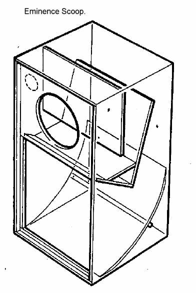

As this thread seems to have grown into the unofficial Danley patent thread, and without wanting to get too involved in the ongoing patent discussion (patent lawyers do make a fine living of arguing about what the definition of the word "is" is); I don't think one can get very far in describing the validity or applicability of a patent when there is little to no agreement on nomenclature, or accuracy in describing what we are talking about.
E.g.: the classic form of a scoop enclosure is a direct radiator with a rear-loaded horn, see: the enclosed Eminence sketch or the classic JBL C34 and C55. Nowadays, on the www, the term scoop is frequently used for all kinds of loudspeakers that do not conform to this classic model, ranging from "horn-loaded port" reflex enclosures to Cerwin Vega's EL-36B Earthquake Subwoofer. Somewhen along the time line the direct radiator wandered into the mouth of the rear-loading horn (e.g.: HOG2, Stipe Ercegovic, 2006). These driver in mouth rear-loaded horns are by present definition tapped horns, and should be technically treated as such. They may not have been tapped horns at the point of their conception, as the designer didn't know of the acoustic principles that would qualify his design as a tapped horn, but rather viewed it as a direct radiator with a back-loaded horn, which-as we now know-is not correct. In my opinion the first picture djk showed in Post #310 clearly fits the description of a tapped horn a la Tom Danley, as to the second or the one jbell references in Post #297: I have not found any internal design details, and consequently can offer no opinion.
The Transflex, various pipes, TQWT, end-loaded transmission lines and back-loaded horns all have been thrown into the discussion and all miss the point that in conception and design the tapped horn is a new and unique application of the laws of acoustics to the problem of low frequency reproduction. As close as I can tell, prior to Tom Danley's work there were no horns with relatively small mouth dimensions, wide frequency bandwidth and a reasonably flat frequency response extending below the free air resonance of the horn driver; and he achieved these characteristics through a unique way of driving a horn with both sides of the driver at different points of the horn, in other words both sides of the driver are energizing a tap inside the horn, and one of the taps can be the classic horn throat. I have no doubt, he deserves a patent for the uniqueness of his insights. If there had been anything obvious or self-evident about his invention, somebody would have done it much earlier.
William Cowan's, Walt de Jong's and Volvotreter's simple tapped horn enclosures all seem to fit the bill, and do not fit another specific enclosure form. Particularly WC's work is a great starting point for an understanding of tapped horns. All are very straight forward executions of a tapped horn and not transflexes or transmission lines. Maybe after knowing about tapped horns and with the fine analytical tools available today one can make the case that there are similarities, but that's about where it ends.
And finally, David McBean's Hornresp program has made it possible to design reasonable approximations of tapped horns, and from the time sequence it is pretty obvious that Danley's work triggered the interest in this type of horn design and David's very fine work, i.e.: Tapped Horn Wizard.
That's the long winded way of saying: I agree with iand's conclusion in Post #290. :)
P.S.: Sorry screamer, I really like the pictures, do you have any more?

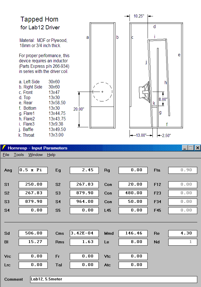

I'd really like to see your dual Lab12 HR input/response screens. I've been trying for some time to get a reasonable dual Lab12 design going because I like those drivers. They seem to have a very good price/performance ratio. At the moment, I'm looking very seriously at a Ciare SW12.00 TH design because it seems to be the best driver for a small (< 250L) TH that can get down to the mid-30's. But, it's quite power hungry and I'd like to get a bit more efficiency. The Lab12's might just do this. So, I would really appreciate seeing your design.
craigwalsh -
S1 = 143.00e-4;
S2 = 168.00e-4;
S3 = 2593.44e-4;
S4 = 2842.00e-4;
L12 = 8.10e-2;
L23 = 302.50e-2;
L34 = 19.00e-2;
Sd=506.70cm2
Bl=15.00Tm
Cms=3.40E-04m/N
Rms=1.60Ns/m
Mmd = 146.50g
Le=1.50mH
Re=4.30ohm
TH 2P
At what SPL do you want to hit those 30 Hz notes?
The cut off on the above is 32hz as is. I cant recall coming up with anything in the 250Lt range that will hit into the 30's. But again I guess it will depend on the volume level you are looking for.

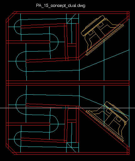

In pic one with its push pull you loose diaphragm area. Since this is a Pro PA. The clarity gained from a push pull isn't as important as over SPL.
As far as the second one. That is 2 separate subs.
I do like the resonator there. Do you have either HR or Akabak inputs for this? I am learning Akabak but dont have a clue as to how to input a resonator as such.

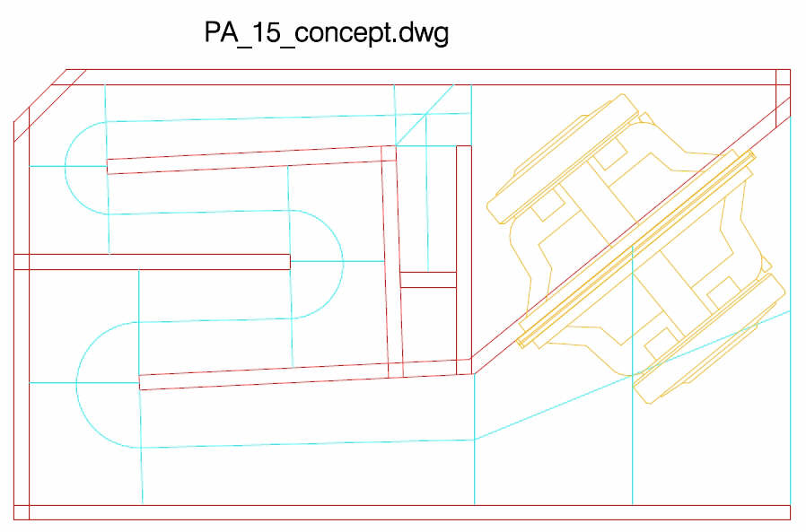

My thinking is more along the lines
of a Th 115 style where both drivers are at a V in the mouth but aren't vertical like the pic on Post #9. I have only been sketching so far.
Hi FlipC,
Picture 1, Post #349, was just to show the concept of a box that can be arranged in multiples with the magnet pointing into the throat chamber or into the mouth, or as a dual with side by side speakers in a push-pull arrangement (thus the two drivers). Picture 2, Post #350, shows two of these enclosures mounted against each other. What looks like a resonator is just the L12 section of the horn, but could well be room for a resonator. What I like about this internal arrangement is that it lends itself to easier tuning and experimenting than some of the other tapped horn enclosures. Even an extension of the horn length can be achieved without changing the driver chamber, throat or mouth by simply increasing the depth of the enclosure. In other words these pictures are mainly a layout concept.
