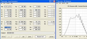

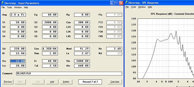

cowanaudio said:That 4:1 compression ratio will destroy your driver.
I thought as you reactance annulled, and made the rear chamber smaller, that you made the compression ratio higher to keep a balanced load on the driver??? And that a relatively large rear chamber would use about 2:1, and a relatively small rear chamber would be 4:1. (as kind of a 'estimate' or rule of thumb to follow, while not going outside of 2:1 through 4:1)
That dayton FLH hornresp sim has about as small of a rear chamber as practical, so I went straight for 4:1.
Am I way off on my compression ratios?

Reactance annulling and compression ratio aren't directly linked; a driver with low Fs will need a small rear chamber, one with high Fs will need a large one, but the total stiffness is the same in both cases.
A higher CR will usually mean more air mass load on the cone which will need lower compliance to reactance annul which means a smaller chamber, but the above still applies.
It's nothing to do with a "balanced" load on the driver, both horn and rear chamber have exactly the same cone loading for both directions of cone movement -- otherwise rectification would occur and the cone would move to one end of its travel.

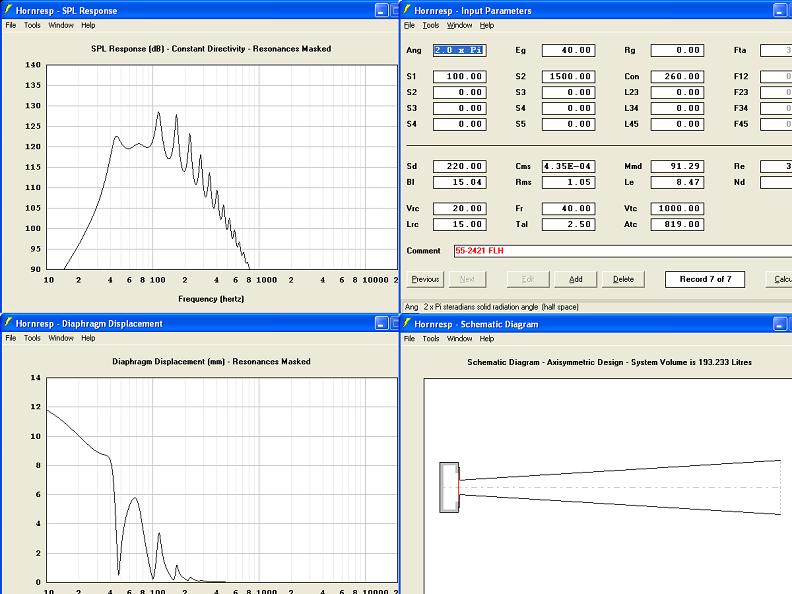

I still can't seem to beat a double driver 55-2421 with an inductor, in various flavors for pa sub on the cheap. I've not personally blown up a 55-2421, but I could see how it would be easy to do.
This design would get me 120db, and with a pair of $25 drivers, which leaves plenty of spare $$$ for cabinet, finish, etc.. to keep total cost under $100.
I've never been able to sim an unmodified 55-2421 in a TH, that works well for PA. Unfortunately a pair of TB 8's doesn't fit my budget.

GM:
Less than 300liters, 120db in 2pi from 40-100hz, under $100.
How unworkable is this? It eliminated the inductor, and a front chamber makes it easier on the cones, but compression ratio is an incredible 8:1
I would really like a 55-2421 TH, as it's the biggest air mover for the $$$. I know others have posted TH's for 55-2421's, but they are REALLY peaky. I need a design that's about as flat as possible, and something I can turn over to someone who doesn't know any better.... (meaning I can't guarantee a HP filter at 40hz, or how far up the volume knob is turned...)
thoughts?

If by 'peaky', you mean the pumped up horn loaded BW above ~100 Hz seen in many TH sims, then yes, being a very wide BW driver the BW you want to use them for is anything but optimum. Otherwise, two in series sims with Johnny-Pat's? measured specs to be nominally flat >125 dB from ~40-170 Hz/2pi/70 V/~214 L net without exceeding Xmax till ~28.5 Hz, but being a for profit venture using a proprietary technology I leave you with your conscience to figure out the details.........
WRT your FLH, it's so misaligned that you'll have to rely on the sim for a proof-of-concept and work from there.
WRT protection against 'headbangers', the time honored light bulb limiter is cheap/effective and can be set up to show when power limiting is becoming excessive and/or easy to replace if ignored.

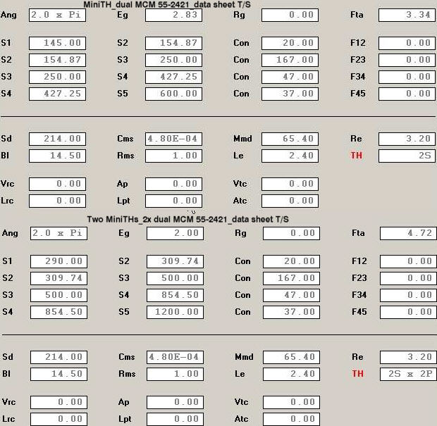

Hi jbell,
Here are some hornresp input screens for a very small dual MCM 55-2421 tapped horn without use of an inductor, and a 3:1 throat compression ratio (the generally agreed upon (?) maximum). The first one is a single box, and the second screen just has the cross-sections doubled and the speaker count adjusted to reflect two boxes.
This little speaker just seems to be designed for use in horns, and in pairs. Obviously, it would take a test box to see what this will really do, but 5/8" OSB is not that expensive .
As to "idiot proofing" loudspeakers: Good Luck.
