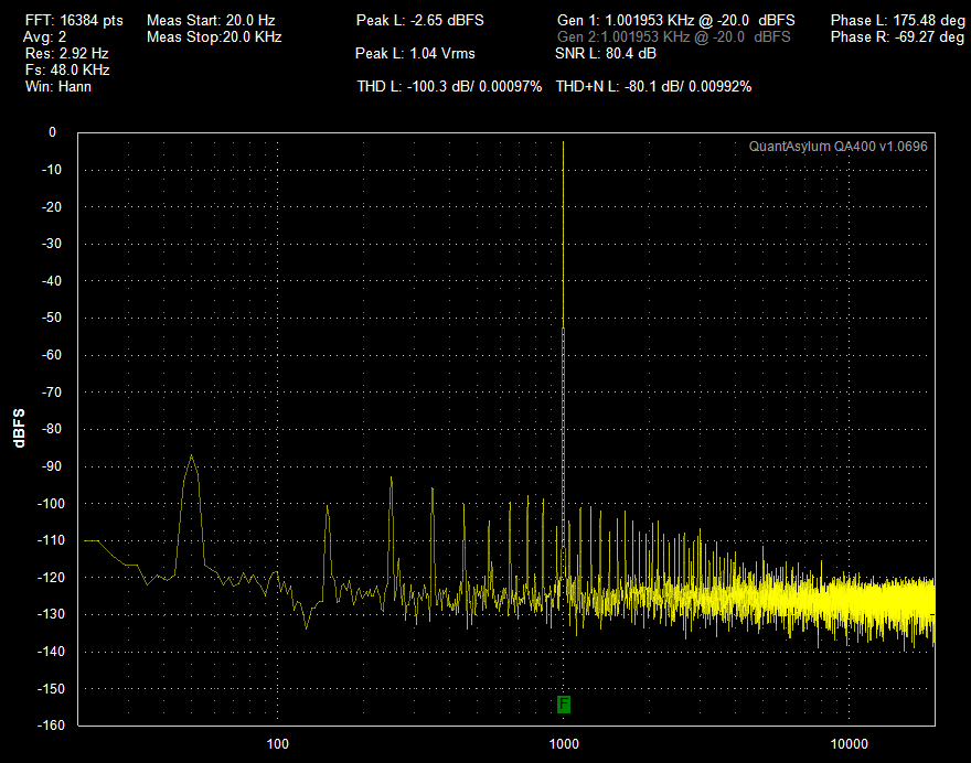

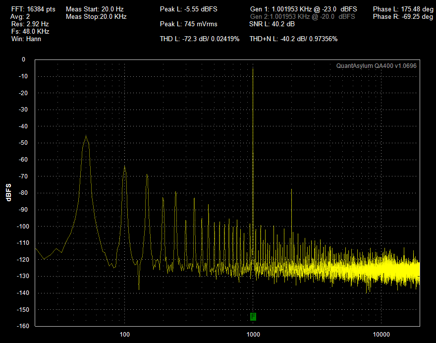

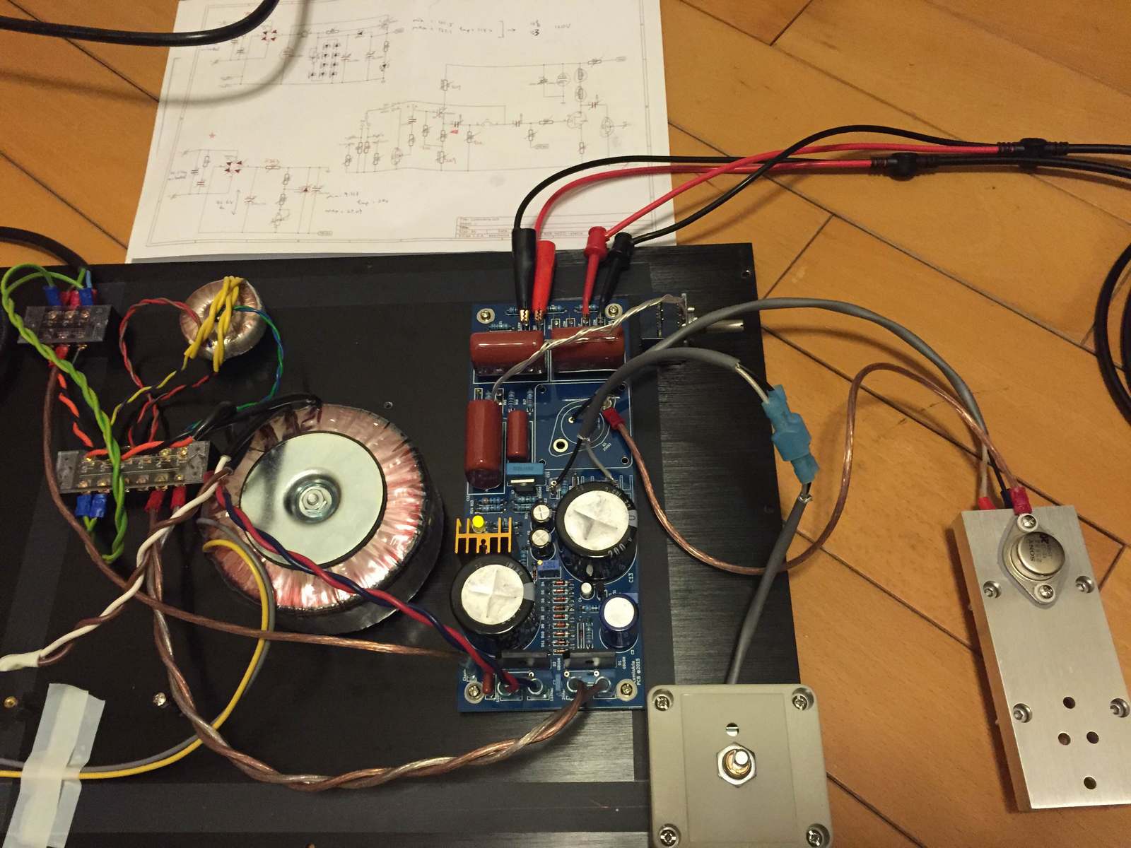

LuminAria @10ppm
So I tidied up and twisted the cables, grounded the board and the 50Hz lowered to around -87dB, still a bit high I think. After more troubleshooting, I realized the unshielded QA400 cable actually pickup a -104dB signal from the environment (even when LuminAria is off) which are then amplified by 17dB by the LuminAria and hence the -87dB, so I assume it's OK for now, unless I can hear some real hum later.
Then I tried to search the sweetspot, and easily lowered the THD to 10ppm @1Vrms (B+: 114V, Vds: 80V, Id: 73mA, Rd: 600R). First picture is the QA400 measurement after the optimization, second one showing the initial hum, and third one the test setup after tidying the cables.
Time to solder the production channel boards, and thanks Michael for this nice design .
... I noticed a 50Hz hum which is -50dB, and then it's harmonics also ...
