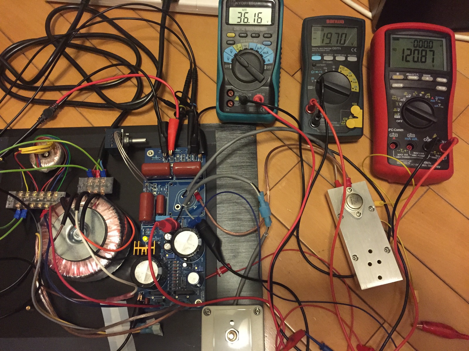

Received the components from Digikey, so I put together a pilot channel for testing ... and it works.
No optimization yet, I set the operating condition arbitrarily to:
B+ - 120V, Rd - 600R, Vbias = -19.7V
This gives:
Id - 60mA, Vds - 84V, Gain - 17.5dB
The 2SK82 runs quite hot (case temp 56 degC), it's currently mounted on a small aluminum block but the actual onboard heatsink is not any bigger, but the leakage current stays quite stable at around 3.8uA
Next step is to find the sweet spot, but with 3 parameters (B+, Rd and Vbias) that can change, this is going to be challenging . Another challenge will be to find two 2SK82 that gives similar gain.

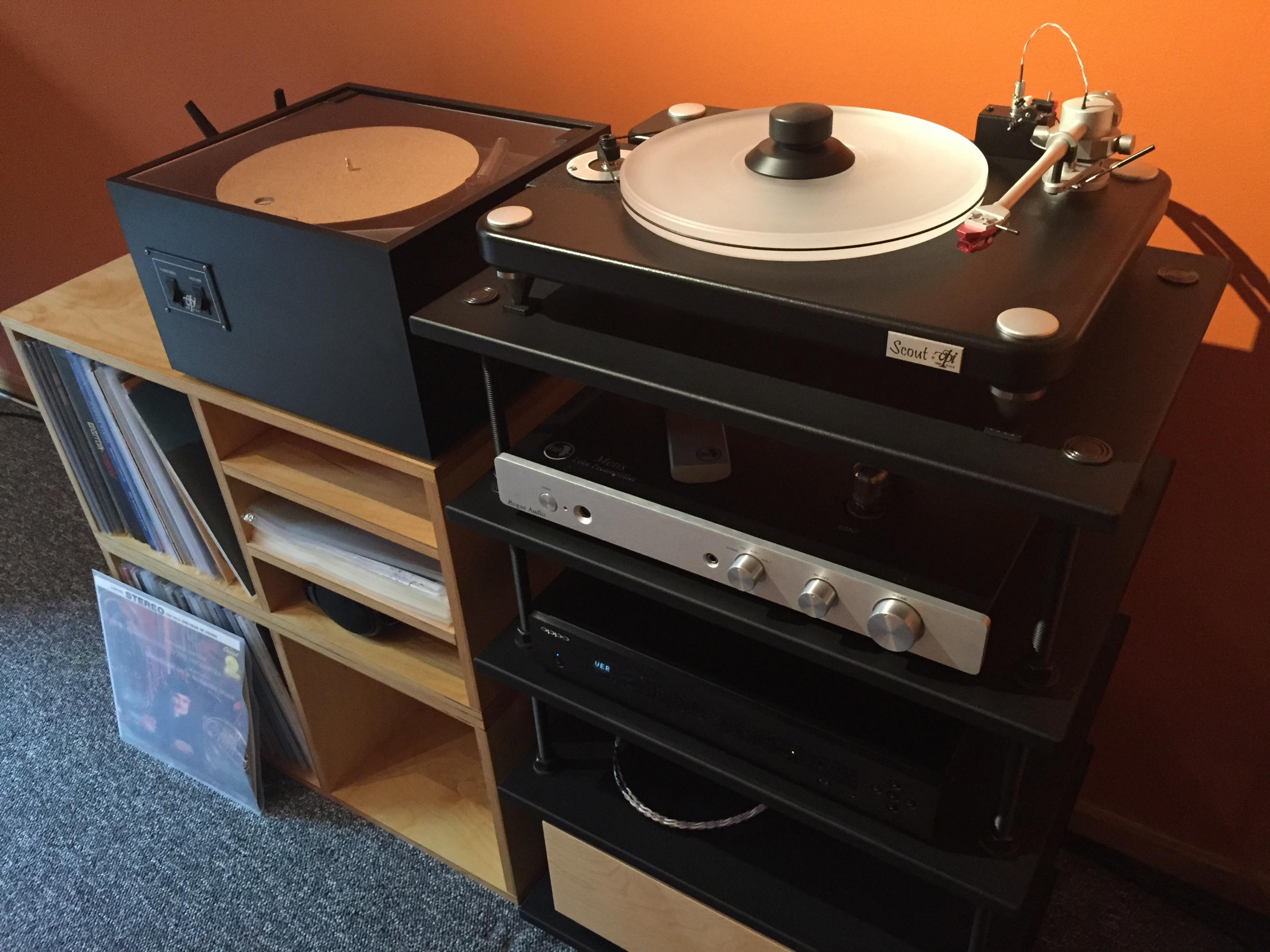

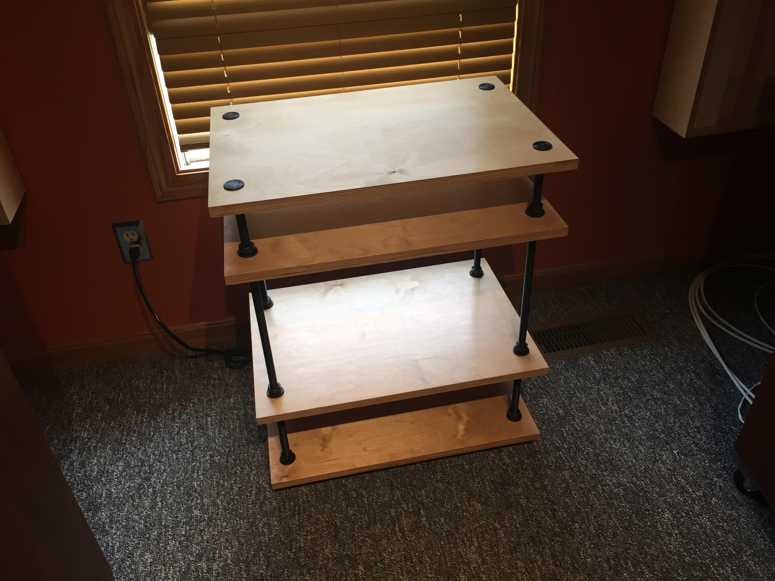

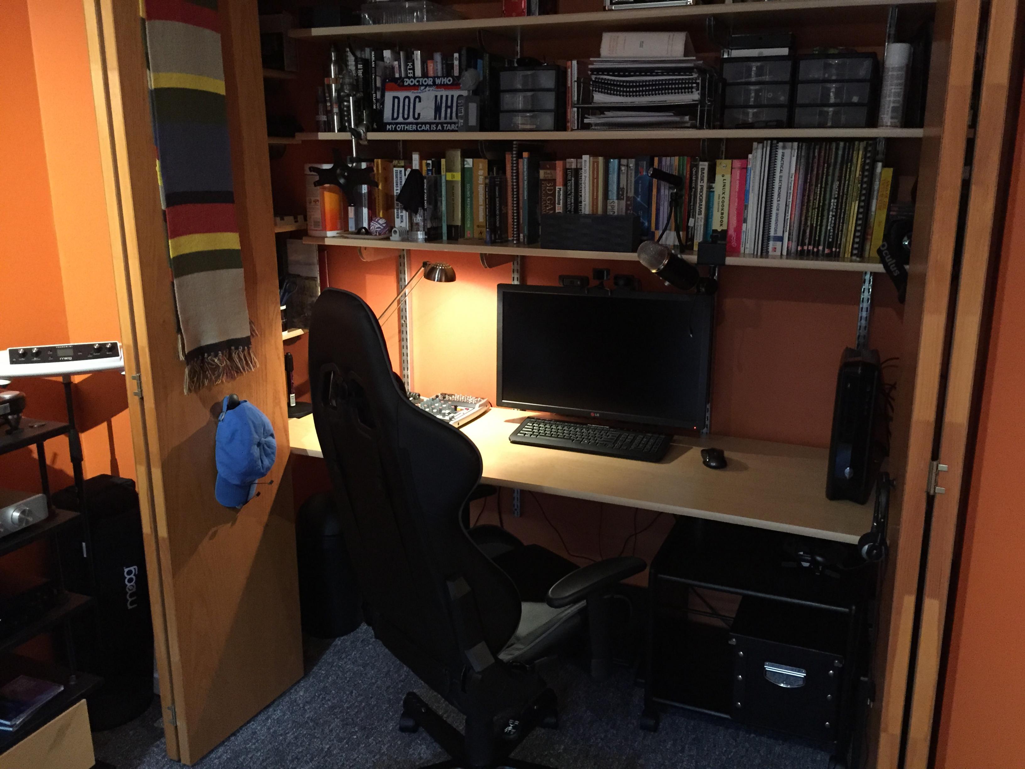

The long holiday weekend afforded me time to finish a couple of room related projects. Some record storage, a drawer for my main rack, and a new rack for the bi-amp/tri-amp review project: it holds three amps and B4 crossovers. all in glorious baltic birch. My listening room doubles as my office so, there's my "instant office in a closet"

Nice work there, Tim

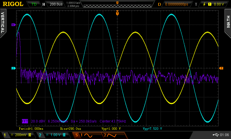

Not quite actually, when I put it under the QA400 last night, I noticed a 50Hz hum which is -50dB, and then it's harmonics also. I will re-arrange the messy cabling and twist them properly (was lazy to do that, thought it was only a test) to see if it solves the problem, I just hope it's not the board,
Your office and listening room is very very nice.

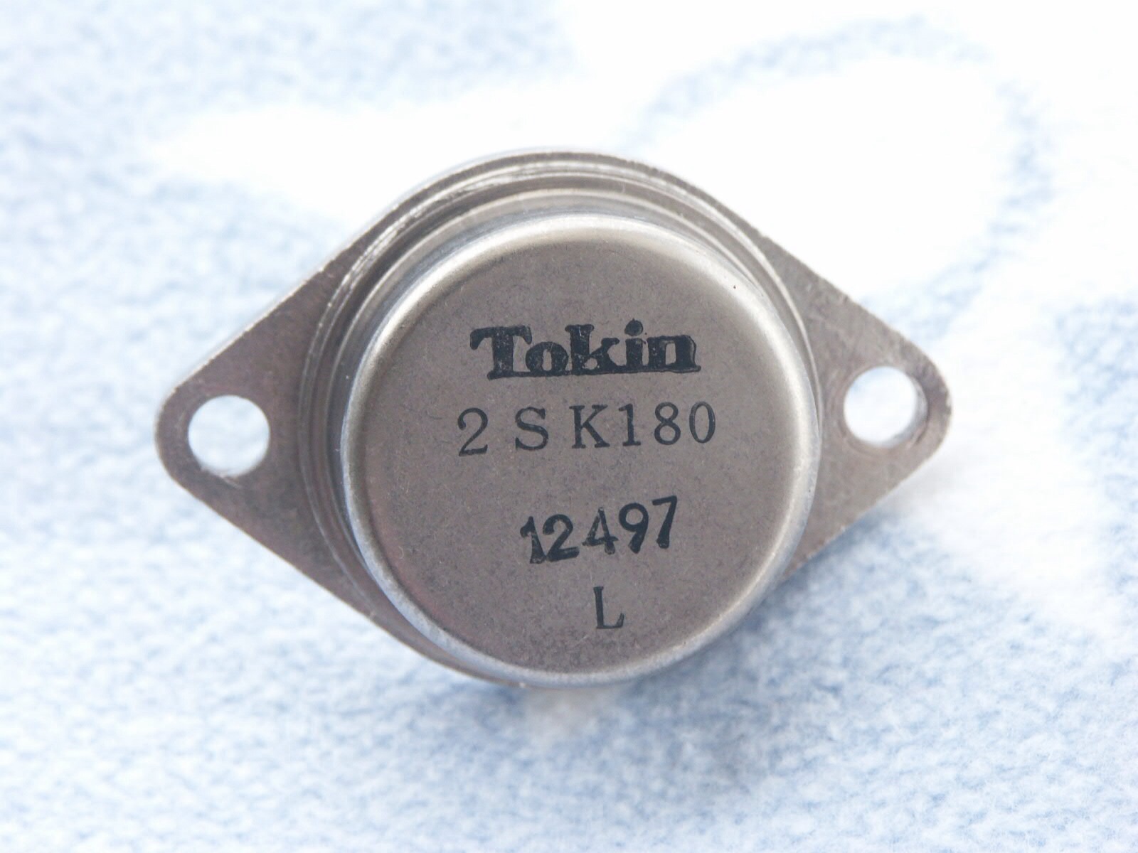

Christophe, you make a fair point. A few nice members sent me some 2SK182ES and I think I should honor them with an amp at the show. I'll see if I can find someone to ship them to. Well, I should probably design and build them first.

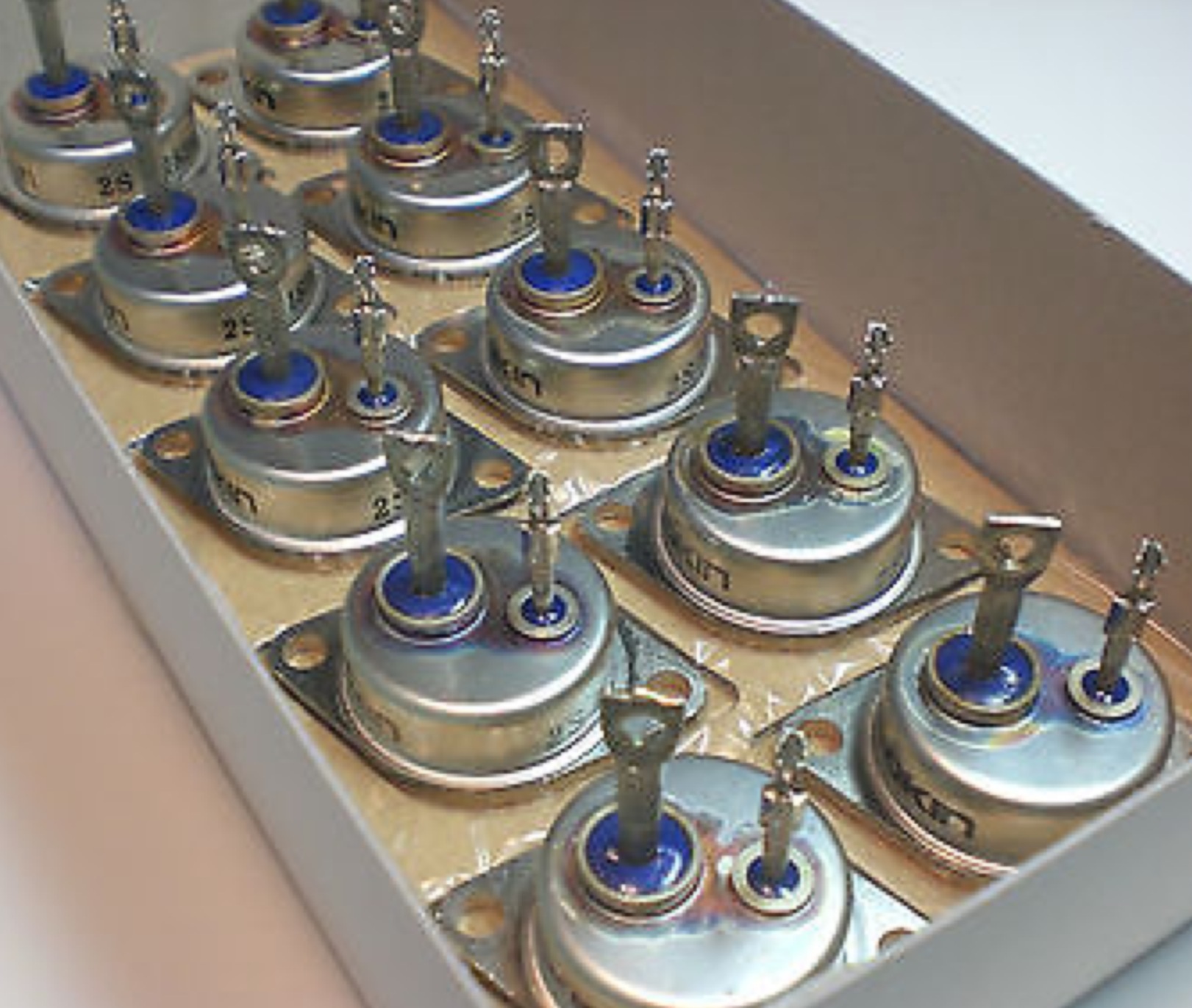

More the reason for me to try attend BA2015, since I don't imagine I'll
get another change to see those honking Tokins in action.
