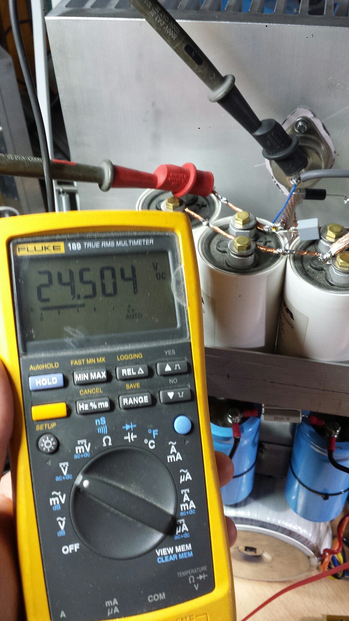

Disipation on sit is a lot, 25V x 4A = 100watt, and power supply of 65Vdc and 4A, 260watt. So, 160watt on resistor..... I can not touch more of 2 or 3 seconds.

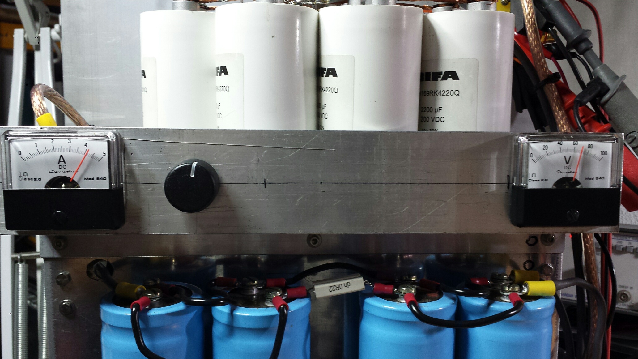

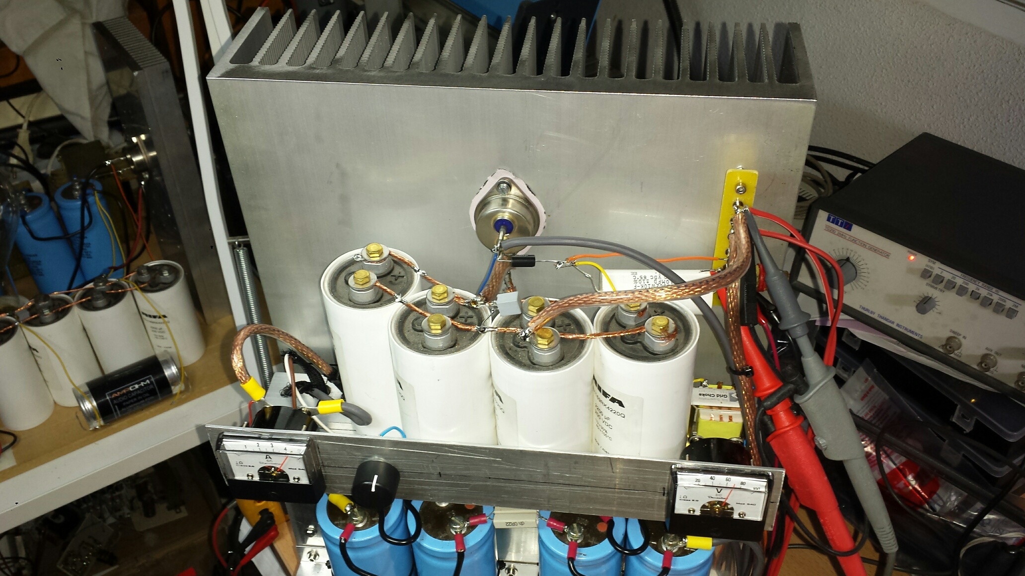

Thank you Esteban and Ulrich. Again, merit is not mine. I only got some components and join.... Schematic is the same that lamp of Michael. Only I did a little change, I used choke grid instead of 47K for bias and, of course, THF-51S. The next step will be mount the second channel and listen again.

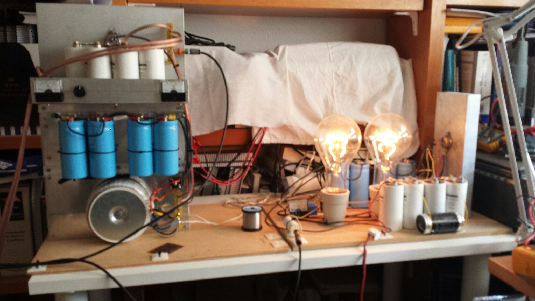

Well, today I am comparing two versions, one channel bulbs and other with resistor. To be honest, I can not hear musical difference between both channels. But, version with resistor is more silent. But because all aluminiun is connect to ground and trafo is away from signals.

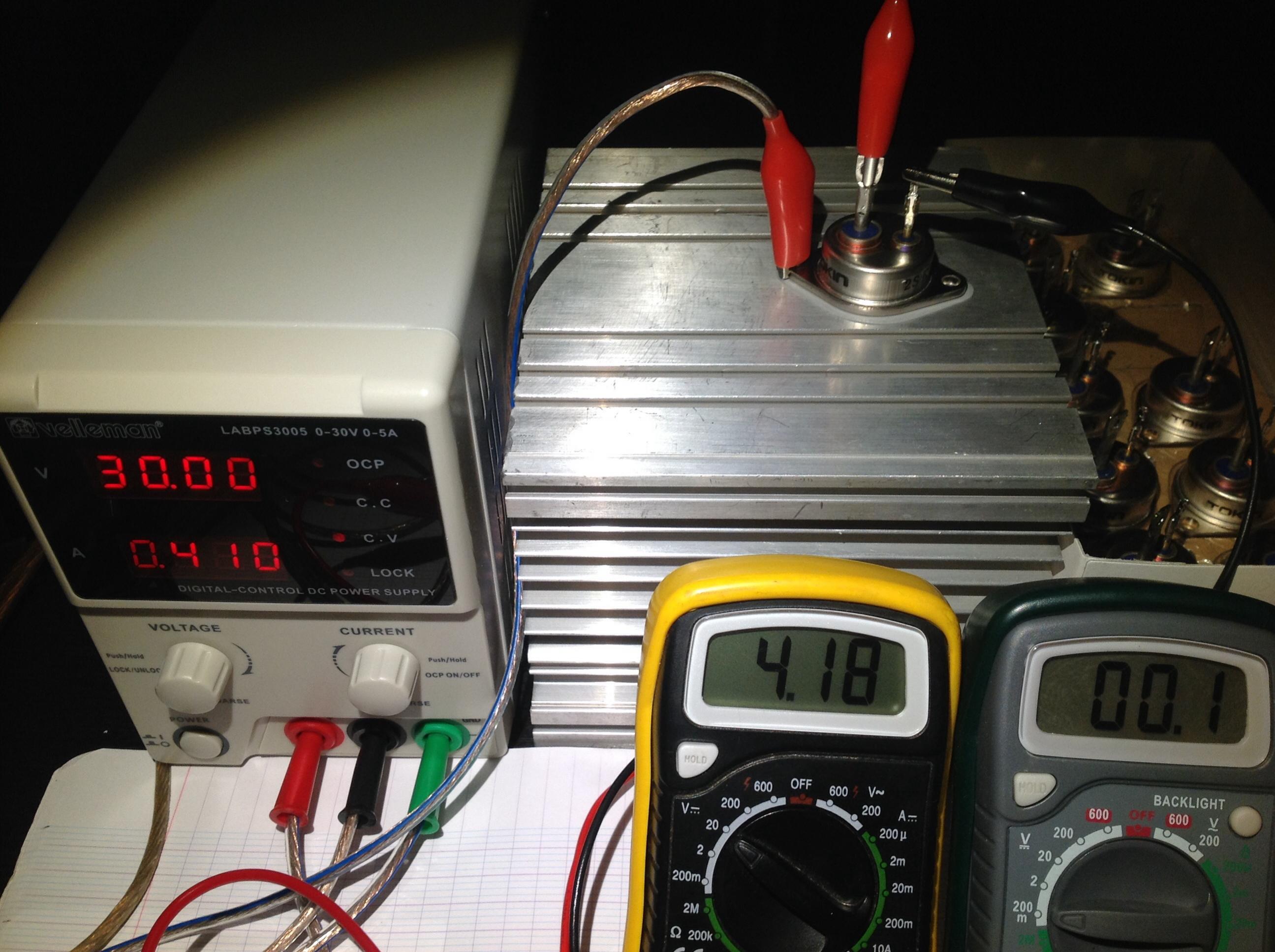

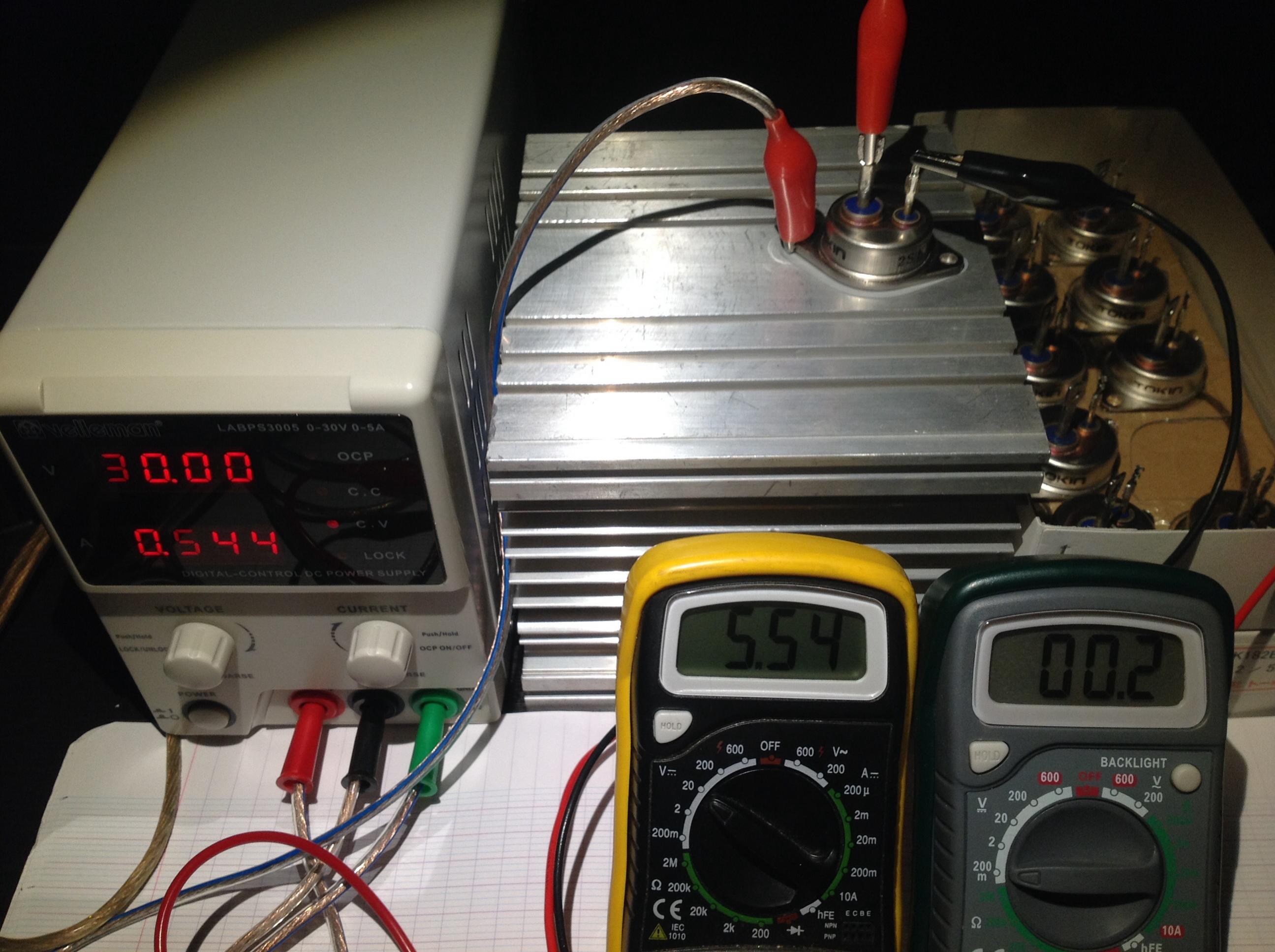

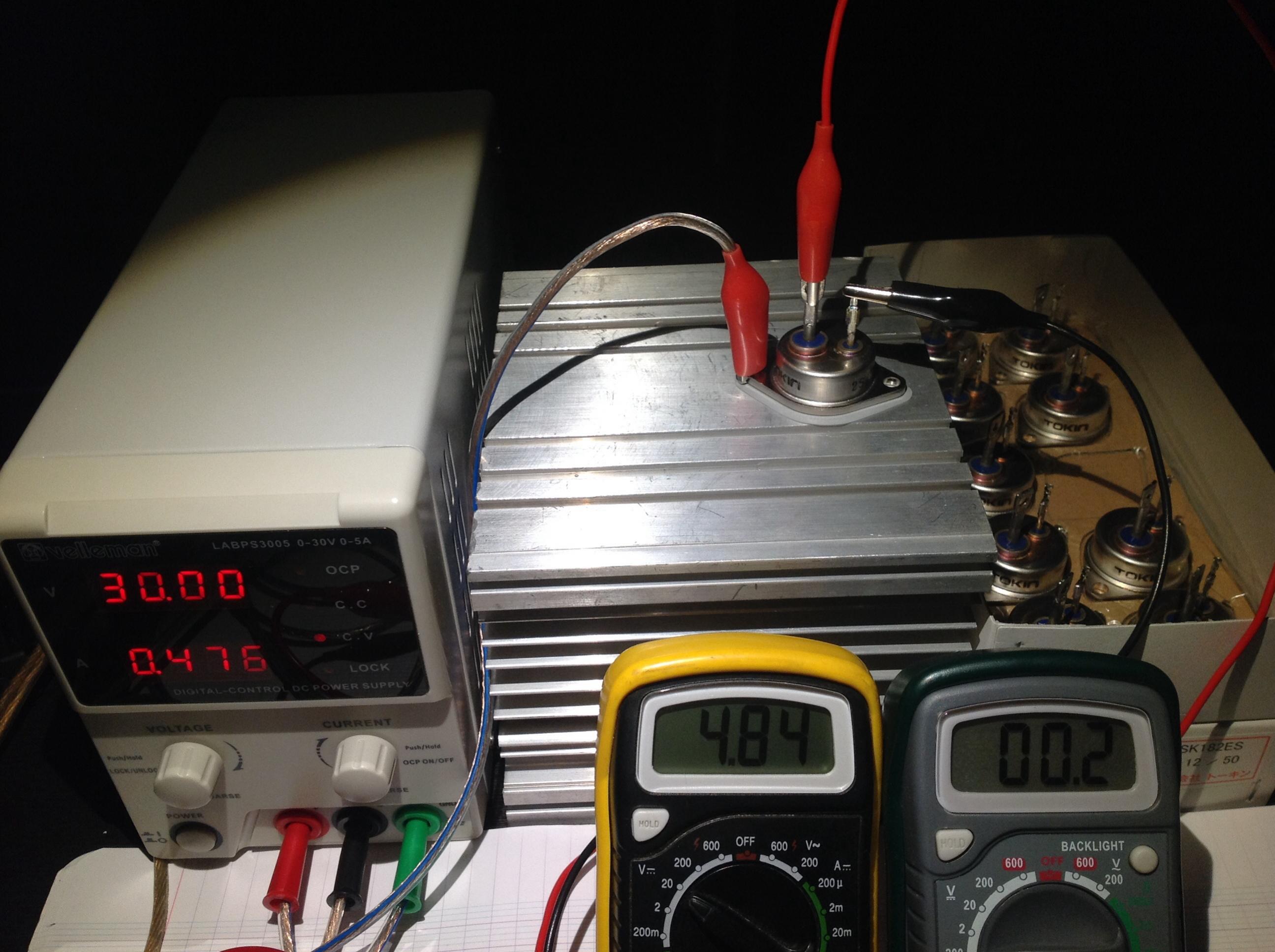

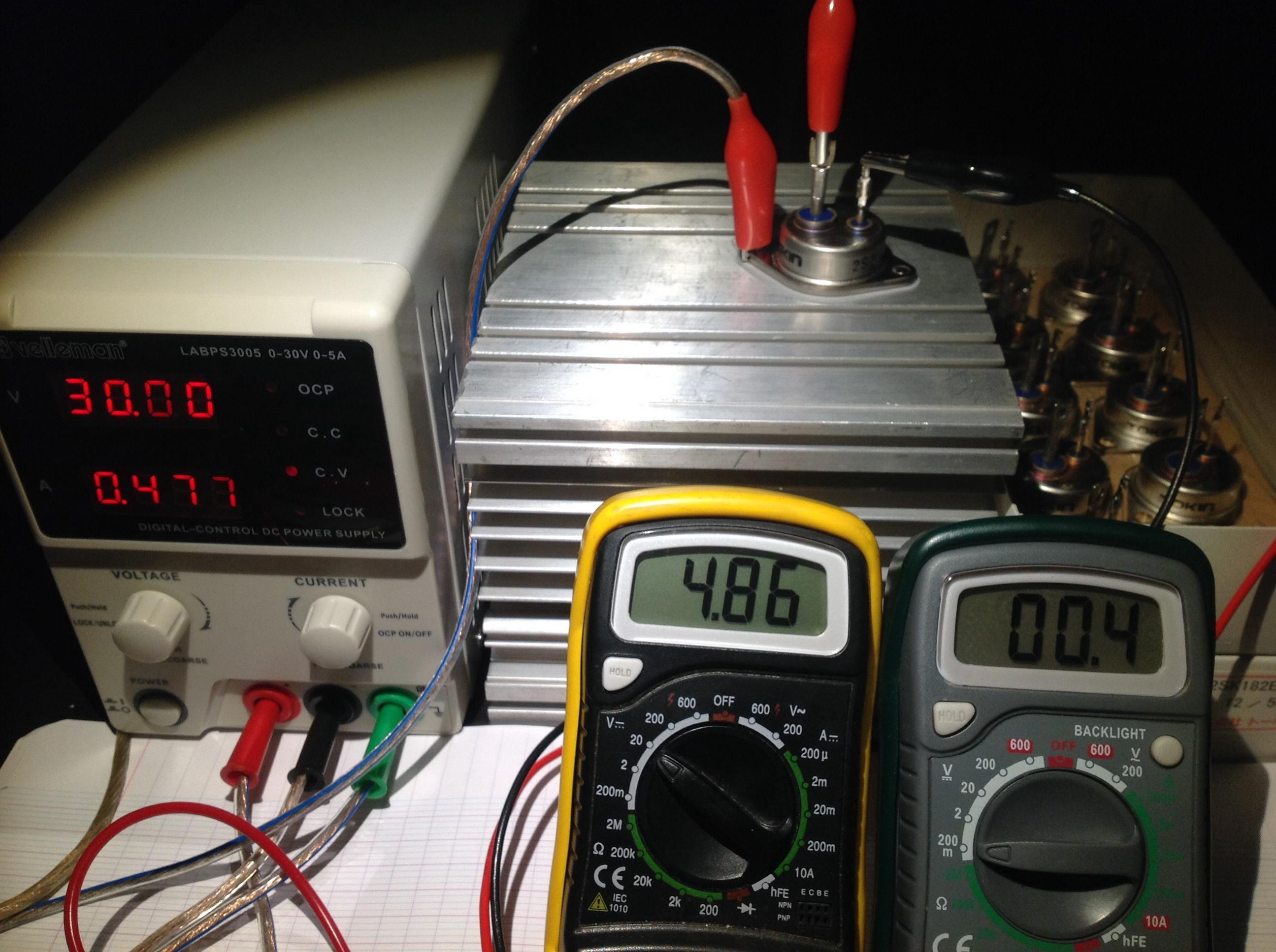

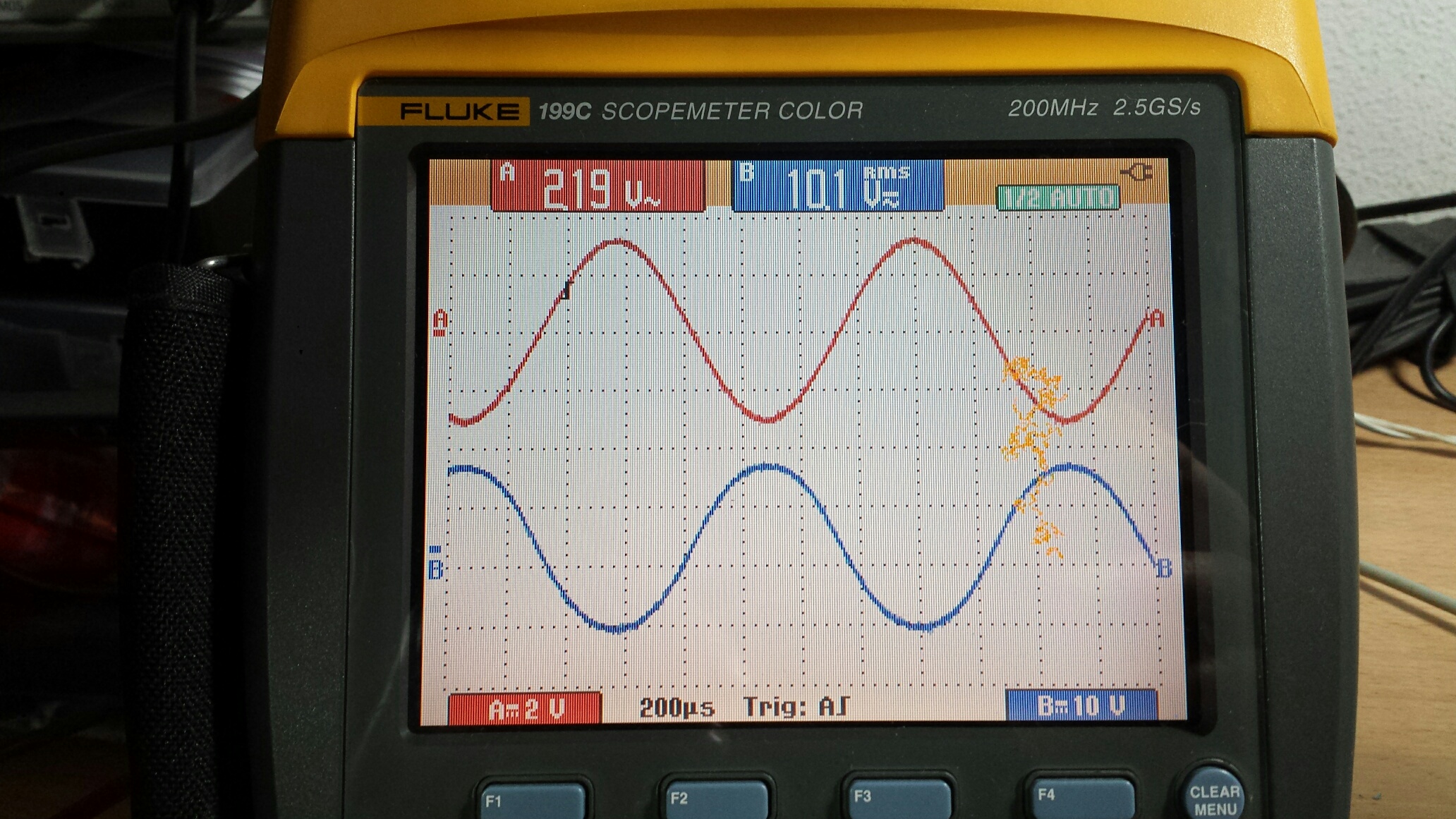

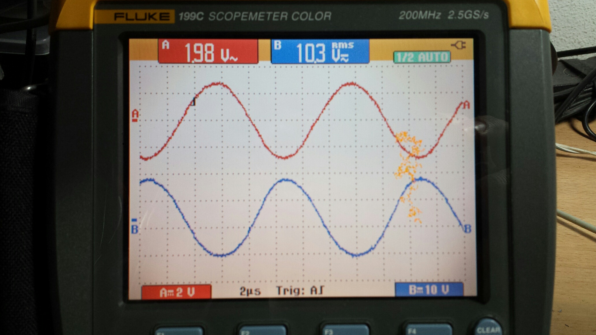

Step by step i try in near future how curves looks from new batch
of Tokin 182ES | 180 "candles" but for today simple tests
with 8R2 power resistor and small 1K.
Ok i must finish psu for my tracer ....stay in tune
