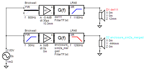

You know a lot more than I do so my information may be unhelpful. However, I modeled my speaker design in ABEC then imported the FRDs into VituixCAD (thanks to Marcel Batik's ATH software). I'd imagine you'd be able to model your open baffle below 500Hz even though you have the live edge because the wavelengths are longer by that point. Then combine your high frequency measurements with the low frequency simulation. Here's an example of what that looks like when combined in VituixCAD.

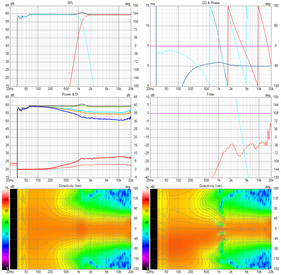

The horn portion is measured in REW. The enclosure portion is a simulation from ABEC merged with a nearfield measurement from the driver in the enclosure.
But with DSP that requirement is decoupled. Now #1 and NOT #4 determines the physical configuration and driver choice.
I also used polar radiation as step #1. Simulated in ABEC first. Then I proceeded from #1 in this order:
#2 Measured two different compression drivers on the waveguide then chose which one to use.
#3 Designed the enclosure to match the polar pattern of the waveguide within the bounds of my limited knowledge and experience.
#4 Used DSP (VituixCAD convolution file) to flatten both drivers on a specific axis determined by my waveguide design.

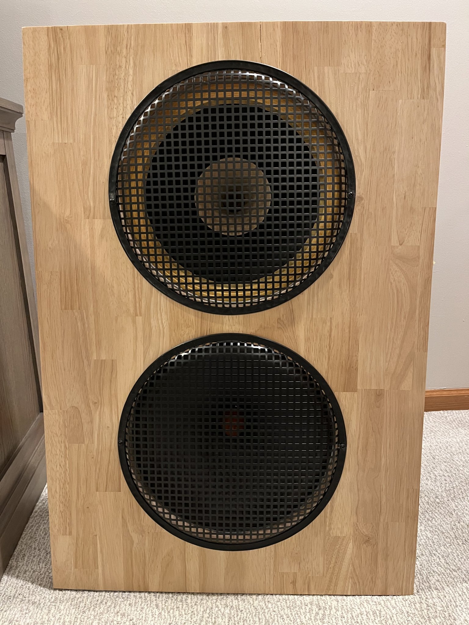

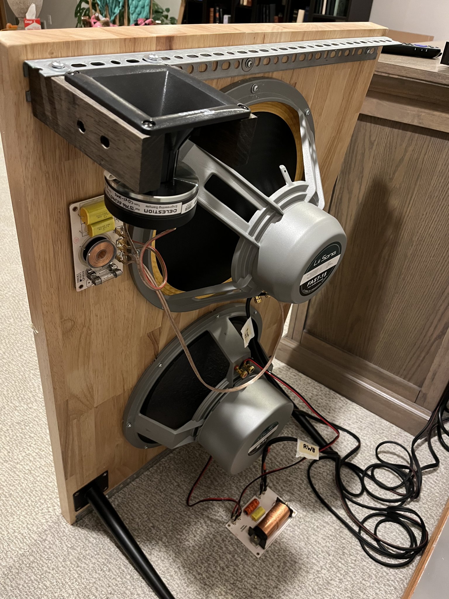

@perrymarshall Thanks for the comments. Here are a couple images of my franken baffles. I am a total amateur. The tweeters are Celestion compression drivers, not truly rear facing, connected in parallel to the Lii Song FR with a Eminence 3500 Hz high pass filter. The high pass filter takes the tweeter volume down a few dB so the efficiency mismatch between the FR and tweeter is not so pronounced. The upward firing tweeters makes a huge difference in the speaker presentation, way more airy and open. I use the Eminence 250 Hz low pass simply because its a work around to allow me to drive both coils of each Lii Song 15" woofer from the 2 channel woofer amp I am using. I like the simplicity of the Amazon table leg back supports and make up for the bass loss by increasing the miniDSP woofer gain. I am using VTV Hypex class d amplifiers, 125 watts on top and 800 W for woofer. The speakers are super revealing and spacious in sound. Probably leaning toward clinical as they are unforgiving to poor recordings. I stream all my music off a Wiim Pro and Amazon HD. Thanks again for the inspiration and I am looking forward to my next project!

Thanks for the pics! The upward pointing tweeter is pretty cool. Hope to see you in person at a cool meetup someplace.@perrymarshall Thanks for the comments. Here are a couple images of my franken baffles. I am a total amateur. The tweeters are Celestion compression drivers, not truly rear facing, connected in parallel to the Lii Song FR with a Eminence 3500 Hz high pass filter. The high pass filter takes the tweeter volume down a few dB so the efficiency mismatch between the FR and tweeter is not so pronounced. The upward firing tweeters makes a huge difference in the speaker presentation, way more airy and open. I use the Eminence 250 Hz low pass simply because its a work around to allow me to drive both coils of each Lii Song 15" woofer from the 2 channel woofer amp I am using. I like the simplicity of the Amazon table leg back supports and make up for the bass loss by increasing the miniDSP woofer gain. I am using VTV Hypex class d amplifiers, 125 watts on top and 800 W for woofer. The speakers are super revealing and spacious in sound. Probably leaning toward clinical as they are unforgiving to poor recordings. I stream all my music off a Wiim Pro and Amazon HD. Thanks again for the inspiration and I am looking forward to my next project!

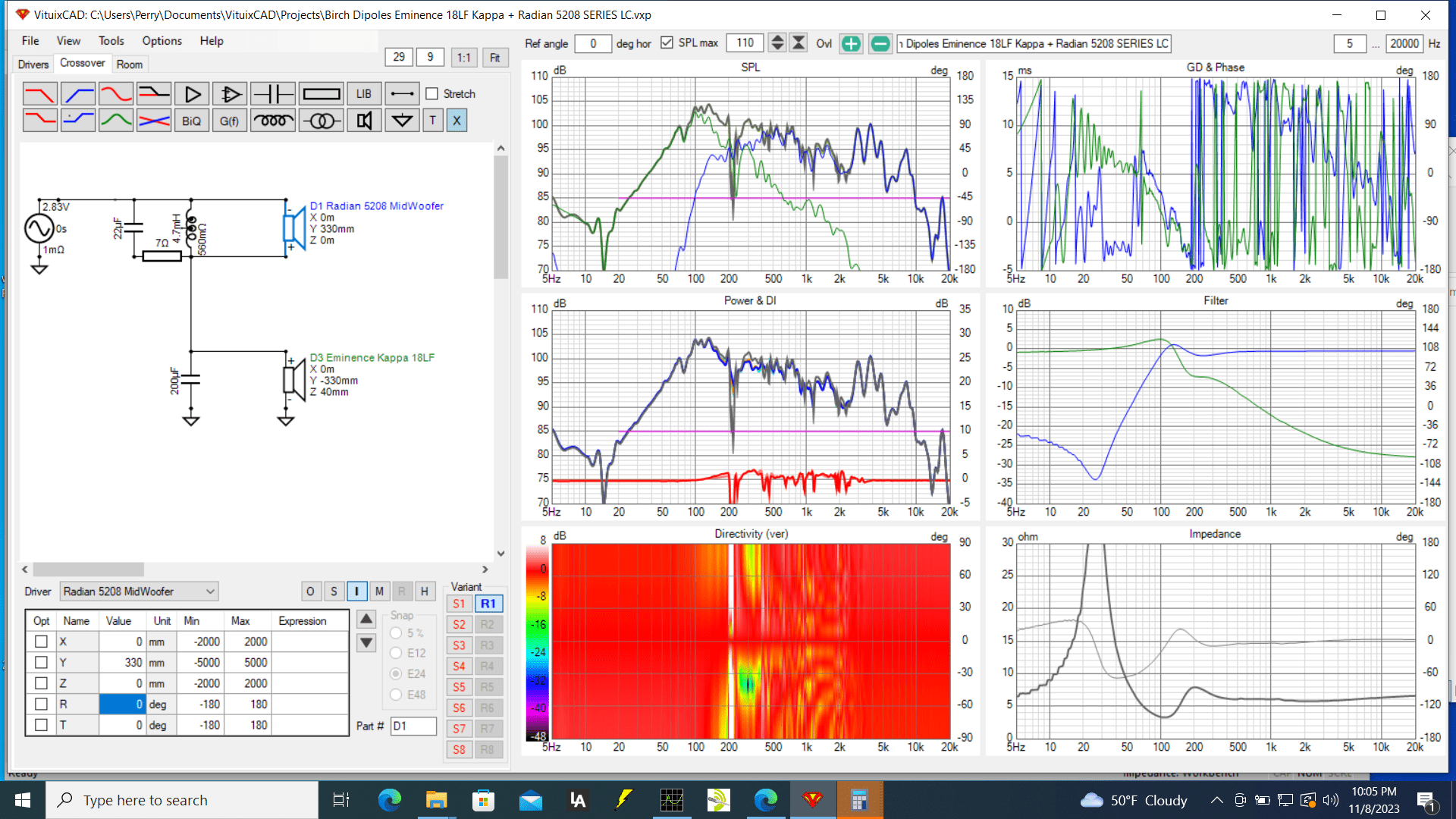

View attachment 1232269 View attachment 1232270
Here I measured the individual drivers installed in baffles at ~0.5M distance, so these measurements have the Open Baffle behavior built in. I measured on-axis only. Then I loaded the data into VituixCad. The software in this model is assuming that these drivers are on the same plane (as though this were infinite baffle) and it is showing the polar plot in RED. There are no crossover components or DSP in any of these measurements.Second, what does vertical directivity look like?
This only shows how the front-facing cone surfaces interfere with each other. I am NOT modeling the additional effect of Open Baffle cancellation coming from the rear, such as would be picked up by a microphone placed above the speaker at +90 degrees. I think it's safe to assume that the vertical radiation pattern above the speaker is otherwise the same as the horizontal radiation I've already shown elsewhere.
BELOW: Live Edge Dipoles - Eminence Kappa 18LF subwoofer + 8" Radian 5208 midwoofer. On the baffle the two drivers are 27"/69cm apart. Acoustic crossover frequency ~200Hz:
In the red "Directivity" graph which plots vertical polar response across +/-90 degrees, there are narrow bands of off-axis anomalies beyond -10 / +30 degrees. Overall nicely behaved. I'm not sure that dip at 200Hz is reliable, it could be a measurement or room artifact. The drivers are 1/2 wavelength apart at the 200Hz crossover.

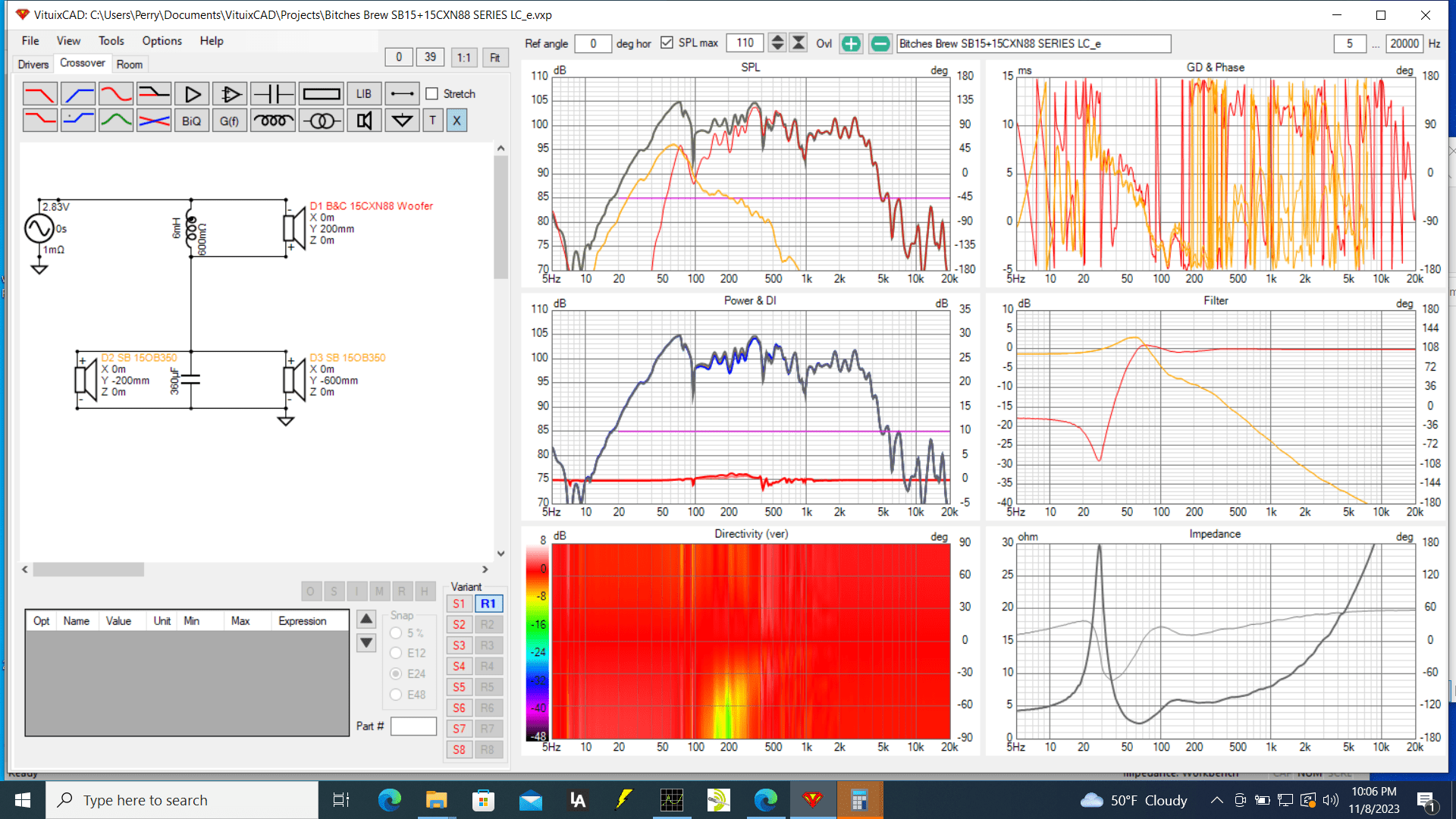

BELOW: Bitches Brew, 2x 15OB350 subwoofers and 1x 15CXN88 midwoofer (each about 16" or 40cm apart):
Acoustic crossover is ~100Hz. In the red "Directivity" portion which plots vertical polar response across +/-90 degrees, the only anomalies are below -30 degrees, so if you're laying on the floor you'll hear a mild suckout around 200Hz. Elsewhere in the room they exhibit Constant Directivity behavior across the entire band. At high frequencies, vertical and horizontal directivity are identical because of the coax drivers. @CinnamonRolls thank you for your very astute and sophisticated model and suggestions.
The drivers are 1/7 wavelength apart at the 100Hz crossover.
So both systems give excellent vertical behavior at any realistic listener position, and power response in the room is consistent.
Subjectively both of these systems have a seamless blend between woofer and midwoofer. Radiation patterns match, signature sounds match, and when you drive the subwoofers really hard the midrange remains clean.
Yep. You have to pick your poison: Proper horn termination, but with polar pattern interference via the separate woofer in the crossover region; or imperfect horn termination of a coax with associated peaks and dips, and near-perfect integration of woofer and tweeter polar patterns.A coaxial woofer will never have proper termination into a baffle face.
Because DSP can more or less compensate for the imperfect horn termination but can't fix polar pattern, at this time I opt for coaxes with compression drivers.
