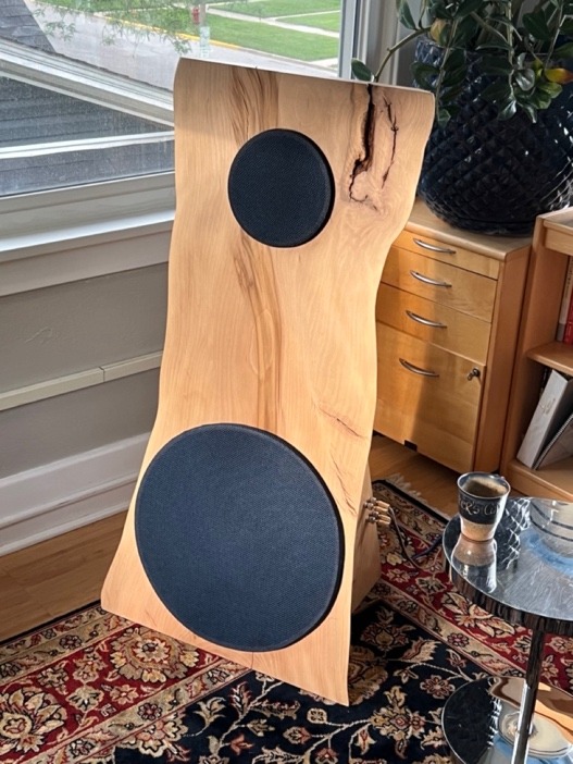

  • Live Edge wood is so beautiful, non-audiophile wives of non-audiophile men gasped when I showed these on a screen in a Zoom meeting.

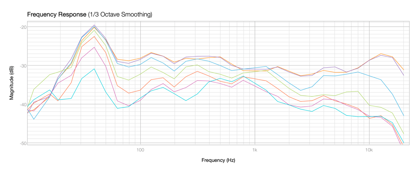

Above: Frequency response in a real room at 0, 15, 30, 45, 60, 75 and 90 degrees. The number of commercially available speakers that come close to these off-axis curves, you can count on one hand. I discuss the polar pattern below. They have a rear-firing “ambience” tweeter which makes the rear radiation very similar to the front. To my ears, dipoles without this don’t sound right. A level pad lets you tailor the ambience to taste.

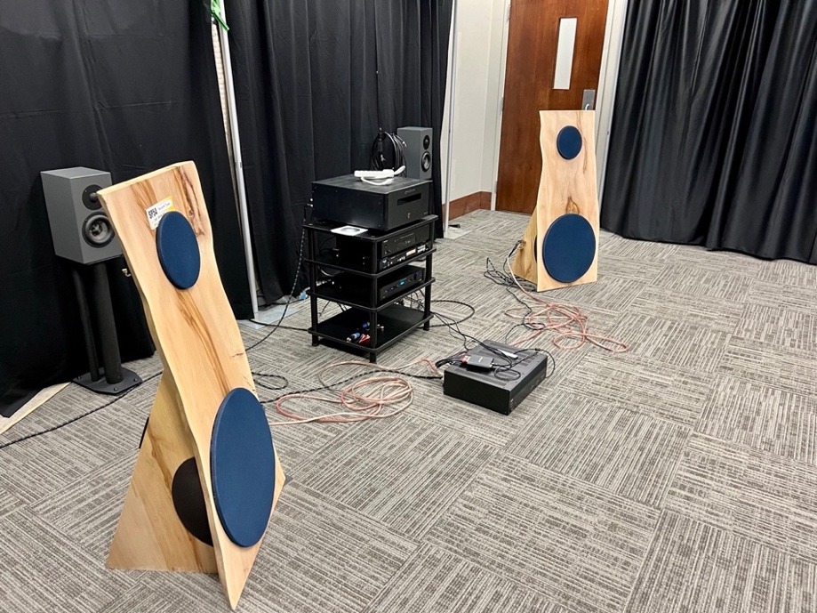

A true Constant Directivity speaker yields good stereo imaging even if you are standing right next to one of the two speakers. It delivers outstanding sonic images to every seat in the house. When arranged in a triangle pattern with the speakers pointed towards the listener position, every seat sounds great.
Great Stereo Image Everywhere

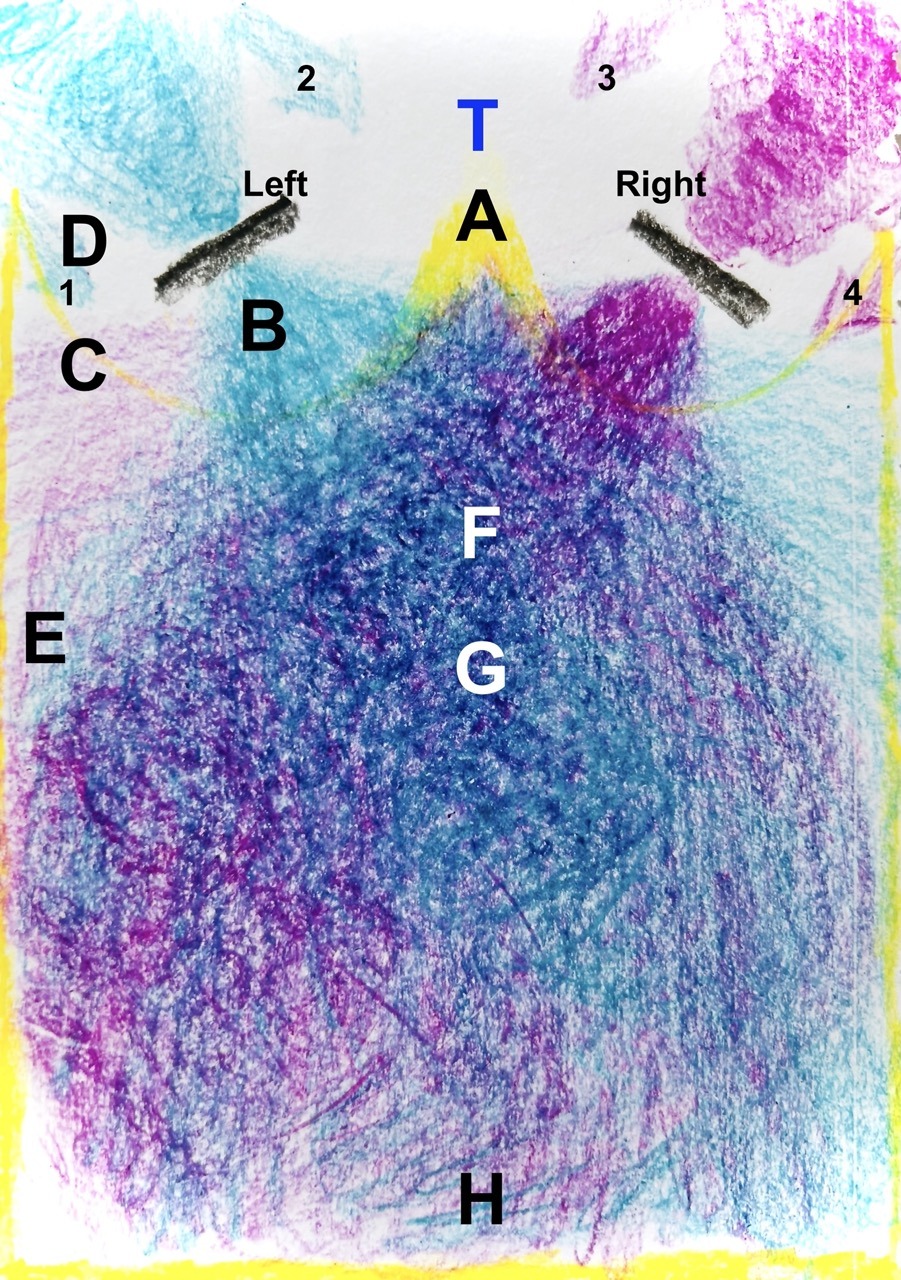

Below is a crayon drawing of a room with Constant Directivity Dipoles. It shows why Open Baffles with uniform response, toed in about 30 degrees, image better than every other type of speaker.
Stereo imaging is strong anywhere inside the yellow boundary, starting at A.
B, right in front of one speaker, is the only spot where imaging isn’t good.
When you stand at C you hear the right speaker across the room just as well as the left. And yes, you get a decent stereo image there.
Same is true even at D. You can hear the right speaker clearly, even standing just behind the left speaker.
There are no sidewall reflections at the wall near C because it’s in the null plane of the dipole.
1, 2, 3 and 4 illustrate that rear radiation reflects from the wall back into the room. This provides ambience but does not override direct sound.
The “sweet spot” is somewhere between F and G, depending on how “headphone-like” you want your sound.
Place your turntable at T, the null for both speakers. Cuts acoustic feedback 10-15dB.
As you walk from C to E to H, the stereo image remains stable and the volume grows louder. E and H, though much farther away, are louder than C because the directivity pattern is so well-controlled.

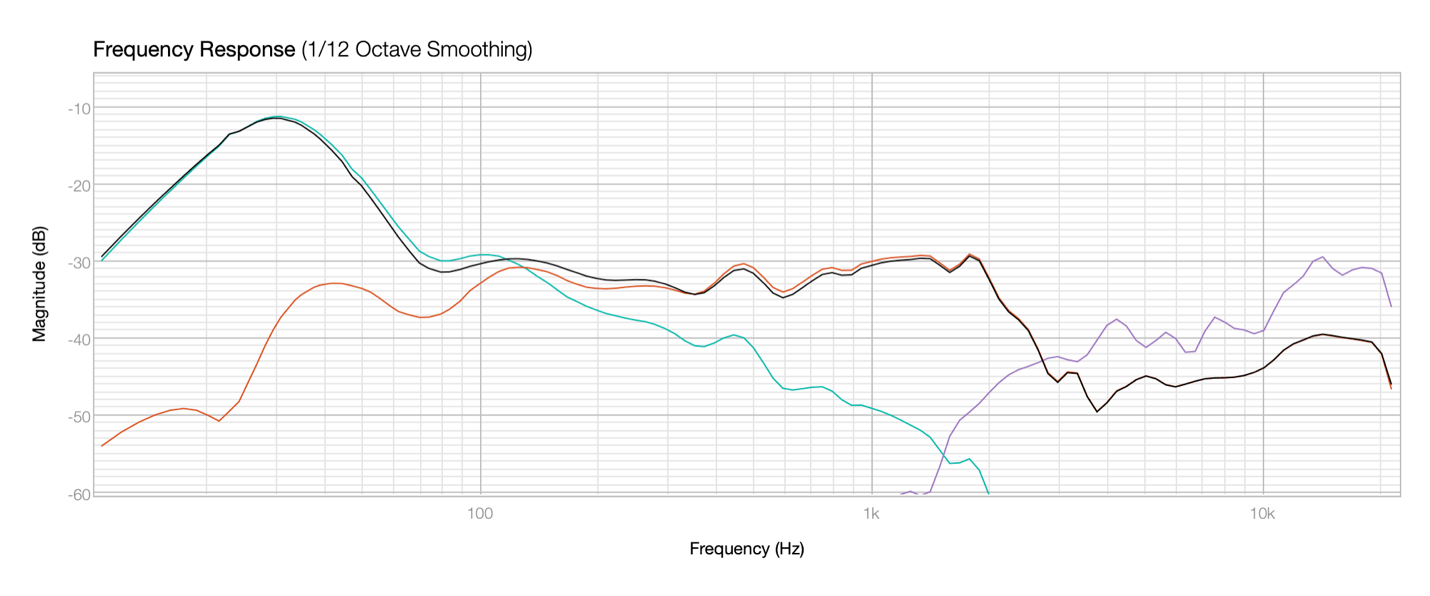

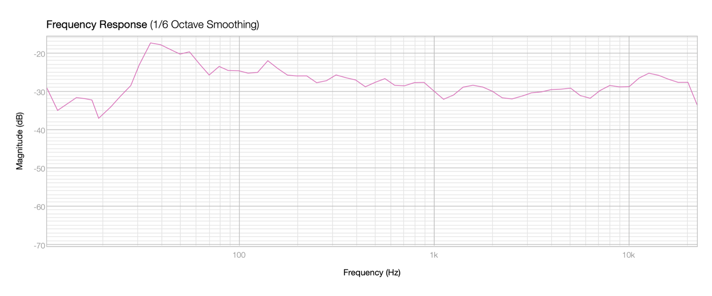

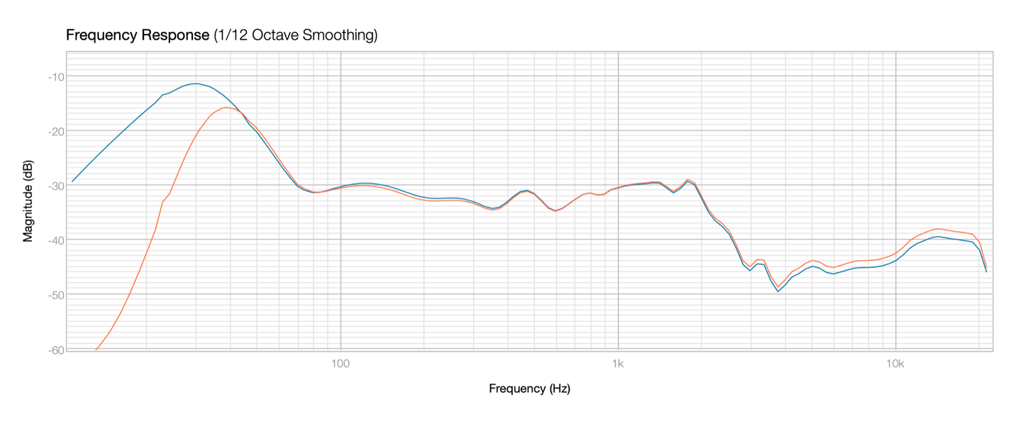

Above: Frequency response of the Live Edge Dipoles, on axis at 1.5 meters in my room. No attempt to gate or eliminate room reflections. Room response should taper downward slightly as frequency rises. Some speakers measure more perfectly in an anechoic chamber… but these measure very well in real rooms. Not just in one spot but everywhere in the room! This EQ sounds most neutral to my ears.
In this design I optimized the physical design and shape for radiation pattern, and then I corrected the problems this incurred with Digital Signal Processing.

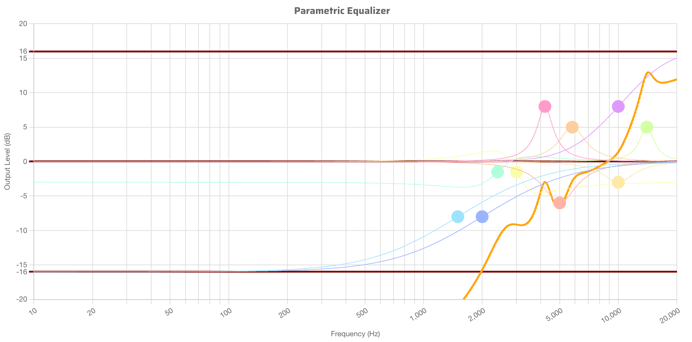

  • I changed the tweeter wiring and several EQ settings in the DSP crossover.

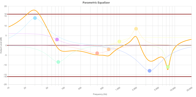

  • I added Bass EQ options. The stock design is flat down to below 30Hz. This is great for small rooms and listeners who are not “bass heads.” However, if you push them super hard with lots of deep bass, the subs will complain. I added a “Rock and Roll” EQ setting that rolls off below 35Hz. With this setting you can play loud music in a large room and the speakers will handle the full dynamic range without effort.

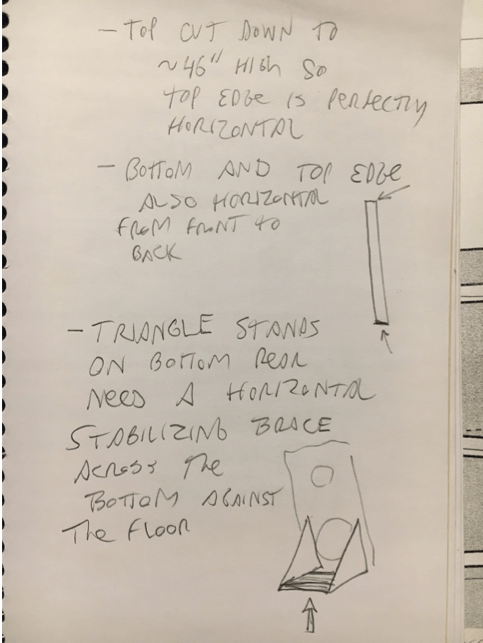

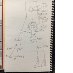

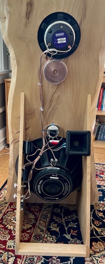

The “Lambda Slab” U-Frame
The triangular sides on the bottom of the cabinet on each side of the 18” woofer pushes the dipole roll off frequency lower. Without them the roll off would start around 100Hz; with them it’s around 60Hz. The wings buy you almost an octave of bass.

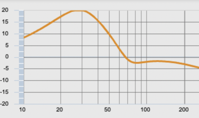

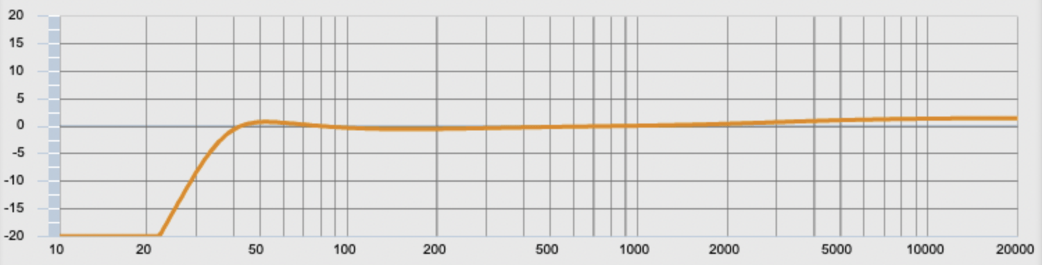

It’s easy to get deep bass from an Open Baffle speaker… you just need a Digital Signal Processor and heavy EQ. You pay a price, however, which is that your woofer can easily bottom. Distortion spikes at low frequencies. I have paid close attention to this issue. The bass EQ begins in earnest below 60Hz. This is the curve for the standard “Jazz EQ” DSP file:
Above: EQ reaches 20dB at 29Hz, then rolls off gently below. Yep, 20dB is a ton of EQ, but remember that these have 95-98dB sensitivity, so across 90% of the spectrum they require very little power. Extra power is only demanded by occasional deep bass passages.
I call this the Jazz EQ setting. It’s optimized for lowest group delay and least ringing in the step response. Most speakers have gobs of phase shift at low frequencies which you easily hear on well recorded bass drums. The steeper the filter, the more phase shift. Steep slopes like in actively assisted 6th order reflex designs add many tens of milliseconds of phase delay. This design sidesteps that.

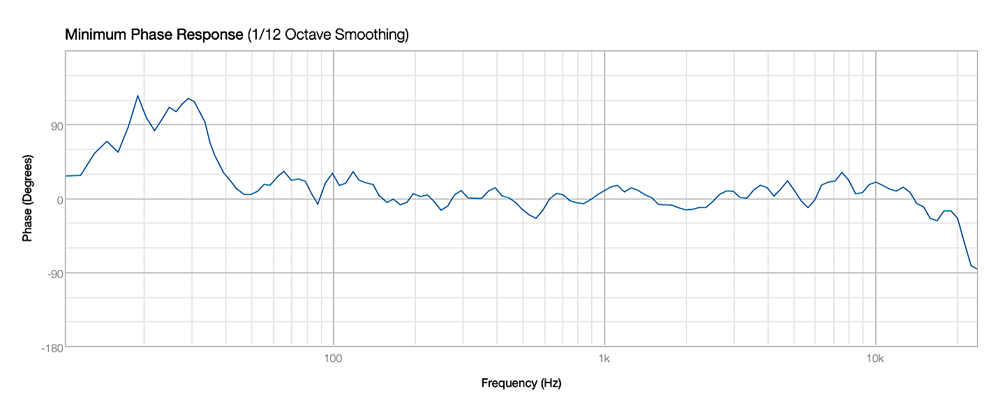

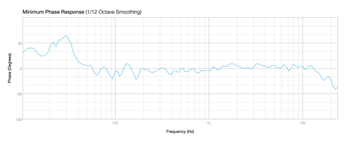

Above: Phase is +/-30 degrees from 40Hz to 20KHz with a max of only 120 degrees around 20-30Hz. Very, very few speakers match this. This cuts group delay and maximizes bass resolution.

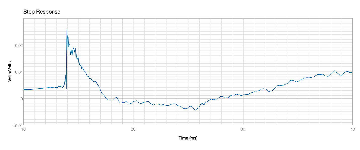

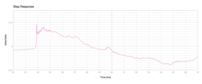

Above: Step response. Fast rise time followed by steady descent with no phase reversals. Drivers fire in perfect time with each other. There is little low frequency ringing because the design minimizes phase shift and group delay. Very few speakers match this. This is one reason why clarity and imaging are so precise.

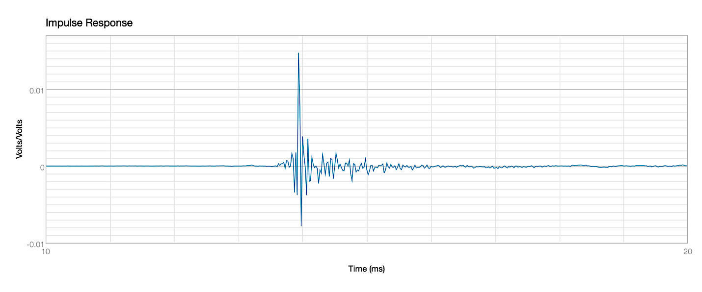

Above: Impulse response. Most speakers shred impulses, which should look like an upside down “T.” The Live Edge Dipoles deliver 80% of their energy in a tight 0.1 millisecond slice. This makes lightning fast transients and exquisite detail.

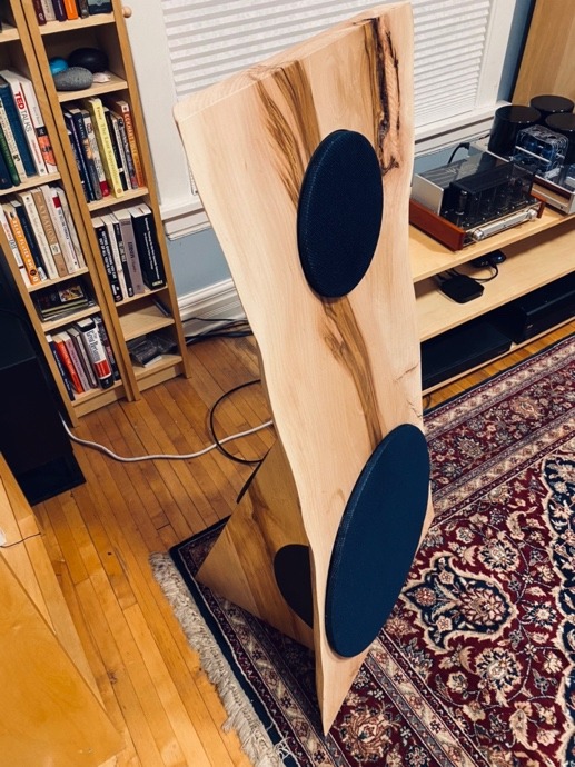

Choice of Wood
There is nothing special about birch, other than I fell in love with the slabs I found at Big Red Sawmill in Palmyra Nebraska. Birch is not heavy. They weigh 57 pounds (26kg) each. Other woods will have a different sound. You may prefer hardwoods like ash, maple, oak or walnut due to their added mass and density.

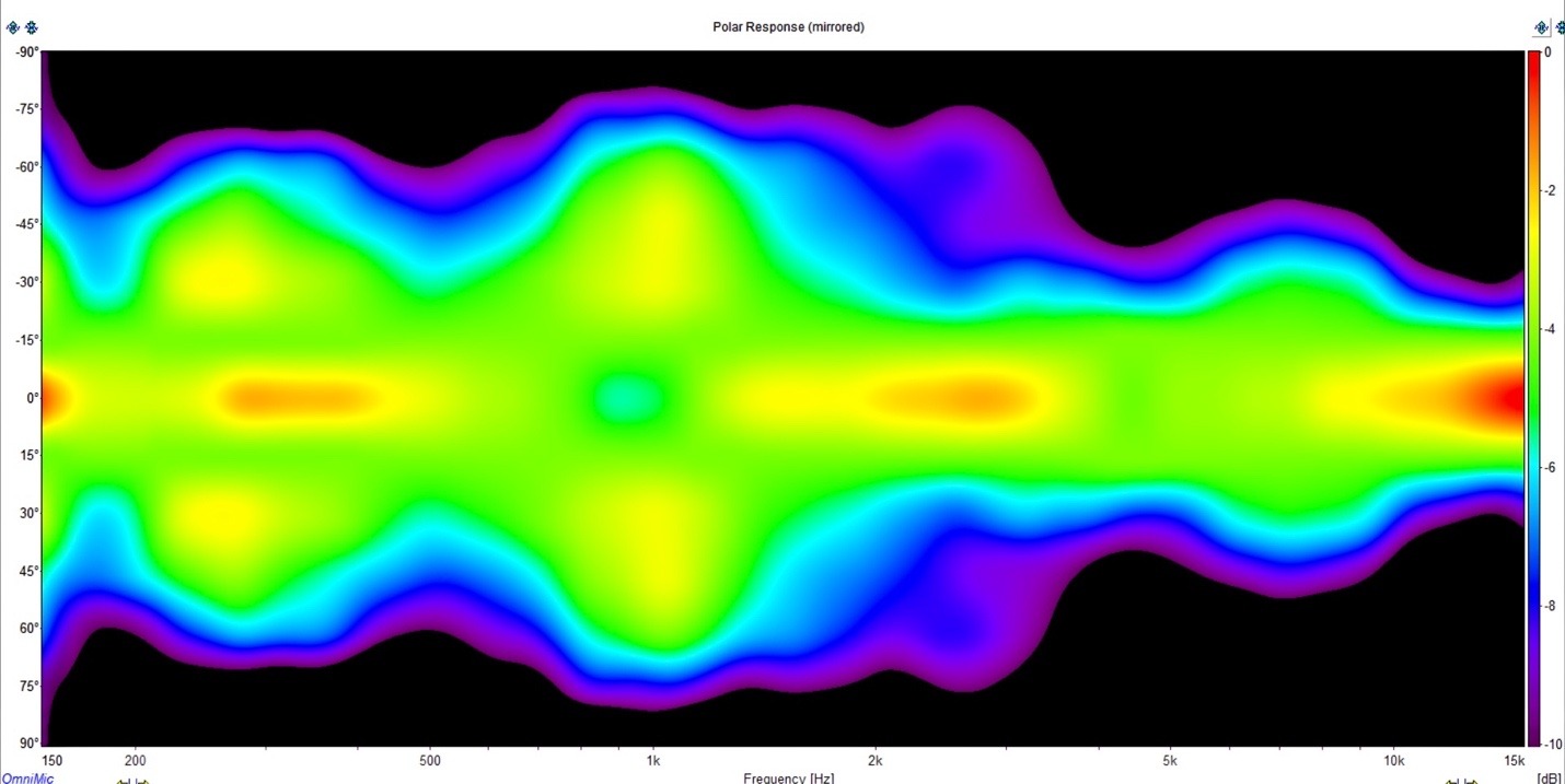

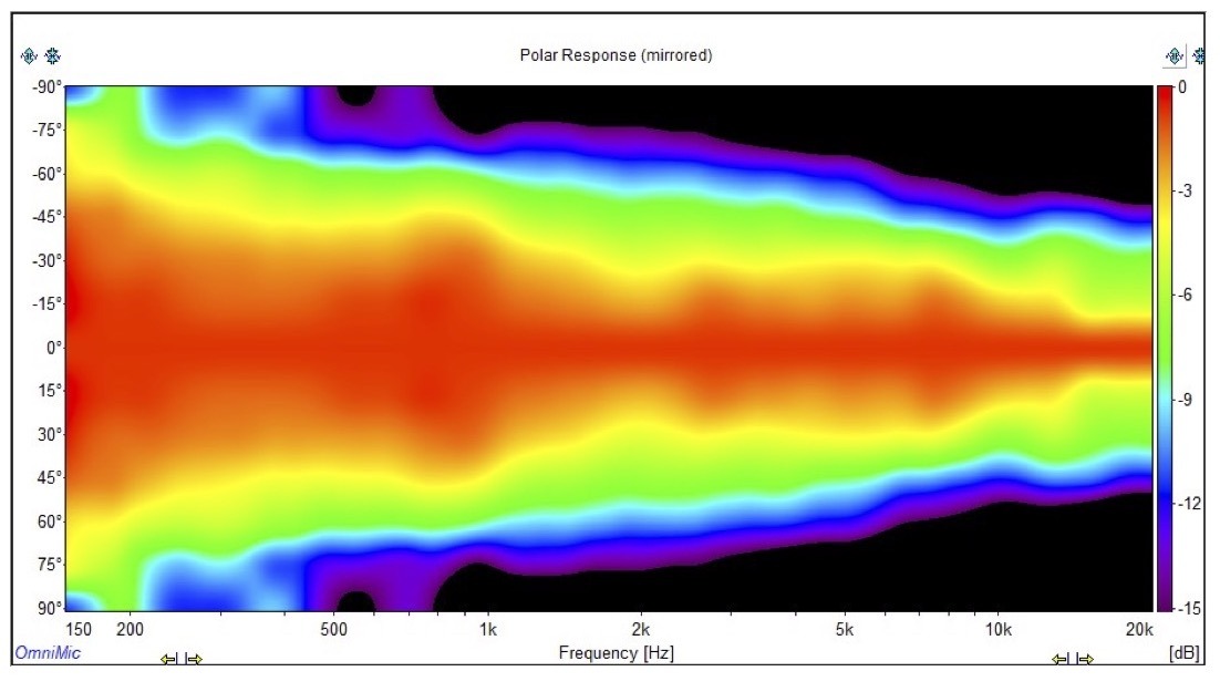

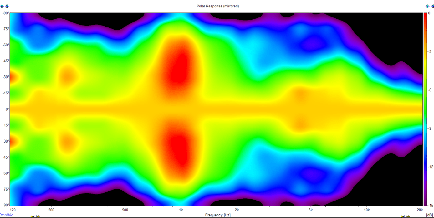

Polar Pattern Nuances
Below you see a somewhat different representation of the polar response. It calls extra attention to two lobes around 1000Hz where, off axis, the output is +2dB higher than on axis. Near the top of this article you see off-axis frequency response curves and they “bunch” a little bit near 1000Hz.
This is because the Radian 5208 is mounted in a baffle about 20” wide, which means between 500Hz and 1500Hz there is almost no rear cancellation reaching around from the other side. This causes some “bunching” of the off-axis frequency response curves around 1KHz.
The above polar plot accents mild hot spots at +/-30 degrees near 1KHz. This +2dB is the most trivial of problems; but if were the baffle pyramid shaped so as to be narrower at the top, ~12” wide, these regions would go away. It would also require a mild boost in the 120-700Hz range.

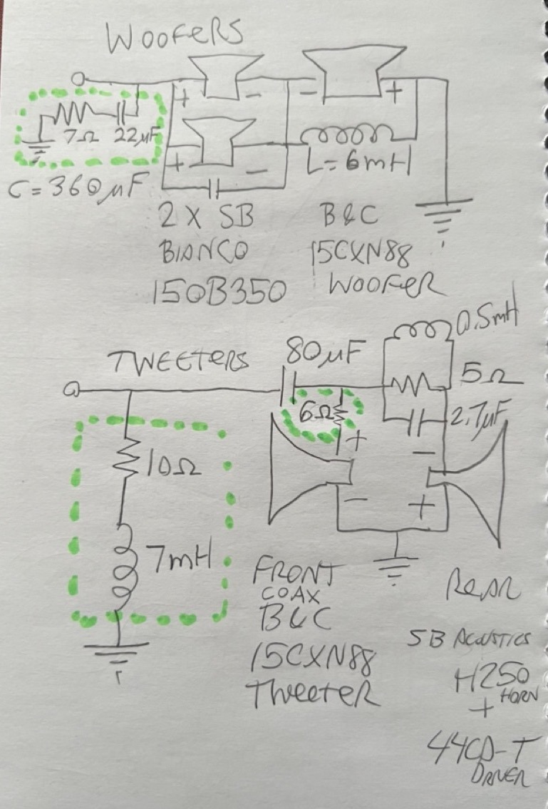

I use an identical format using different size drivers (2 x 15” subs + 15” coax with compression horn tweeter) in the Bitches Brew speakers https://tinyurl.com/bitches-brew-diyaudio. This config yields the most coherent top-to-bottom integrity of anything I’ve tested. One audiophile described it as “superb crisp sharp punchy detail, fully integrated like a chorus line all kicking in perfect unison.”
Because woofer and mid are wired in series, and mounted on the same baffle, there is no easy way to separate them. I said they cross at 200Hz, but there’s more to the story.

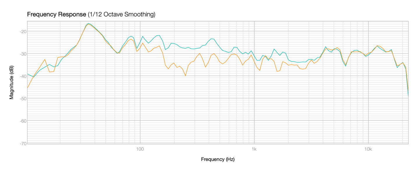

The graph below reveals why the 18” Eminence and 8” Radian blend so well. The blue curve is with the Radian midrange in the polarity shown on the schematic. The orange curve is with the Radian’s polarity opposite of the schematic.
With opposite polarity, the 18” and 8” cancel between 100Hz and 1000Hz, with the biggest null at about 250Hz. This means the two drivers produce nearly equal output across 2 octaves, from 150Hz to 600Hz. This is why they blend so seamlessly.
You can tell low frequencies come from the 18, but there is no obvious audible crossover. Both drivers behave well far outside their range. You have none of the disembodied mismatch that so often comes with subs and satellites.
The orange curve also has a null between 1.5KHz and 3KHz. This is where the Radian mid and Radian tweeter overlap. Because the 200Hz crossover is coherent and the mid crosses at 2KHz to a concentric tweeter, the sound is homogenous.
Above: Reversing polarity of the midrange illustrates reinforcement vs. cancellation between woofer, mid and tweeter.

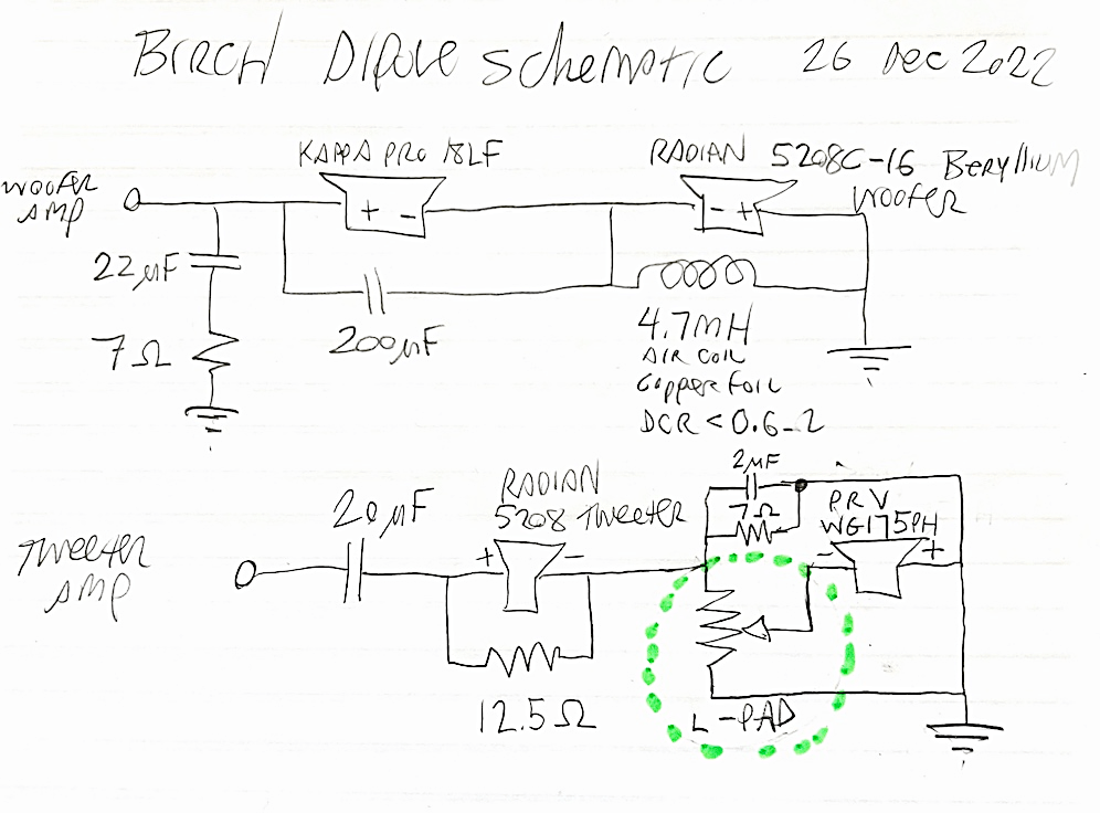

On the schematic you see a 22uF capacitor and 7-ohm resistor. This is a Zobel network which cancels the inductance of the woofer section. If you use a tube amp it minimizes interaction between speaker and amp.
The 18” Eminence subwoofer and 8” Radian midrange are wired in series, with a 200uF capacitor across the sub and a 4.7mH inductor across the midrange. The series wiring causes the impedance peaks of the drivers to work with my design goals. The impedance peak of the 18” woofer at resonance reduces the signal received by the midrange at that frequency. A standard parallel crossover would do the exact opposite.
The inductors (see photo) are low-DCR copper foil units from Madisound. DC Resistance is 0.6 ohm. DCR must be low because the only protection the midrange has from low bass (which has 20dB boost at 30Hz) is low resistance for the inductor in parallel with it. I don’t recommend iron core inductors because they have hysteresis distortion.
This 6dB SERIES (not parallel!) filter is the only crossover between woofer and mid, which is why the blend between the drivers is seamless. 3-way speakers are extremely hard to get right and this is one of the aspects I’m especially proud of.
The midrange is wired in reverse polarity from the woofer. It is in this configuration that the two are most tightly in phase with each other. FIR filter in the DSP corrects global phase and makes the phase response of the speaker flat. A similar filter corrects time errors on the tweeter.

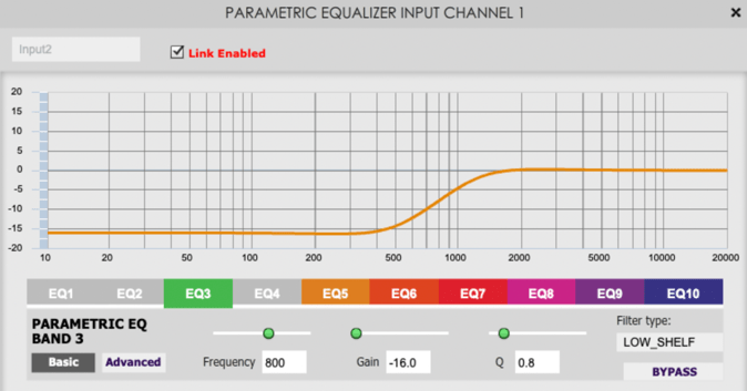

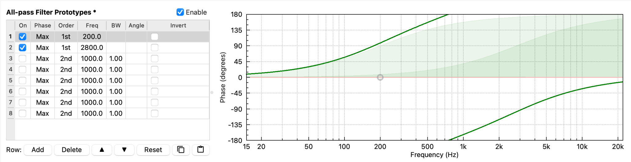

Shelf filters: Less phase shift than Low Pass & High Pass filters

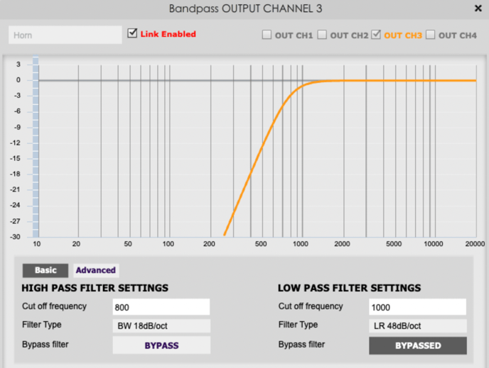

On the left is an 18dB per octave MiniDSP high pass filter at 800Hz, which adds 270 degrees of phase shift below 400Hz. On the right is a 16dB shelf filter, which introduces a maximum of 135 degrees of phase shift at 800Hz, and zero phase shift at low frequencies.
The two filters are obviously very different and serve different purposes. But any time I can get away with using a shelf or notch instead of high- or low-pass filter, I’ll take it every time. If you study my original Birch Dipole writeup from 2020 at
http://www.tinyurl.com/liveedgedipoles
…you can see this preference in the crossover design, which I explain in detail. The place I use this the most is woofers. Most of the time you have to tame peaks at the top end of the woofer’s range. If you do it with notch or shelf filters instead of low pass filters, you cut the phase shift in half, impulse and step response improve, there is less group delay and the system sounds more natural. I do this not only with DSP but also in traditional passive crossovers.
The only traditional crossover slope in the DSP is an 18dB/octave high pass filter at 800Hz protecting the tweeters from low frequencies. I kept it well away from the 2KHz crossover frequency to minimize phase shift. The rest of the EQ was done with shelf filters. This left fewer problems for the Finite Impulse Response filters to solve.

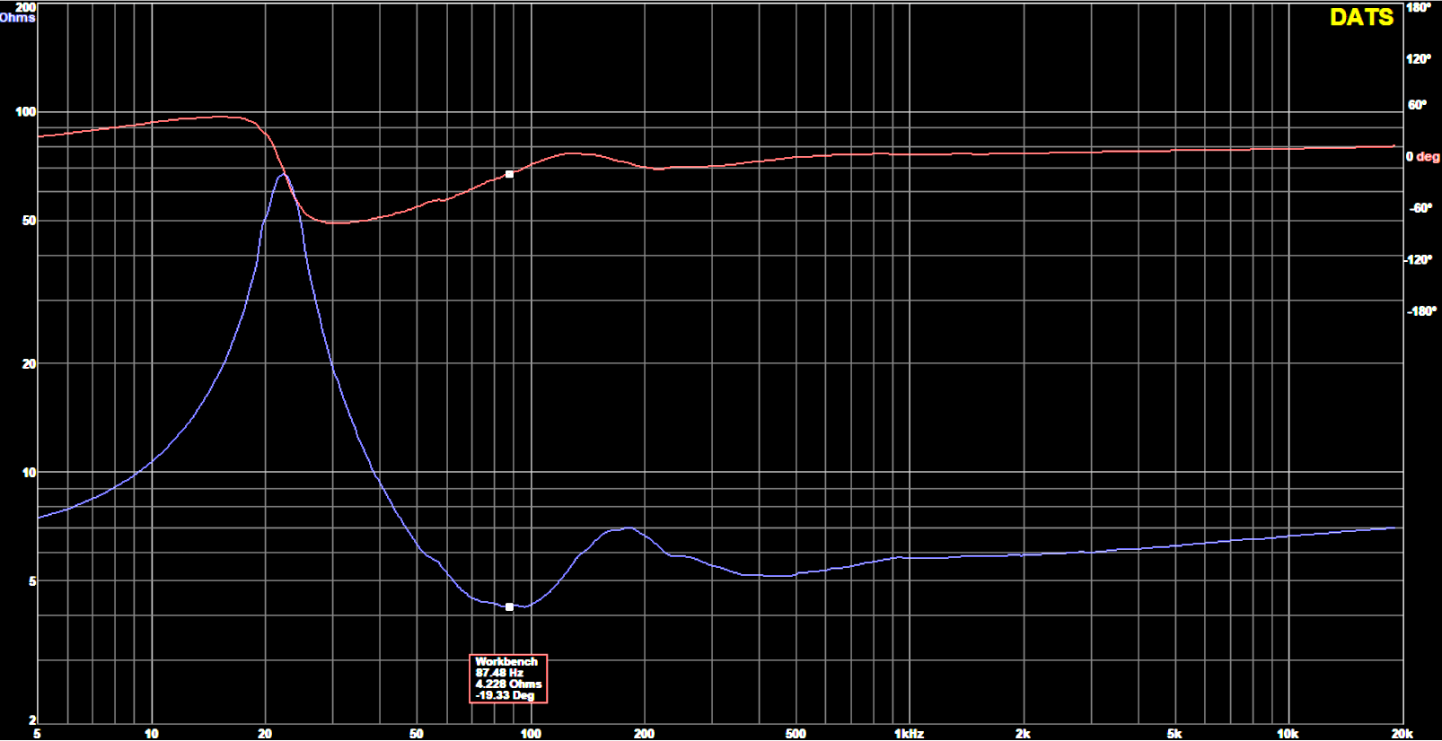

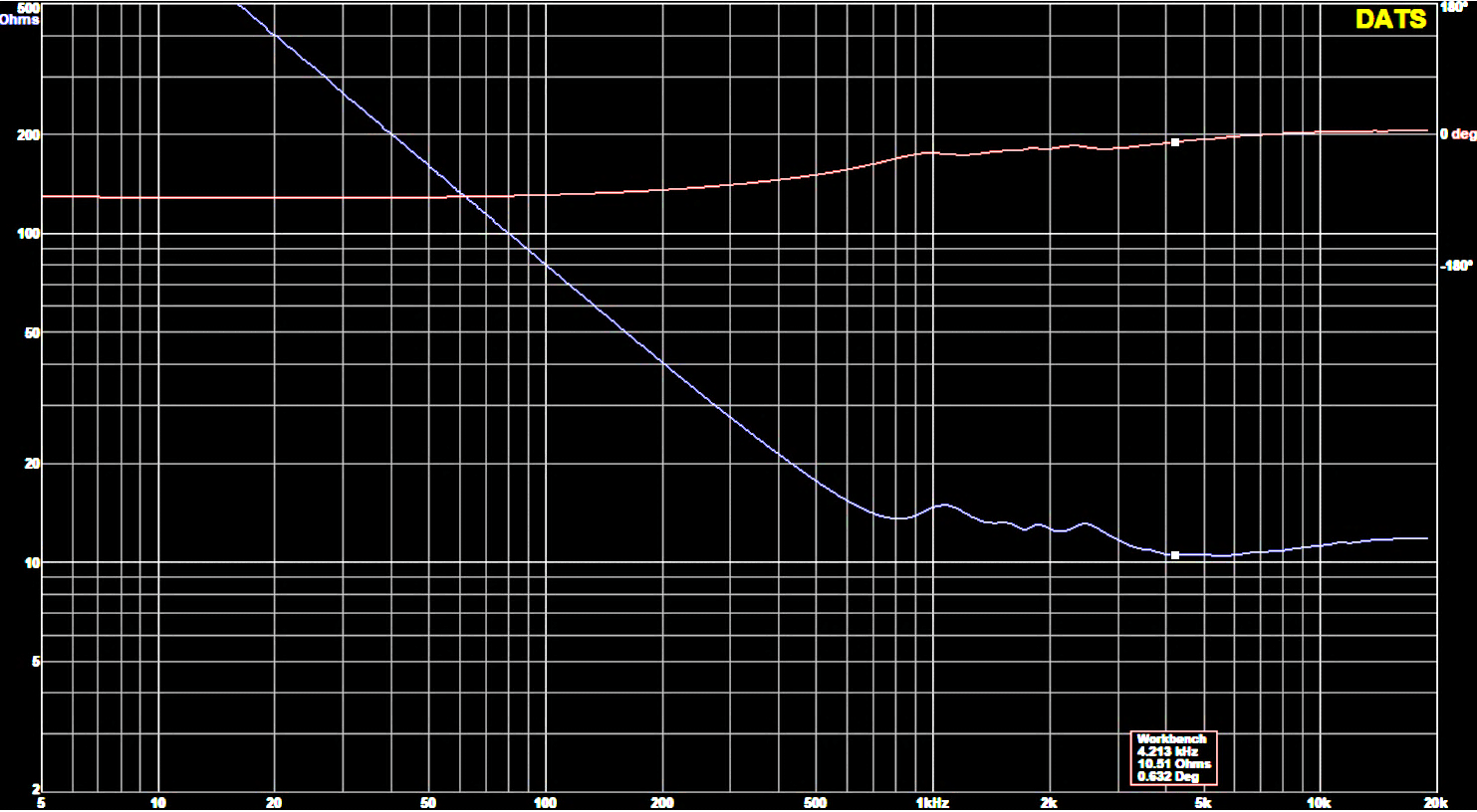

Easy Impedance
Above: Impedance curve of Eminence 18” Woofer + Radian 8” Midrange section. Resonance 22Hz, Qt = 0.5. Average 6 ohms, minimum 4.3 ohms at 60Hz. Load is largely resistive. Phase angle is in red. Easy to drive.
Above: Tweeter section impedance curve. 11 ohms, super easy to drive, especially for small tube amps. Phase angle is at the top.
Construction
I commissioned Seth Cothron in Chicago to build the cabinets (instagram.com/studio38designs and he’s very skilled and easy to work with). All I gave him was some sketch drawings and circles drawn on the wood:

MiniDSP Flex Eight
The MiniDSP Flex Eight offers 8 channels instead of 4 with significantly lower noise, with some other features compared to the 2x4HD. The 2x4HD has separate FIR taps on each output channel, which I take full advantage of in the Birch Dipole design. But the Flex Eight has only two FIR taps – only on the main input channels. This requires a different strategy.
Below you see the final acoustic output of the drivers using the Flex Eight DSP. I attempted to get as close as I could to a low-Q, well-behaved 12dB/octave acoustic slope from both woofer and tweeter, using almost entirely peak filters and shelf filters. Acoustically, it behaves approximately like a three-way system with 12dB/octave acoustic slopes on every driver.
Above: Woofer+Bass mid acoustic output (blue); tweeter output (red).
Above:
IIR Digital EQ curves, as programmed into the Flex Eight. Also has a 6dB per octave high pass filter on the tweeter at 600Hz not shown here. Most of the heavy lifting is done by shelf filters, which have less phase shift. A 0.26msec delay aligns midrange with tweeter.
Before FIR correction, the system has 360 degrees total phase shift between 50Hz and 15KHz. Two very simple 1st order maxphase FIR slopes, below, made with Eclipse FIR Designer, reverse this:
Step response (below left) is excellent. Phase response is +/-30 degrees across 9 octaves, below right:
You can download the MiniDSP Flex Eight files at https://tinyurl.com/birchdipoleflex8

A Pair of Your Own
I recommend you visit to a lumber store that carries live edge wood and pick out a couple of slabs that call out your name. You’ll be the only person on earth with speakers that look like that.
Order the parts and thus has your adventure begun.

There is a reason they make violins out of one material and not another. The wood makes a difference but I can't tell you exactly how. In general with a speaker, the more dense, hard and heavy the wood, the better. However you will notice that I did not choose dense woods for my builds. I picked out what was beautiful and available at the lumber store. Oak and Ash are dense woods.
I would love to do one of these speakers using marble or granite instead of wood. Maybe someone on the forum will try that.
The shape of the baffle does make a difference. If you study the Live Edge Dipoles above you will see that there is some "bunching" in the polar pattern around 1KHz (see below), and in the heat map you see two yellow hot spots at +/-40 degrees. That's because the baffle is about 20" wide and the midrange is only 8" wide.
@CharlieLaub has written about this extensively. He calls it a "minimally baffled dipole" in recent articles in AudioXpress discussed here:
https://www.diyaudio.com/community/threads/charlielaub-ob-article-in-audioxpress-sept-2023.402166/

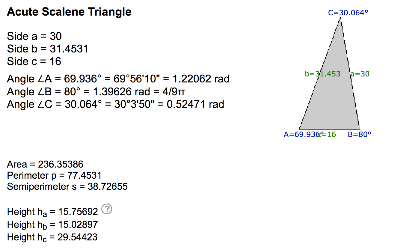

The way you sidestep that problem in Live Edge Dipoles is you cut the cabinet so it tapers from 22" wide at the bottom down to 10-12" wide at the top. Then that bunching will disappear. You will also get less obstruction of reflections from the rear wall. (You will also have to trim down a piece of live edge wood and it may not look as natural.) That will also require you to adjust the DSP and boost frequencies between 120Hz and 700Hz a few extra decibels, because you'll get some baffle loss.
The Bitches Brews do not have that problem because the midwoofer is 15" and the baffle is 20", only a little wider. That's why if you look closely the Bitches Brew polar pattern does not have any of the "bunching" that the Live Edge Dipoles have. Then by having U-frame "lambda wings" to extend the bass, along with a 100Hz crossover, I manage to make the speaker dipole across the entire range while still having a minimally baffled 15" coaxial bass mid.
Think of it as a pyramid shaped baffle where the bottom of the pyramid wraps around the side. That pushes the dipole loss cancellation down to below 50Hz, which buys you about +6dB to +8dB more bass.
Here are the graphs for comparison.
Live Edge Dipoles:
Bitches Brew:

@perrymarshall so you would change the tilt of the Bitches Brew to 5 degree. Change anything else like the wings (bunching around 100Hz) [shape, parallel] or stay the same with 5 degree? Or change anything else?
Very nice speaker designs!
I would change the tilt from 10 degrees backwards to 5 degrees backwards.
I would not change anything else about the cabinet or the structure.
MiniDSP 2x4HD files: https://tinyurl.com/bitchesbrewdsp
MiniDSP Flex Eight files: https://tinyurl.com/bitches-brew-dsp-flex8
This is the current schematic:
Regarding "bunching" at 100Hz: I'm not confident in the measurements that show it, mostly because it's in a 12' x 14' room and I have a suspicion that a different microphone position would make those go away. It may not be real.
What I can say is that if you're concerned about it, build it as a 3 way triamped active system, because if you play with the crossover points and slopes you will get rid of it. Taken at face value, the problem might disappear if you moved the crossover from 100Hz down to 70Hz. It would stress the bass mid a bit more but I don't think that's a problem.
