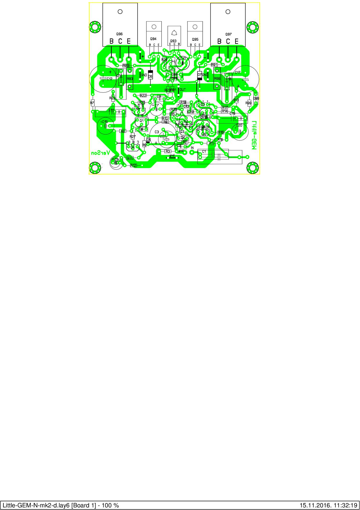

I'm reviving this thread about Dadod's very interesting amp which I've thought seriously about several times, following his comments about its sound quality. We are both old enough to know that our hearing is no longer ideal so I tend to regard claims about SQ with suspicion but in this case, I am going to get around to building it for myself - when the bench is clear of junk, at least .
Apart from needing a mask of the PCB pattern, a parts issue that I have regards the SMD depletion mosfet for C7, the bootstrap capacitor. I'd like to use a common thru-hole DN2530 type and I assume it will be ok but would like to check whether adjustments are needed.
Also, since it wasn't discussed as far as I could see, would you like to explain the mosfet operation and need here?

No idea at this point, Luke. ' just clearing any obstacles first.....are you etching or getting boards made?

The mosfet operation (depletion mode) was discussed in mine other thread. It is just CCS and it gives combination of CCS and bootstrap VAS, and I never saw anything similar used before.
If you like to build this amp here is last layout in pdf. In my prototype I used older layout, so it needs check and you can change mosfet from TO220 to TO92 type.
Damir

Thanks Dadod, for your quick reply and helpful post of the latest PCB layout
If others are tempted to etch some extra boards or have a economical number made and share the cost, please post your interest.
Ian, you have PM.
