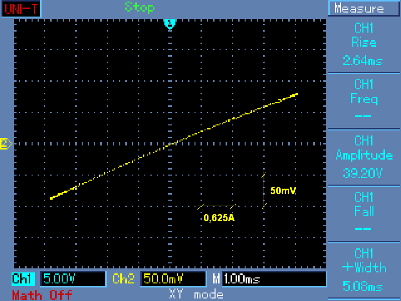

Another straightforward method to measure output impedance is an X-Y plot. X axis is a driving channel output voltage, it is injected as a current through 8 ohm resistor to the tested channel, and the tested channel output voltage is plotted on Y axis. It shows output impedance non-linearity quite well.
I will try to find some older measurements of more 'conventional' amplifiers.
In this example ratio of 50mv/10v x load =0.04ohms. Is this correct?
Perfect little oval represents phase angle. This would be do to propagation delay, and reactive elements in signal path through feedback network and amplifier stage(s) of DUT.
I assume input of DUT is tied to ground?
What about reference? How about bridge approach? Both amplifiers with same input signal, and identical loads connected at measurement point referenced to ground. And reference of measurement of driving amplifier with load to ground.
Voltage drop across output, no load v loaded ratio with purely resistive load seems most straight forward. Why isn't this a good approach?
Well, X axis is the driving amplifier output. You may see 40Vp amplitude. This 40V injects through 8 ohm resistor current of 5A to the measured channel (40/8). 5A makes a 150mV voltage drop on Y axis. 150mV/5A = output impedance of measured channel is 0.03 ohms.
Ellipse reflects phase shift of the output impedance. This output impedance is like R + jwL. L is an inductance of wire from PCB to binding post at the rear panel + amplifier output inductance (this amp does not use an output coil). For 10kHz, you get 'broader' ellipse. For very low frequency, you get almost straight line, if the amplifier output impedance is not very non-linear.
Output load is referred to ground.
Another measurement, with low frequency, quasi-static. The resulting output impedance is again 0.03 ohms (0.075V/2.5A).

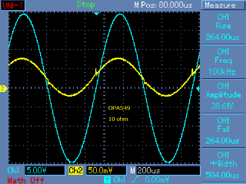

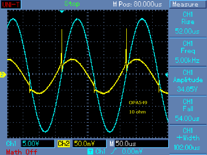

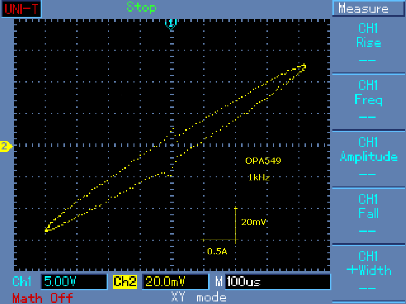

Some more mesurements on OPA549 output impedance. Current injected through 10 ohm resistor. Measurements show behavior of low biased output stage (probably quasi-complementary?) and low slew rate, at 1kHz and 5kHz. Cross-over behavior at low amplitudes is clearly demonstrated.
5kHz, in time domain. Such behavior leads to 'different' sound.
Edit: added measurement at smaller amplitude. For smaller amplitudes, nasty behavior dominates and output impedance is totally non-linear.
Hi Pavel, nice measurements information, thank you.5kHz, in time domain. Such behavior leads to 'different' sound.
Thank you Pavel for proving that components and their choice thereof matter a great deal. I could immediately see from the distortion trace that this opamp is having a badly designed asymetric output stage (difference in negative and positive slope!) and what you see is typical crossover distortion that you will always hear in the output. No amount of feedback will get rid of it. Even a perfect power output stage will be fed with this pre-distorted signal, so you basically amplify a small problem into a very big one. You can compensate by using feedback but the entire feedback loop behaviour will jump eratic near the crossover points to try and compensate this. Having a limited slewrate to make matters worse, this is an unusable opamp for any audio design and probably for ANY other application too.<br><br>
Dan, I would suggest you are right that the microfonic feedback will define sonic differences, but I would expect that to be dependent of the way the amplifier handles this return-signal. If the amp has not enough damping or this signal is managing to get into the amplifier feedback loop, then this return-signal will be amplified into the signal input chain by way of the feedback into the input differential amp. That definitly is going to affect sound as now an external feedback signal is mixed back into the original source signal. NOT good!
And you are on my line of thoughts when you say that this defines the type of amp because as I said before, a badly designed amp will exibit this behaviour if it is a class-B amp output. A class-A will not have this effect EXCEPT if the bad opamp that PAVEL has tested is used in the pre-stage because even a class-A output stage will simply amplify the distored output of the opamp.<br><br>
It cannot be better illustrated that quality of the component design is of prime importance and the tests of Pavel show how important it is that components should be tested and evaluated. The perfect op-amp is NOT perfect most of the times. It is probably also the reason why people prefer some opamp (like the opa2134) over another and why there is a limited number of sonically accepted reference op-amps like the OPA2134 or the venerable 5534.
<br><br>
The tests of Pavel have set the OPA549 on my blacklist. Thanks Pavel. Good info for me!<br><br>

Luc, we need to emphasize one fact here. The OPA549 is a power chip amplifier with output current up to 10A. Idle current is about 30mA only and output is most probably quasi-complementary. The bad behavior I have shown happens only if it is used as a power amplifier, with output stage deep in class B because of low load impedance. If it was used as a pre-stage, with negligible load, cross-over nastiness would not be present. But, then noise and low slew rate 9V/us of OPA549 should be taken into account. So, please let's not compare OPA2134 or NE5534 with OPA549, they are dedicated to very different amplifying purposes.
Hi Pavel,
Thanks for clarifying that.... I was about to write a question to you about your testing methods. I wondered if you had forgotten de micro before the A (so micro-amperes) not realising that you were testing a power opamp! I did not lookup the data about the opa549 at the time of my reaction. Carelessness that in a funny way bites me back... I stand corrected about that... I did not contemplate the use of poweramps so did not realise you were testing one of those. I do not use them myself. I only use the normal style opamps and discrete component power stages and that is reminiscent of the days when I had a Luxman C03 preamp and M03 poweramp. Today they would be considered dated (also the sound I guess) but at the time they cost a fortune and they were the best I ever got my hands on. They did great service for about 20 years!
Nevertheless, the op549 device is now on a double blacklist on the poweramp-list and the avoid-list. As your tests have demonstrated, the device is not well conceived for audiophile use. I now looked at the datasheet and the bias-current drops even under 25 mA if the chip heats up over 75 deg C... So if you do a load test or use the device with too little cooling, then the test-result you have got is easily explained. But that is obvious to you of course... sorry.
My rant about components still holds then : measure before use! So I think it is great that you do this! And Dan is very much on the trace of why there is such a thing like sonic signature and what influences that. It certainly deserves further investigation. For me, I have a big aversion against big inductors in the speaker cross-over. I am researching the concept that their back-emf behaviour is the main culprit where it starts to act together with the cable and the speaker in a sort of resonant circuit. So I am now building several normal speakers and an active one to see where the differences are, if any of course.

Yes, OPA549 is not a good part for audio. It has only 900kHz GBW so the distortion rises at higher frequencies even for a moderate load, where cross-over distortion does not dominate.
This thread is about power amplifiers possible sound differences. OPA549 is the power opamp and it was used as an example of the possible problems with output stages. You will also find measurements of a discrete, high power amplifier in this thread. I know it is boring, but individual posts do not make much sense if they are brought out of the context.
