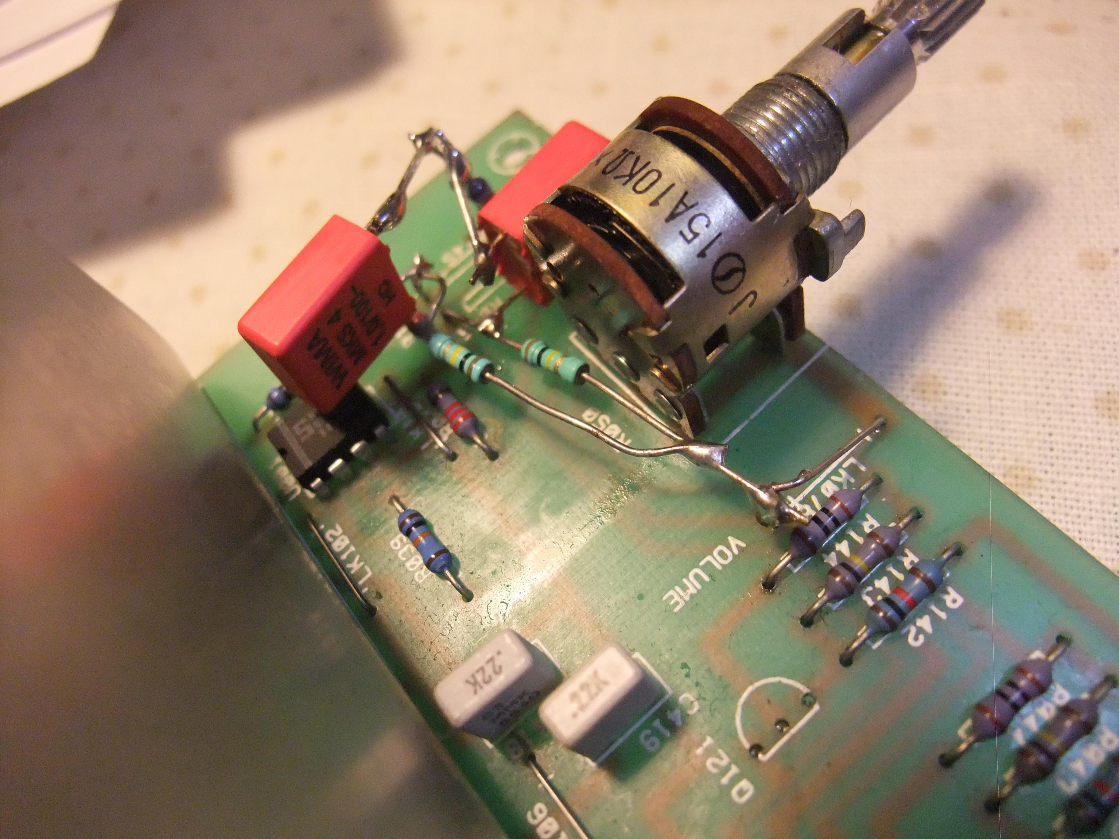

Linn Intek Schematic required
Any chance of getting the Intek schematic from some genteleman on here? :)
I have exactly the same problem as described by tiefbassuebertrager on page three:
This causes extremly cracking while rotate the volume control, even by use of a new variable resistor therefore

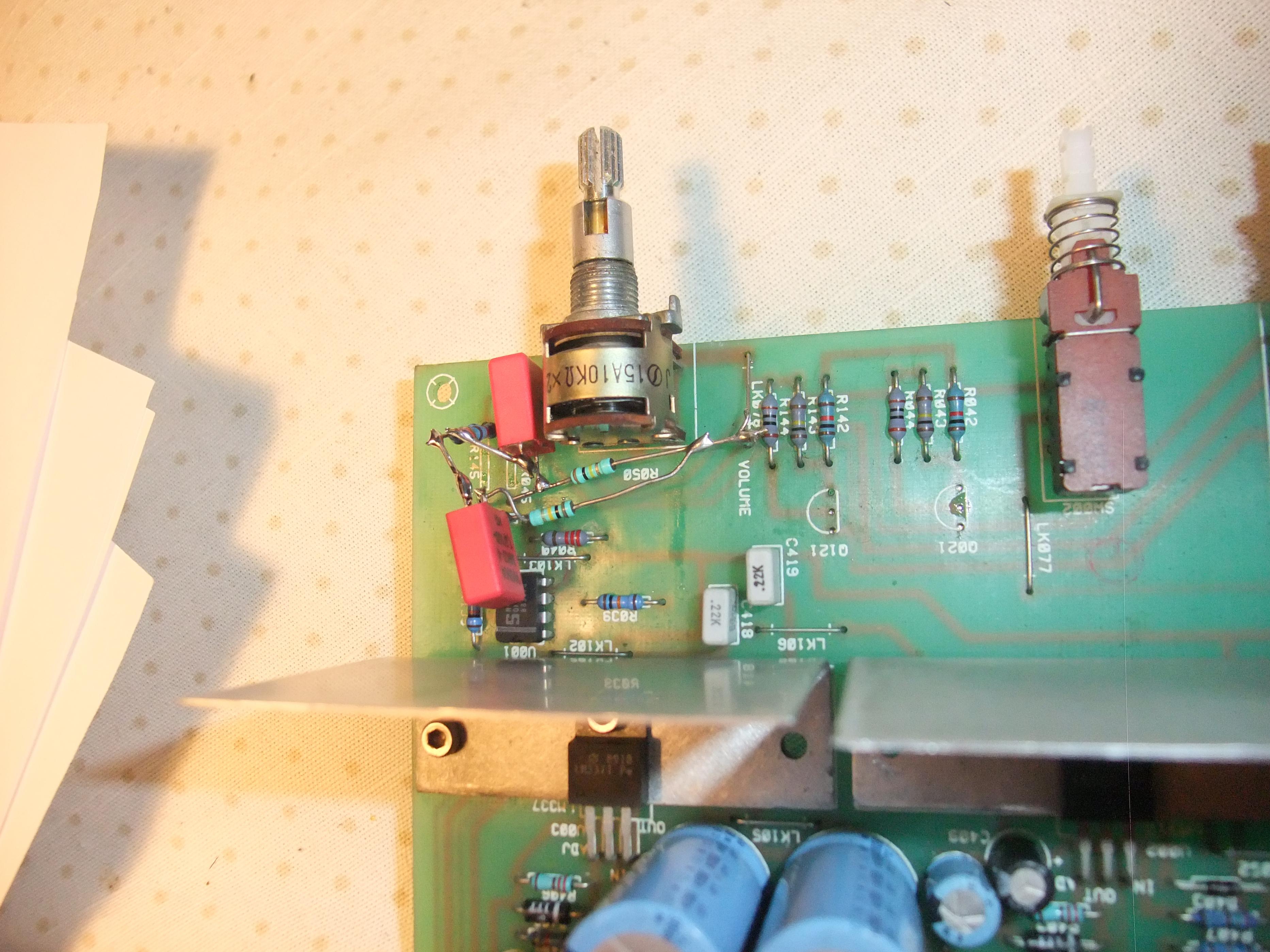

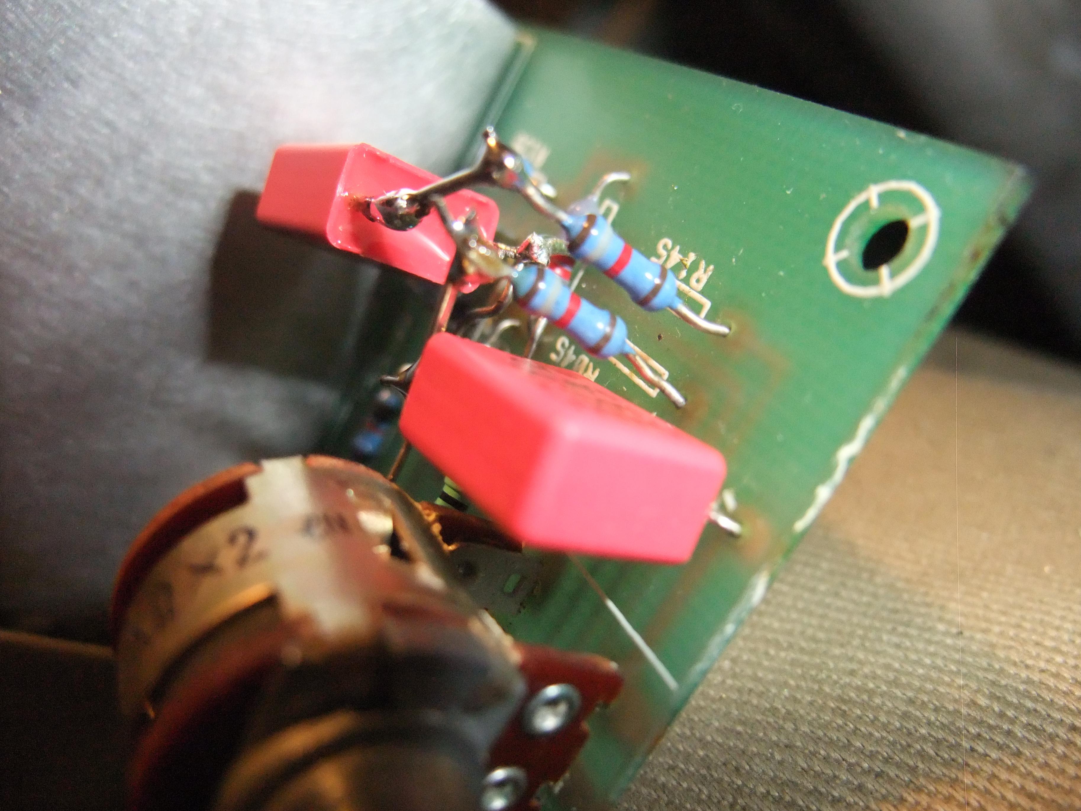

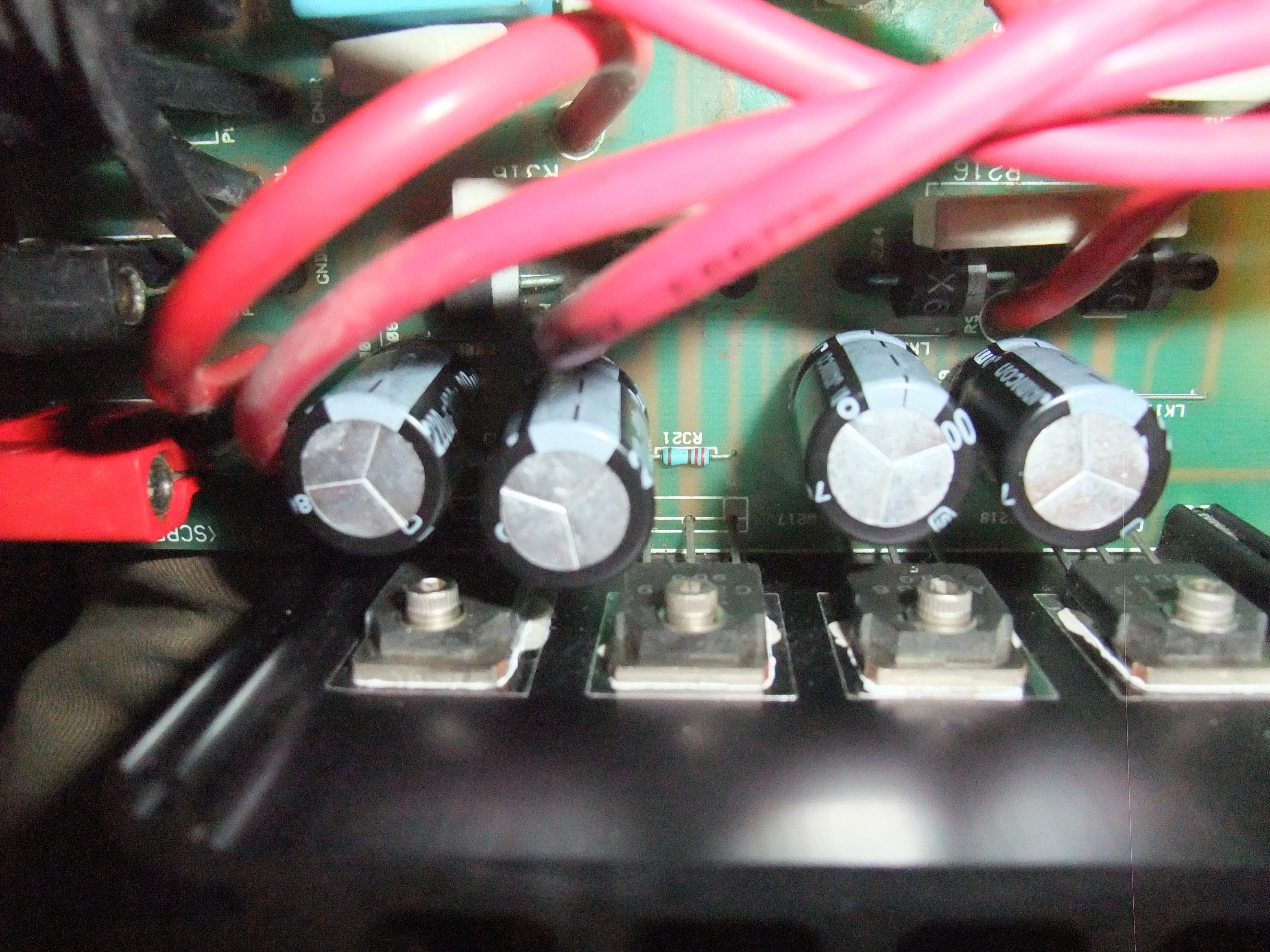

Thank you for your help Andreas, I followed your instructions successfully! The left channel still has a very faint crackle when I adjust levels, but it's hardly perceivable. :)
Squeezing the big capacitors in required some creative thinking though :D
I ended up de-soldering one leg of R45/R145, and glued the capacitors to the heat sink with hot glue. The capacitors legs were just the right size to be directly soldered to the previously desoldered legs of R45/R145. :cool:

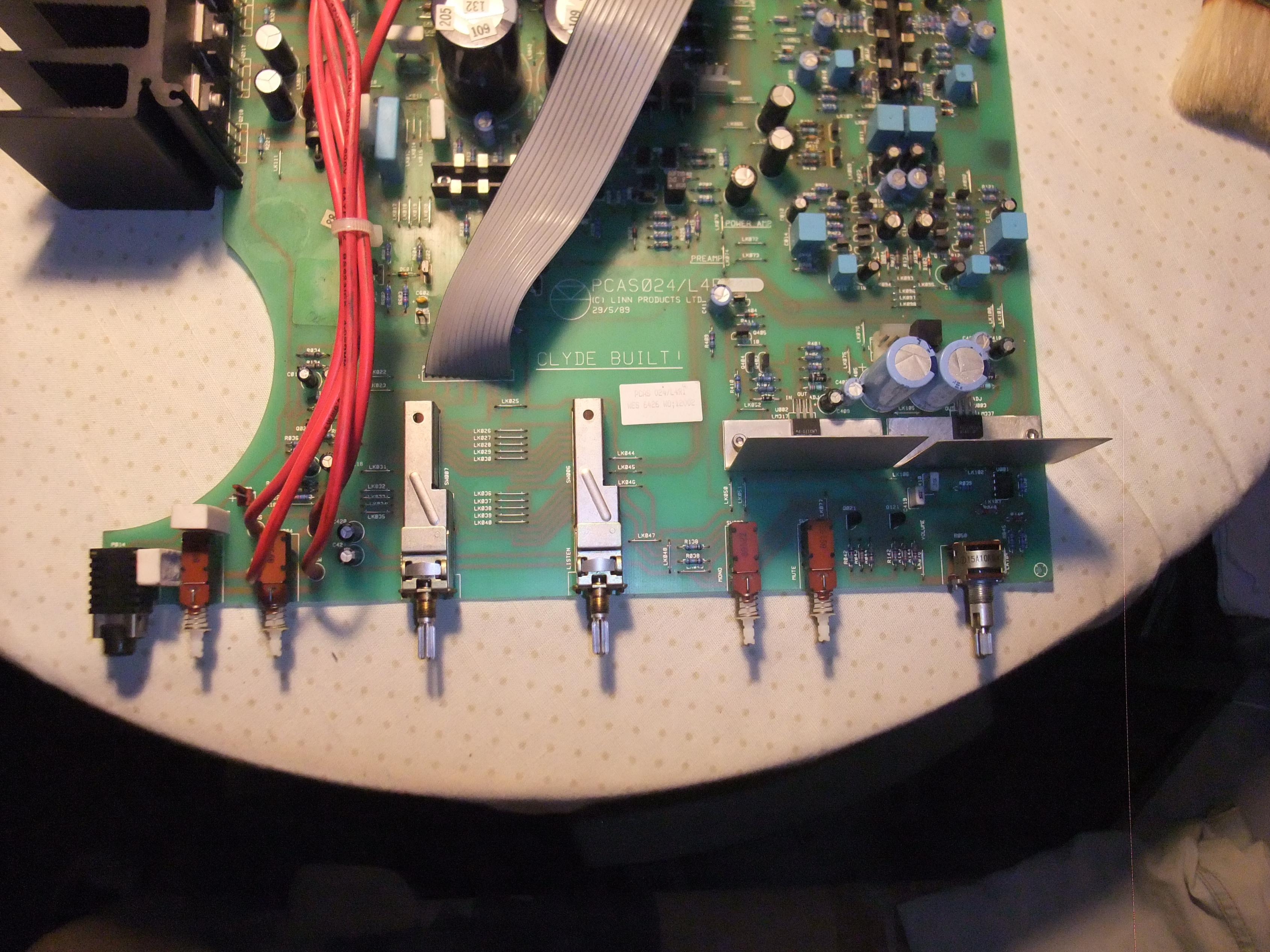

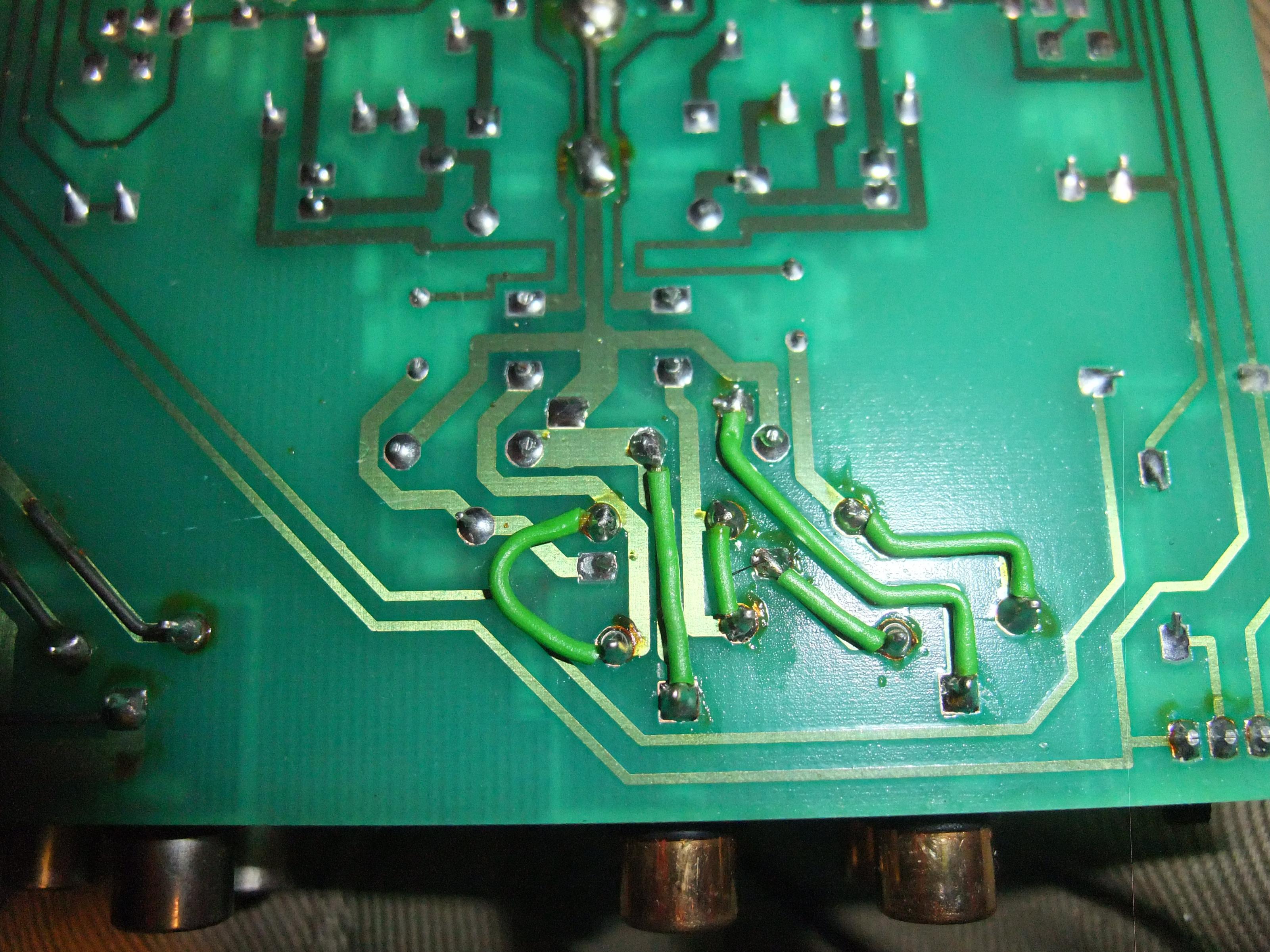

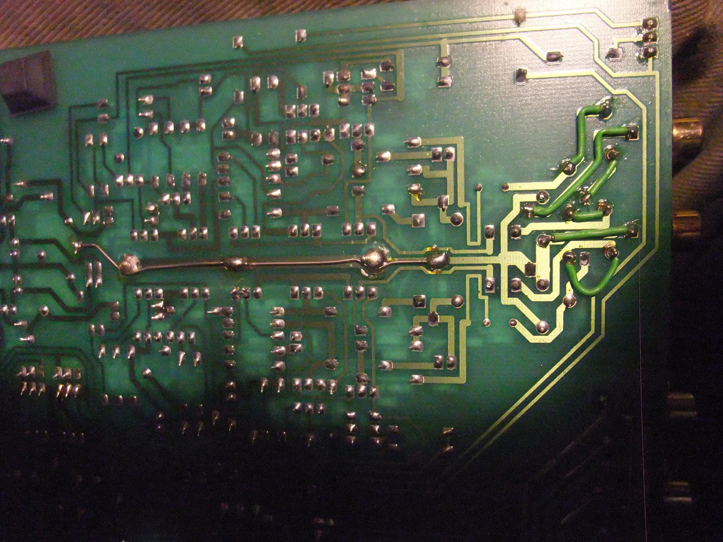

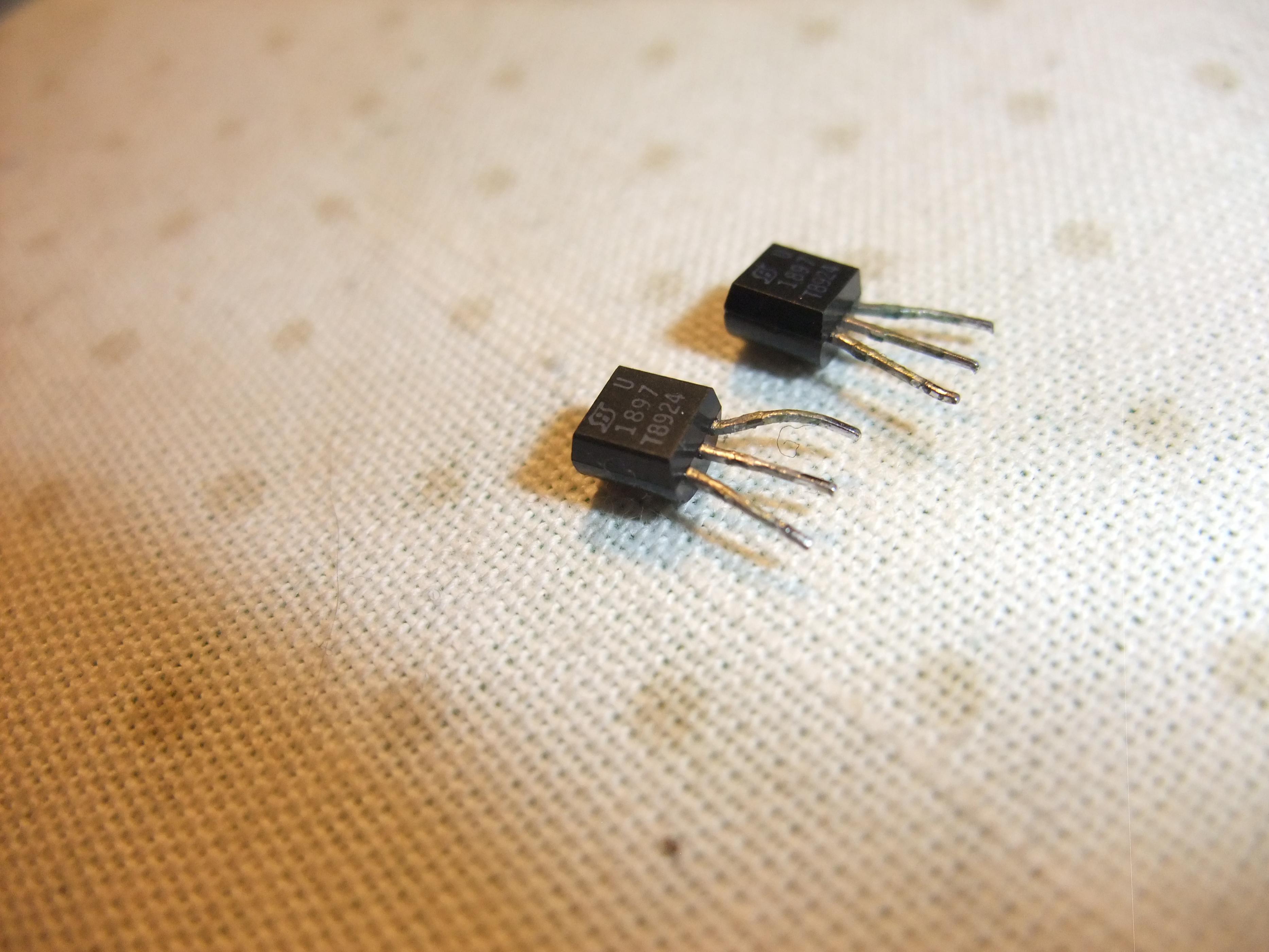

I have get a Linn Intek with extremly crackling on both channels while turning the attenuator knob. Cleaning don't remove this annoying noise.
in post #29 there is a PDF attachment for the MM/MC RIAA section.
On last page of PDF is to find the schematic of the line preamp section (NE5532 is in use) include volume control and include the associated modification hints.

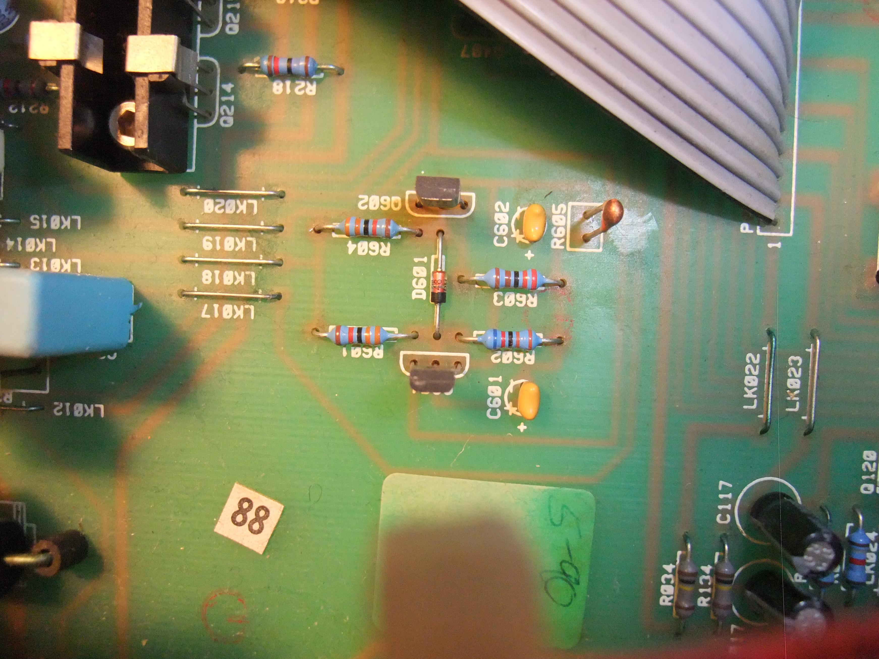

Additional I removed the jFET's for MUTE control
After performing this steps the amplifier works now without the above mentioned unwanted occurring crackling. Check also out the first five attached images

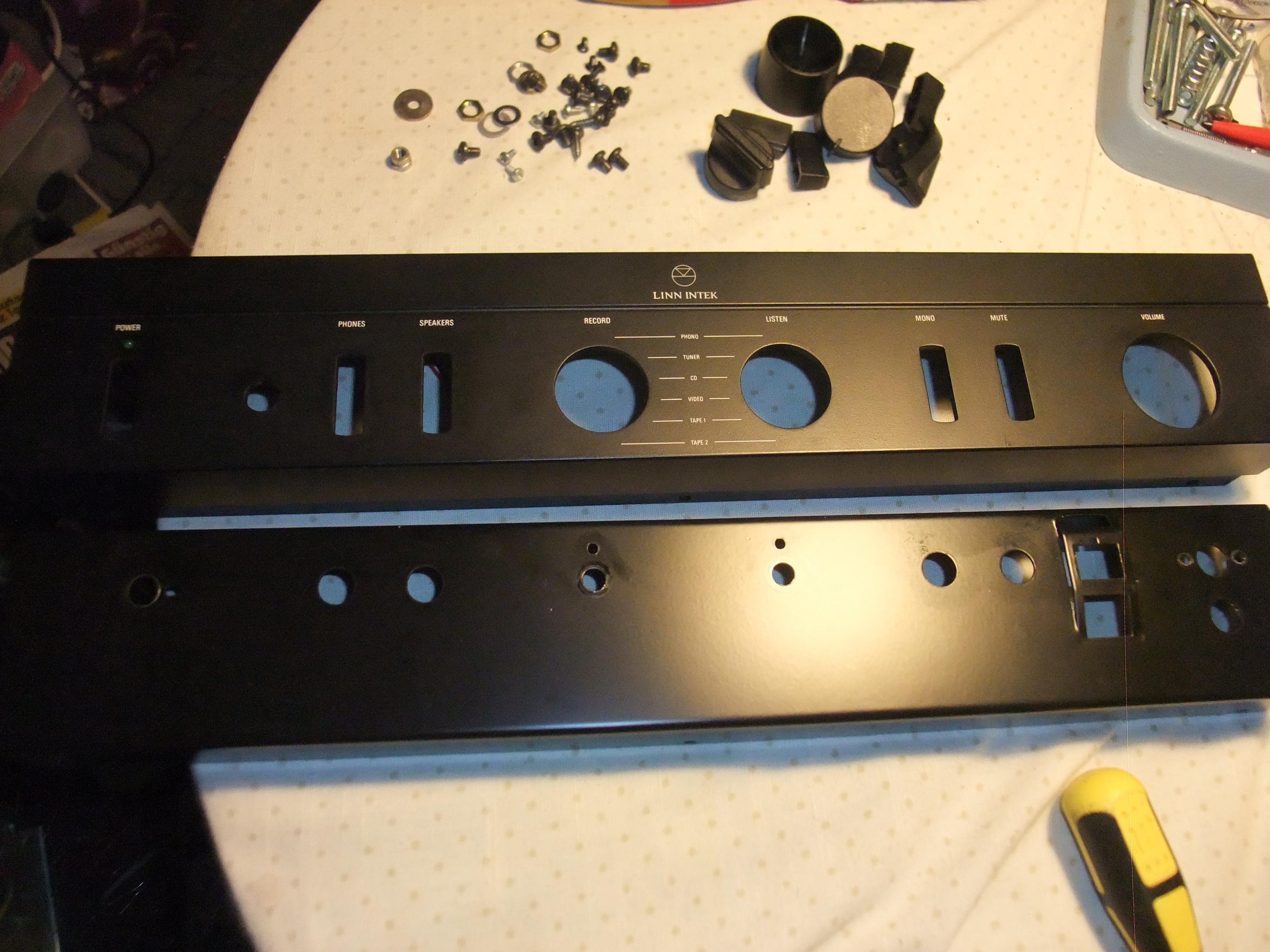

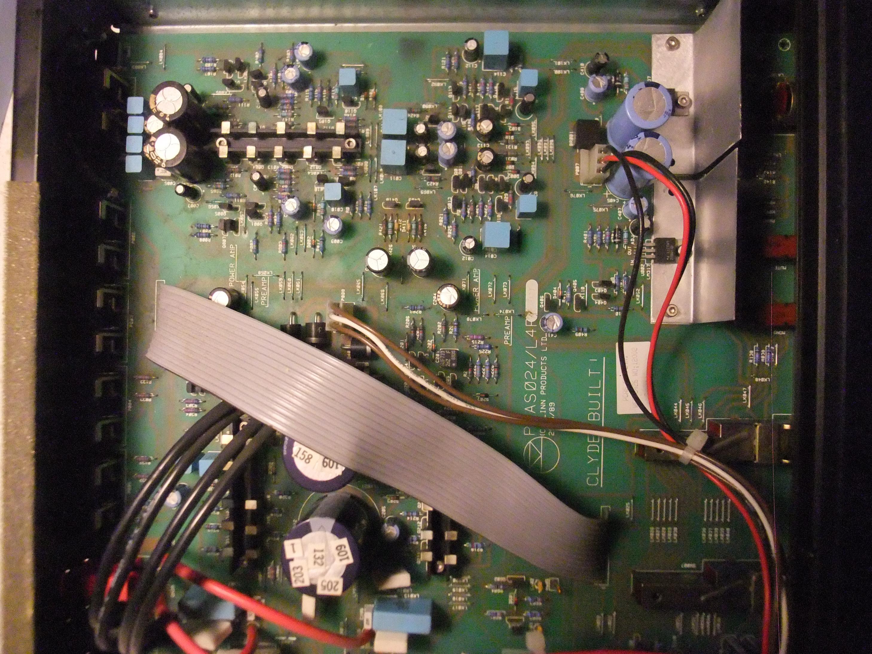

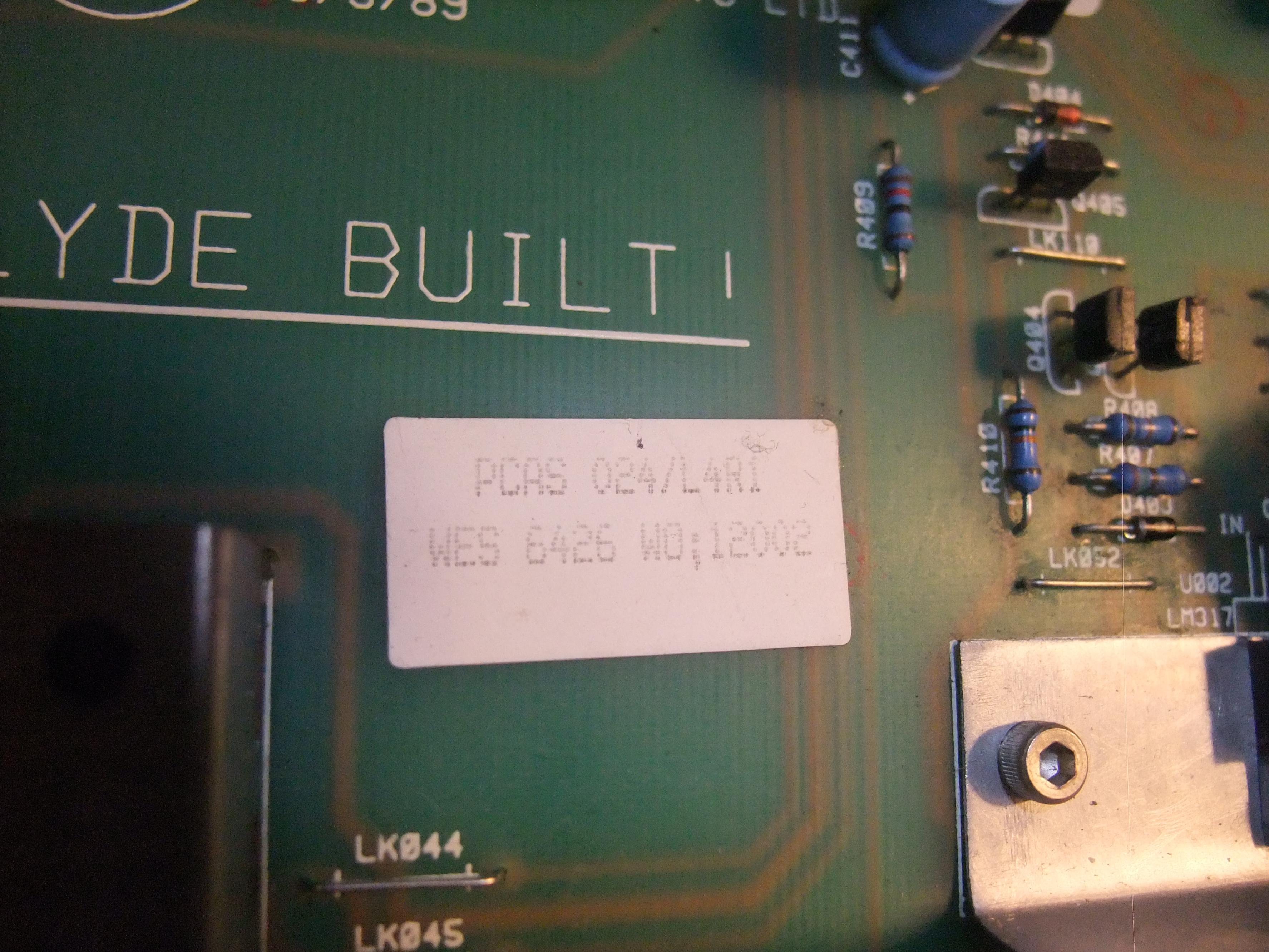

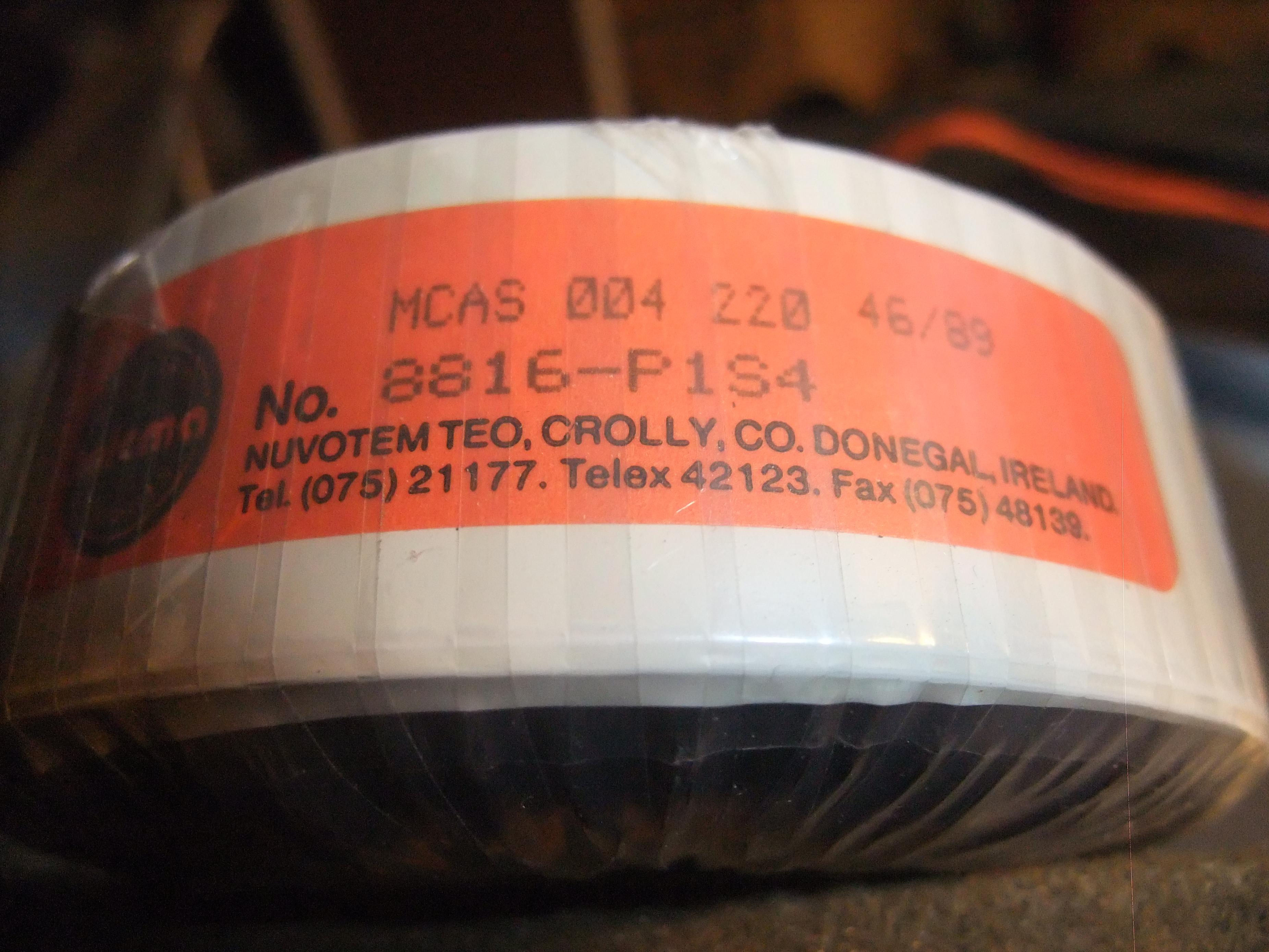

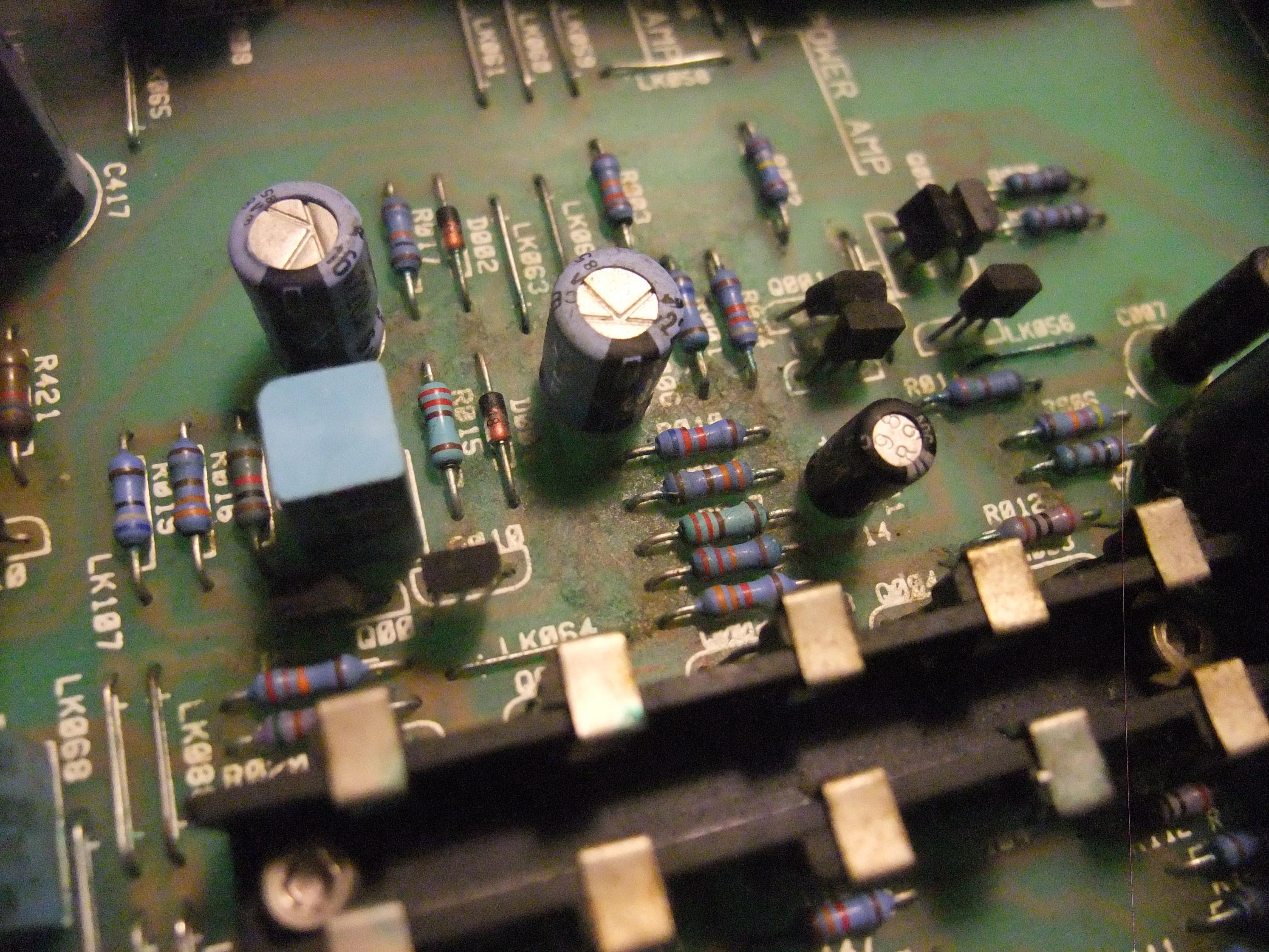

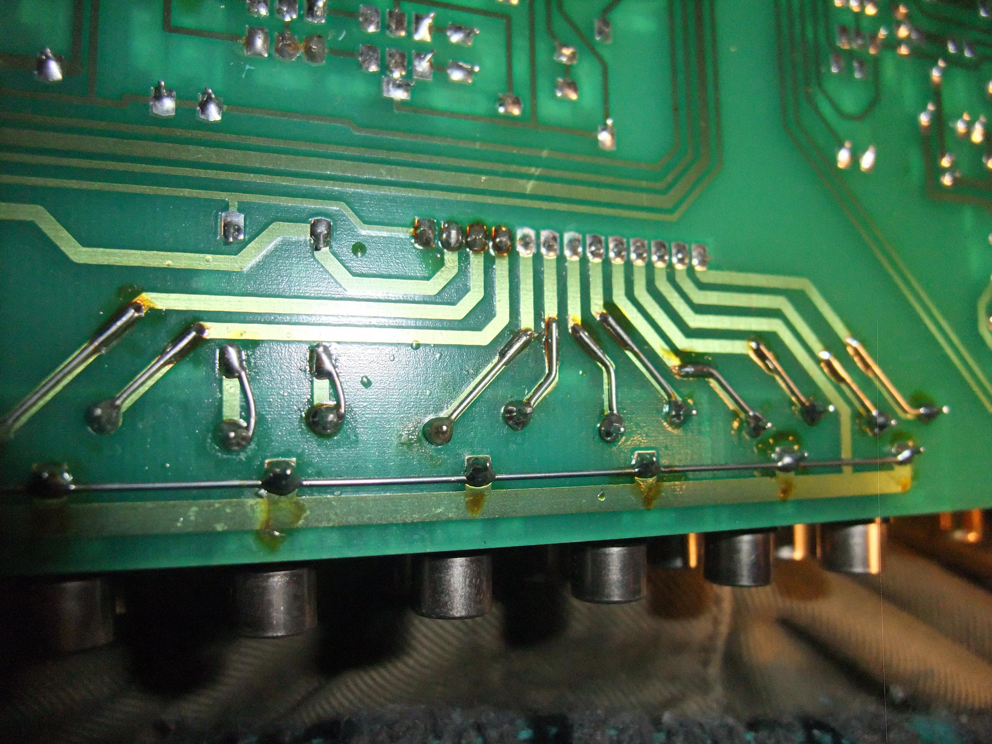

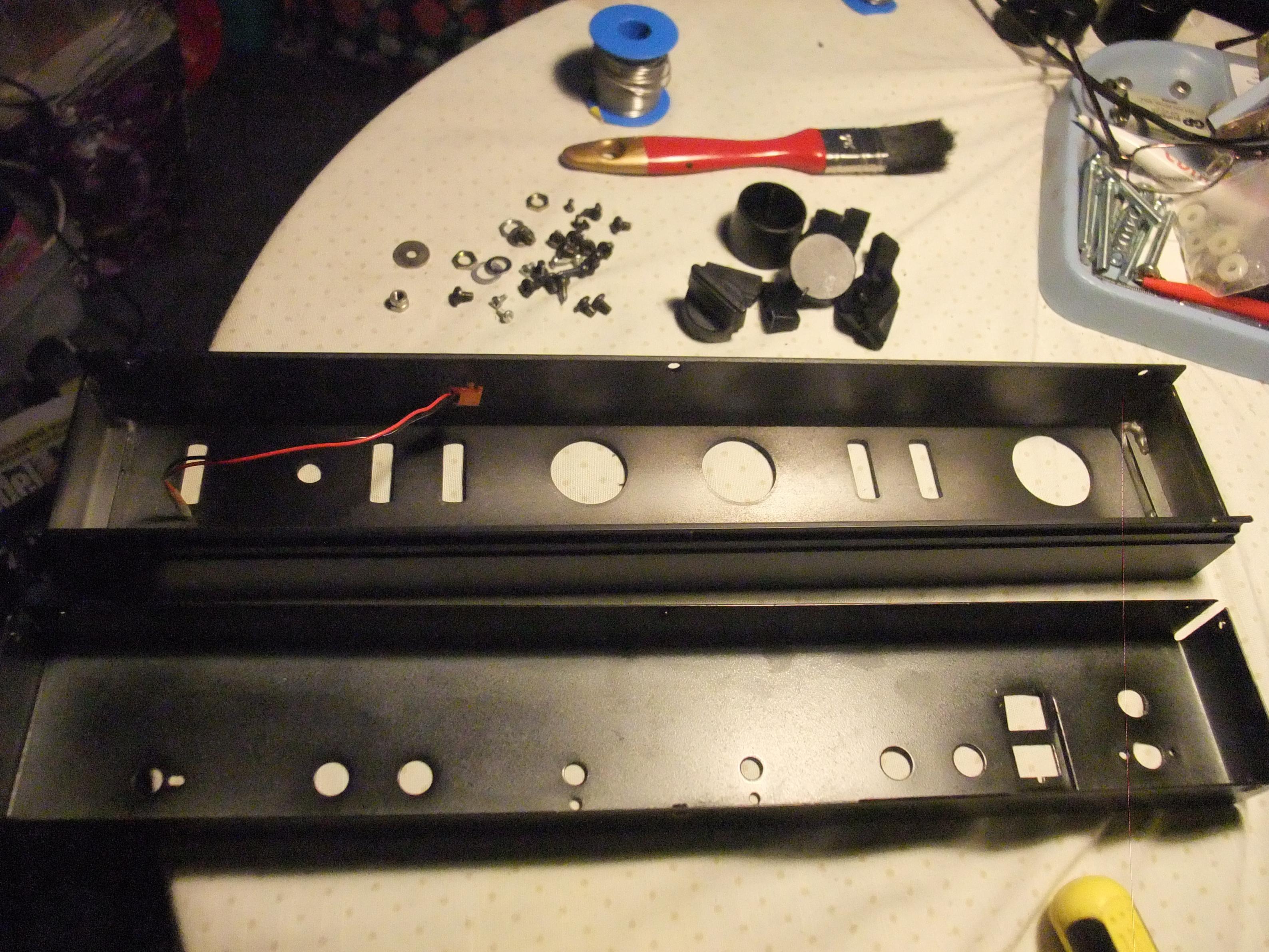

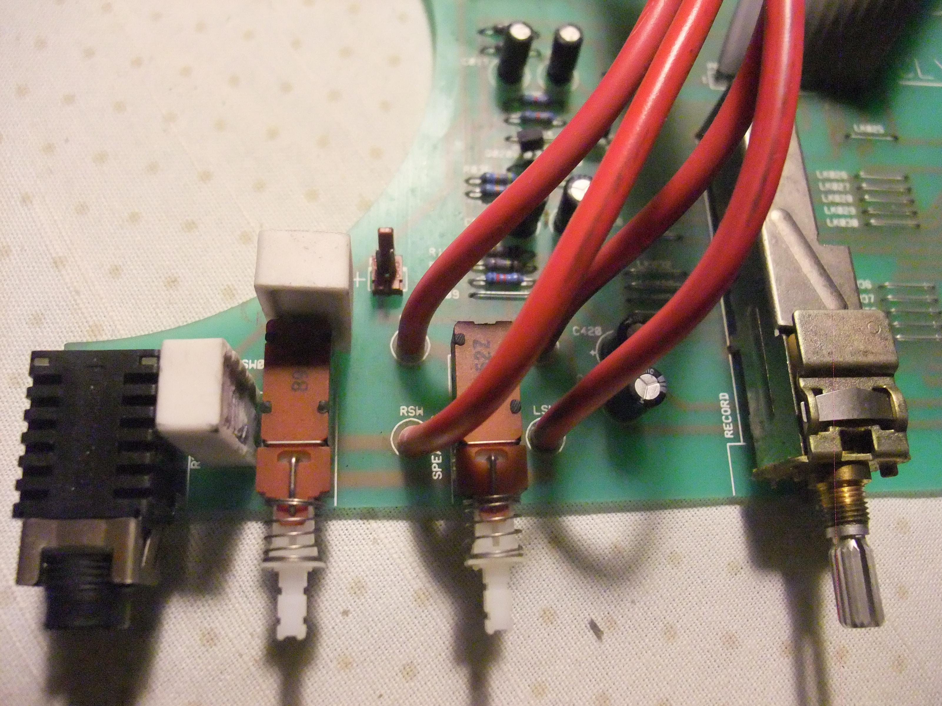

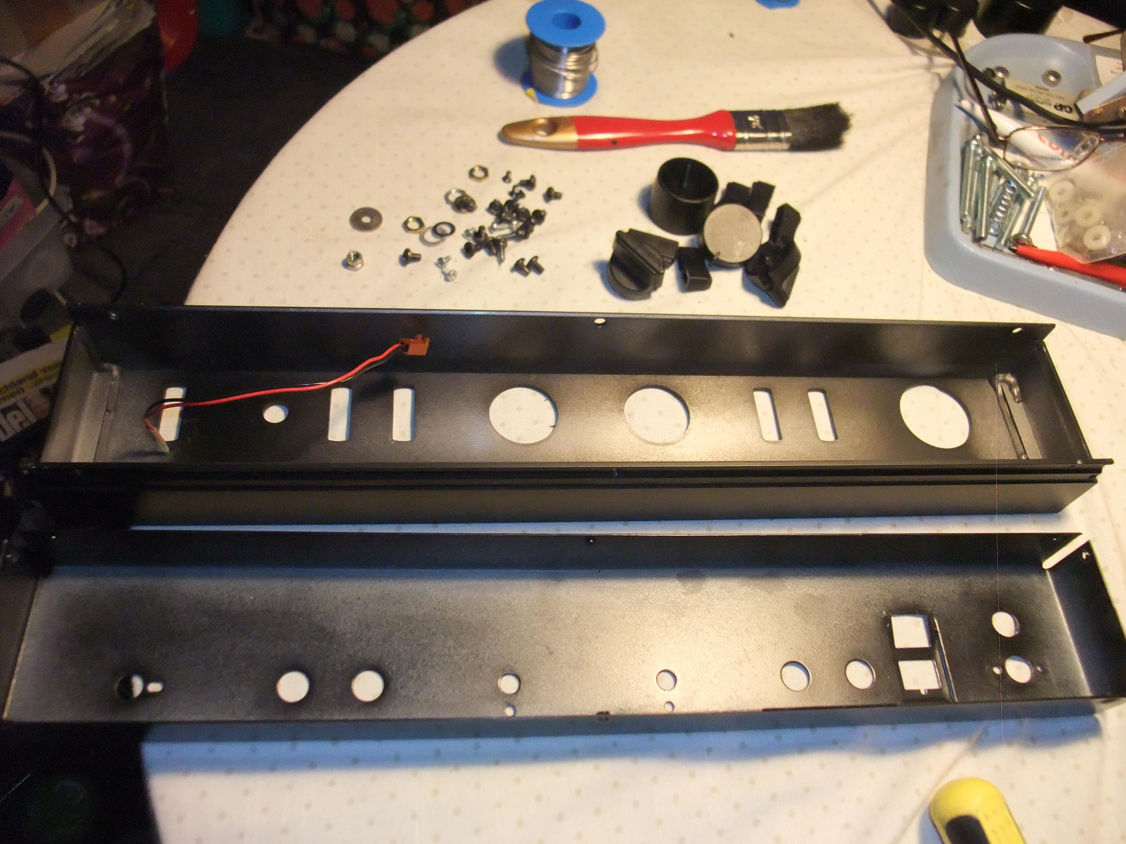

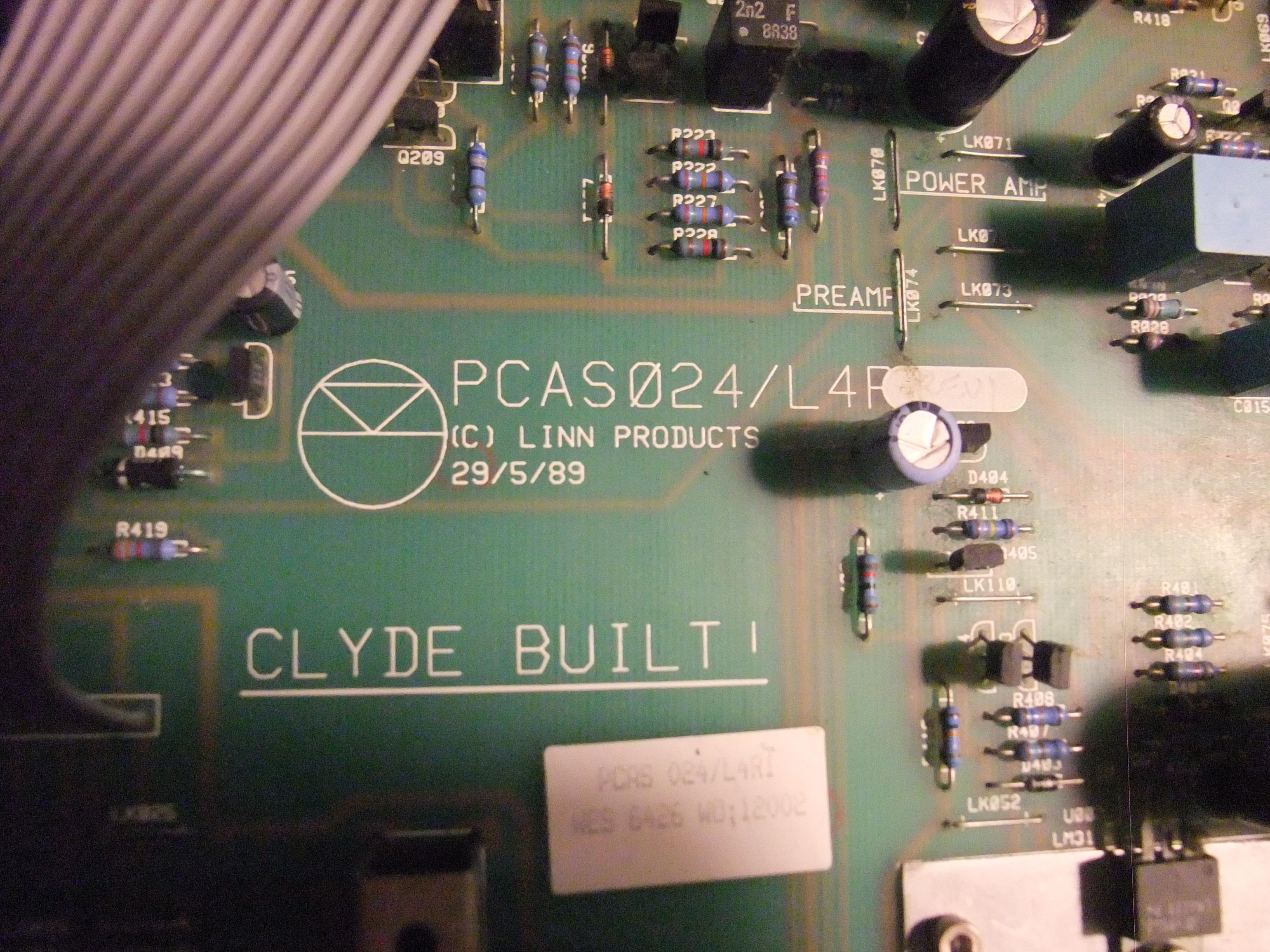

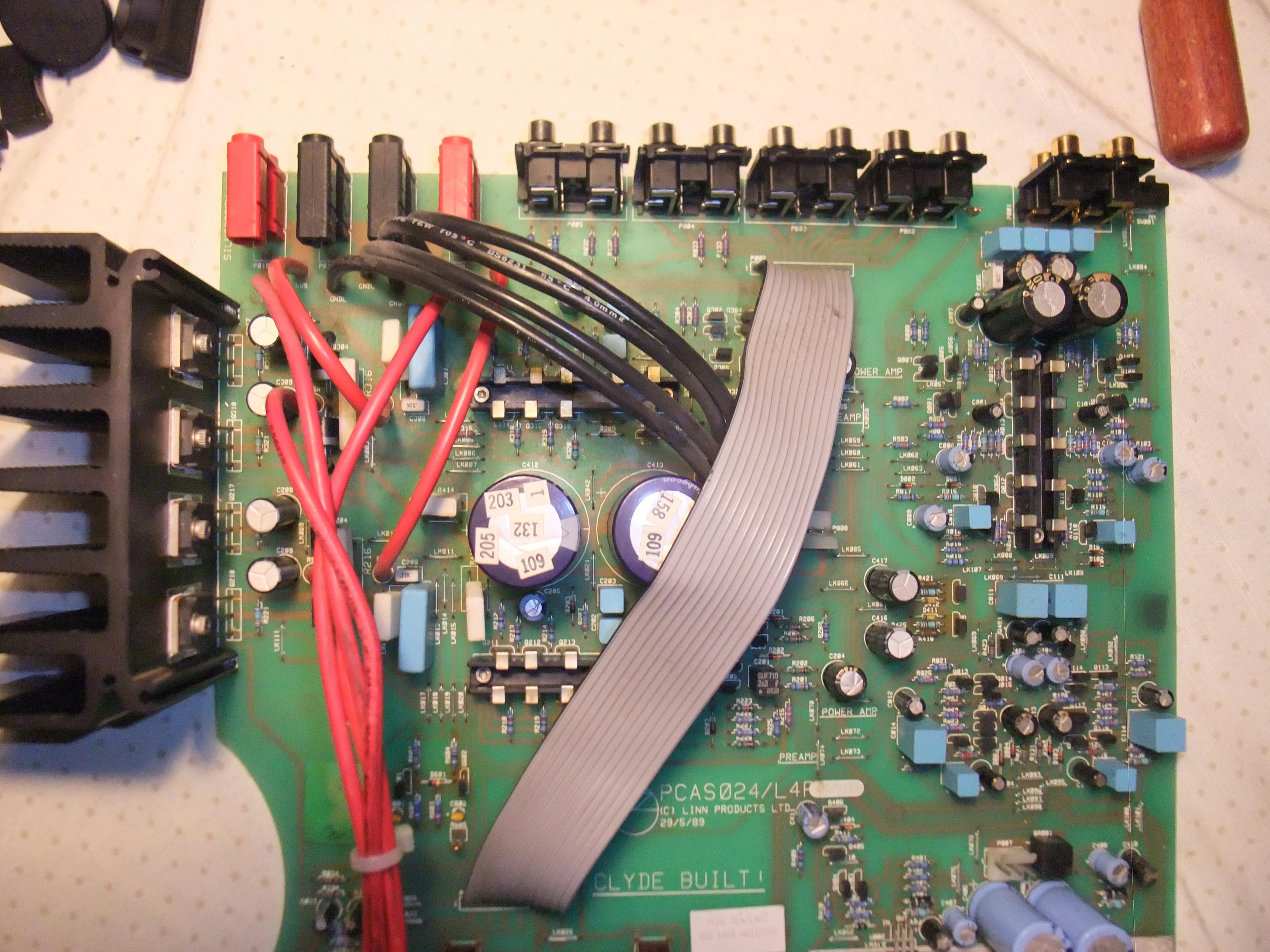

More pics. The kind of mounting requires a complete disassembly of this integrated amplifier to get to the bottom (solder side) of the PCB.
On the first image you will find a layer of fat on the PCB surface - this means, the amplifier was near a cooker in the kitchen at the previous owner.

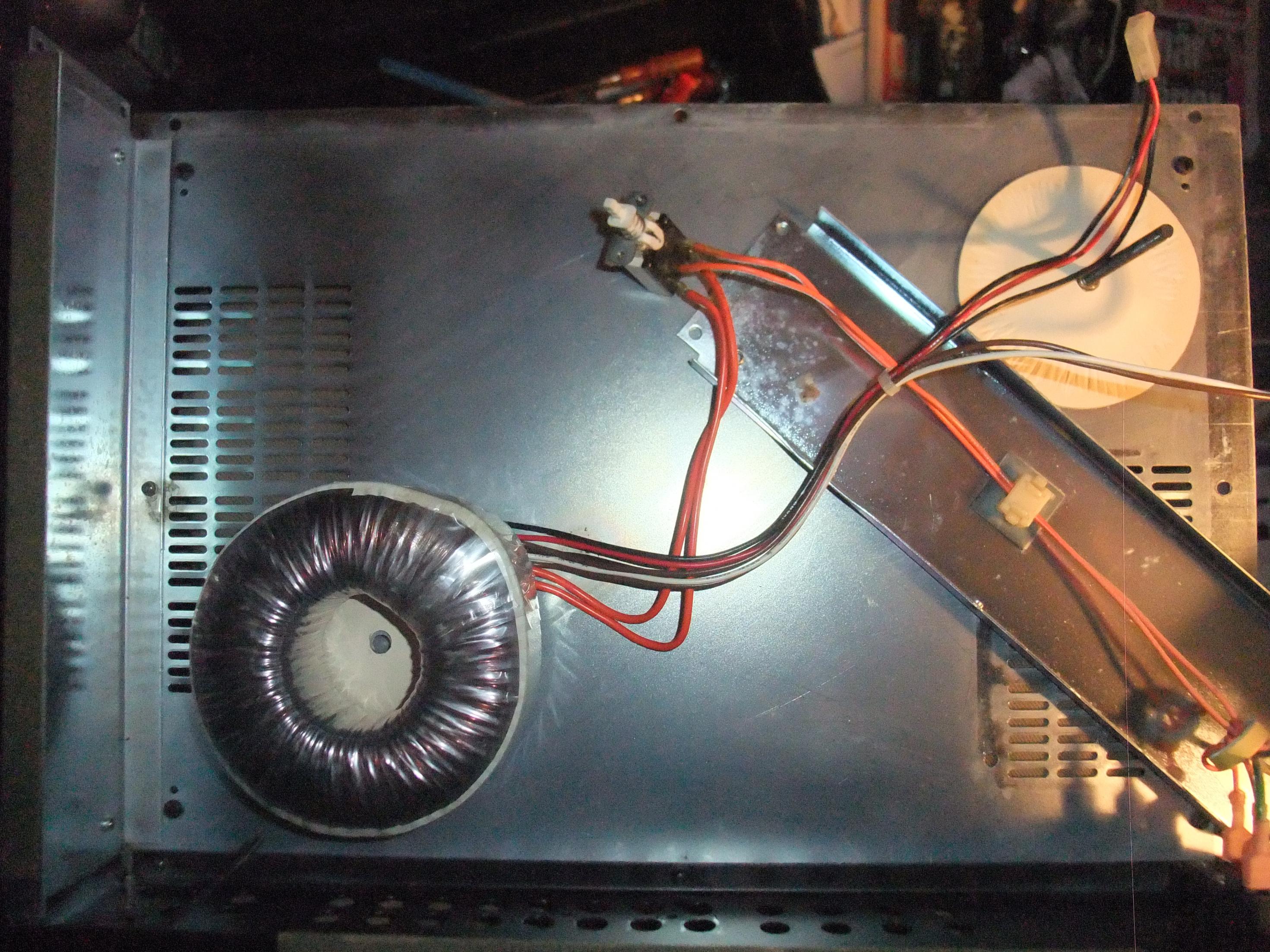

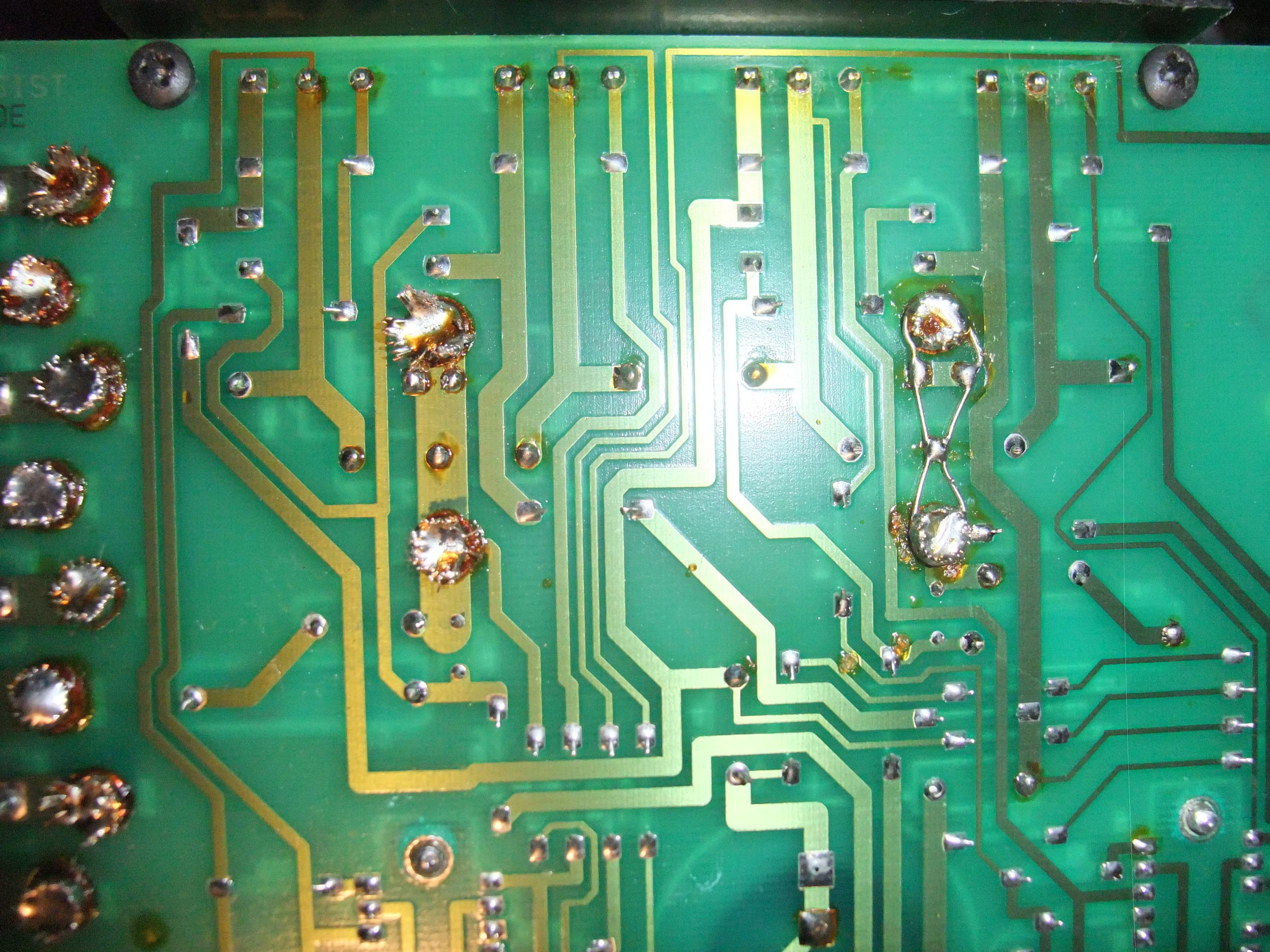

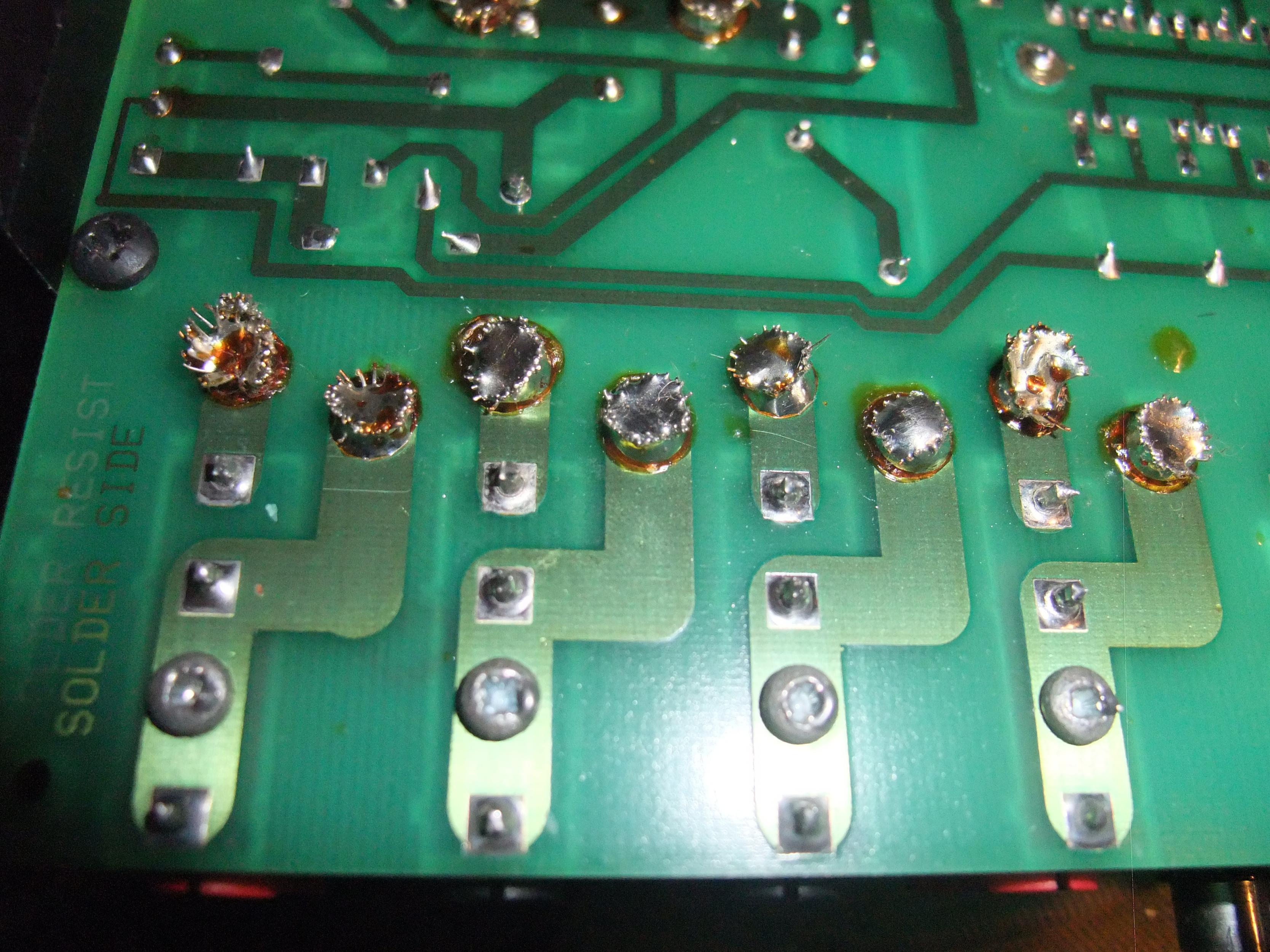

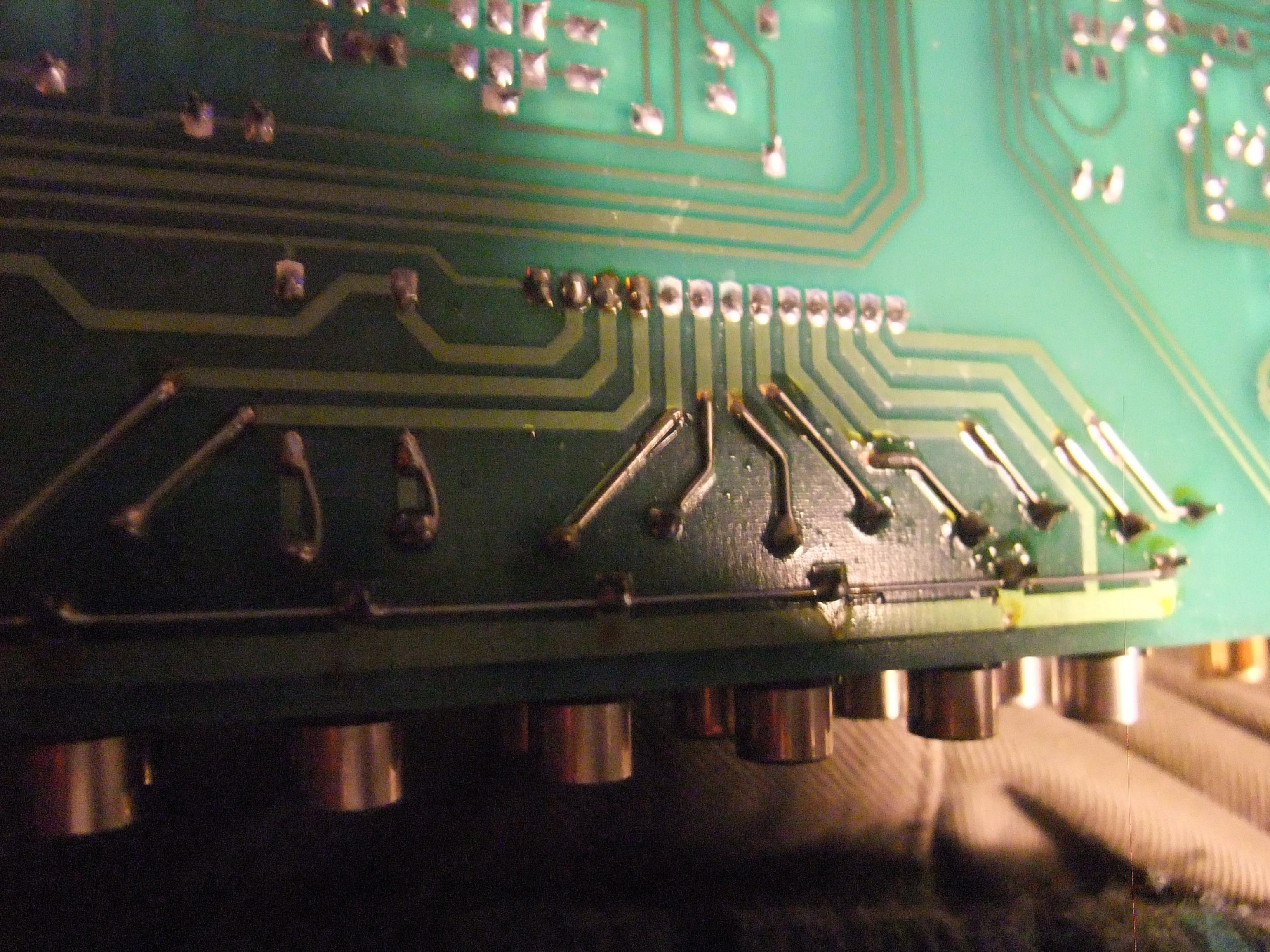

in this attachment there are discover interesting additional steps to improve soldering and contact reliability of cinch-Sockets and the big capacitors behind the rectifier.
