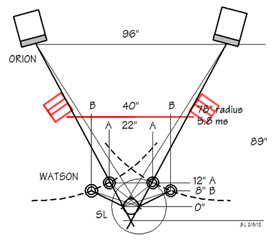

I have moved my dipole speakers nearer to my listening position. Compared to the Watson situation they are at the red positions:
I found that I can have much of the claimed Watson advantages without the added hassle. When I leave the reverberation dominated distance by moving from reclined seating to a forward leaning position, the acoustic scene narrows from 90+° to 60°, sound images get nailed at their position and details abound.
I wonder when SL will abandon the Orions altogether and listen solely to some speakers at the Watson position
