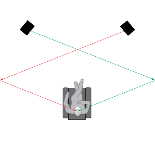

Please also try my cross-firing technique. The idea is simple, aim each speaker at or near the first reflection point of the opposite wall.
attachment.php
Vary toe-in to get the ratio between direct and reflected sound right. Depending on your speaker's off-axis response you might need to apply equalization.

Markus -yes, I've tried that. I was interesting, but with my rig it just didn't sound as good as pointing the speakers at me.
