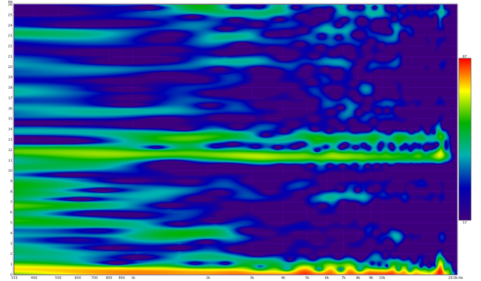

For what it's worth, left speaker at listening position, with absorption of contralateral reflection:
attachment.php

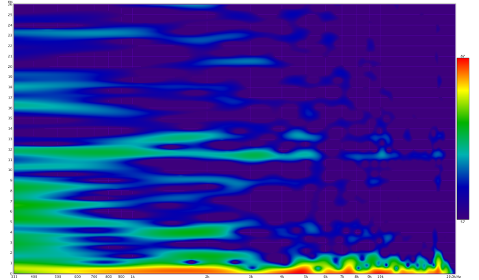

With no absorption:
attachment.php
Settings are the same as in your graph.
I would also look at the first 1ms range. If it can drop 15db or more in the first 0.5ms, then it's quite good.
But your barrier experience shows, that "near field" ist still full of crosstalk and reflections dominated by the listening room. Could it be that you need to change to binaural listening completely? Stereo simply isn't up to your standards. ;)
Rudolf
I don't think the barrier has much to do with room reflections. I think it removes spurious time delay cues caused by crosstalk of the direct signal. My current barrier is just 50x100cm in size, i.e. the speaker "sees" a barrier of 50x50cm which blocks frequencies from 700Hz and higher.
