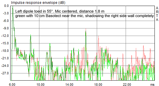

I was doing some experiments with increased speaker toe-in. At 56° I get a pretty spacious presentation.
Markus, that's funny. After my own barrier experiment I toed in the speakers a little bit more, because I liked it. Now that I measured how much - they are at 55° :)
I measured the left speaker again (from some more distance than last time) and then blocked everything coming from the right wall by placing 10 cm Basotect right next to the microphone:
The effect is basicly the same as in your experiment. I had tried to find the single contralateral reflection point on the wall itself and to put the Basotect up there, but to no avail. There was no single point to do it all.

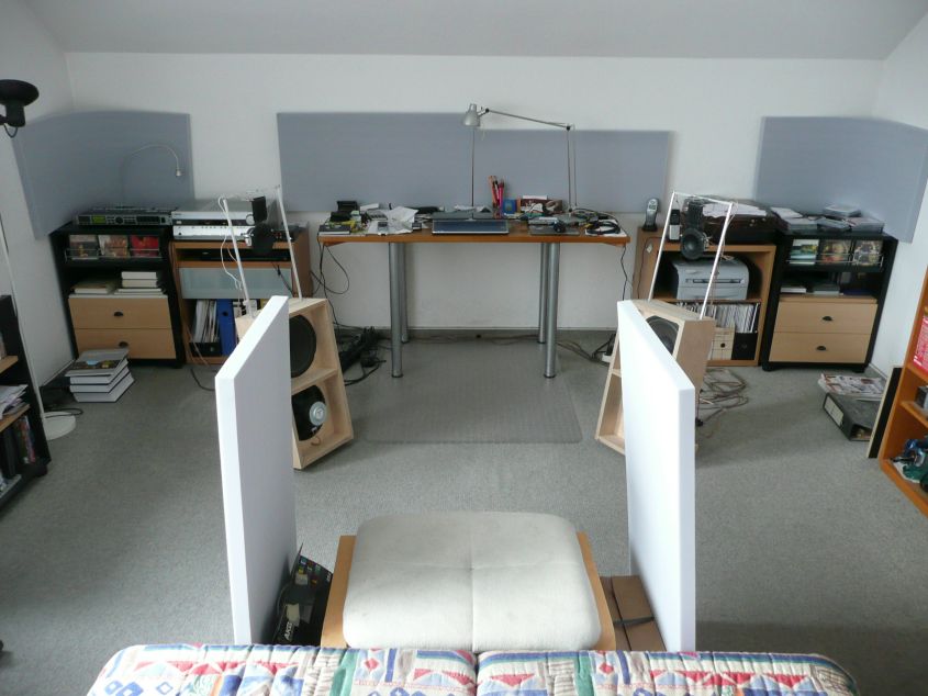

After that I build a two-sided barrier to remove all contralateral reflections when listening:
It is like you experienced already:
Now the image is more detailed and localization is improved but all spaciousness (and depth) is gone.
I put depth in "()" because I feel a little bit different about the depth impression than you. For the rest this barrier works equivalent to the ambio barrier for me: More precision and detail in the acoustic scene but everything moved away from me - both in spatial distance and in emotional affiliation. :(
That's not the way I enjoy music best.

For posted ETC, can you show spectrum of 12ms region of results compared to direct sound using short (3ms) window?

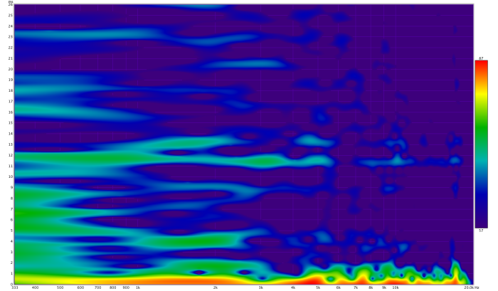

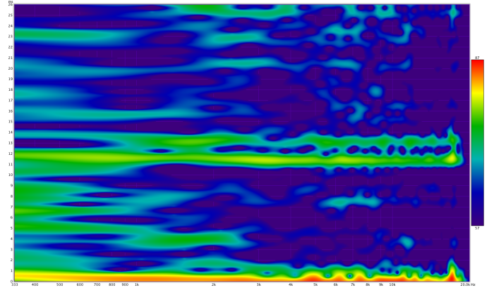

For what it's worth, left speaker at listening position, with absorption of contralateral reflection:
attachment.php
With no absorption:
attachment.php
Settings are the same as in your graph.
