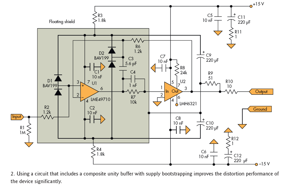

bootstrapped supply composite op amp + buffer - reduces even the input stage nonlinear common mode impedance
http://www.epanorama.net/sff/Misc/O...g to reduce distortion in op-amp circuits.pdf
Supply Bootstrapping Reduces Distortion In Op-Amp Circuits | New operational amplifiers optimized for high-performance audio and ultrasound applications combine extremely low total harmonic distortion plus noise (THD+N), -130 dB, with large output vo
I recommend looking beyond "buffer" IC with fixed internal unity gain - more options are available in CFA op amps designed for DSL driver applications - I've used the TPA6120 which is a audio speced version of the THS6012 for composite amp output stages
CFA op amps can be used unity gain with a feedback R - you can even size the R value to "overcompensate", increase stability margins

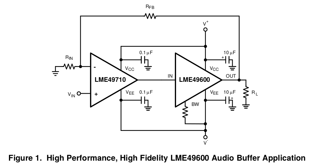

Thanks jcx!
The schematic you posted is a bit complicated for me to read right away, but I've got a basic idea.
So far I've been thinking of using the schematic from LME49600 datasheet (see attached). And not too fancy PSU of proven design.

its hard to tell since many buffer IC datasheets that do give audio distortion numbers actually give it for the composite - not the just the buffer alone
certainly if you don't have the experience and the equipment then stick to the datasheet circuit or established project amp schematics
for few kOhm or less attenuator Zout the input common mode nonlinearity distortion shouldn't be above the noise in many audio op amps
