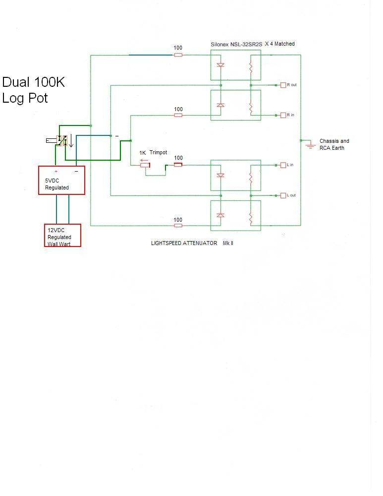

Remember you only insert one 1k trimpot on the louder of the two channels
To calibrate the matching finer after I've hard wax potted the 4 X NSL32SR2S together, and the wax has cooled completely. I use a 1khz sine wave from an Audio Frequency Generator at around 1v and view both channels on my Oscilloscope and adjust the 1k trimpot so both sine waves are averaging the same level at different volume control settings.
You could do this using a good DMM best if you have two. Or it will be almost as much of a headache as matching the LDR's.
As for your low level listening, sounds like you need higher input impedance on your amps, as I remember you said they were 10k? this is too low for the Lightspeed Attenuator ( I find it compresses the dynamics). Or it could be that you need an active "Loudness" button that all pre's could do with at low levels.
Cheers George

You've got to remember with my production Lightspeed Attenuators I always ask the customer their amp and cd player output and input resistances if something does not gel I let them know what to do about it.
You have an amp that is 10kohm (bad) and the Lightspeed is around 7kohm ( if made like my production ones), the to two added together will load the CD player's output with 4.1kohm.
If you have a high output impedance or weak solid state or tube output on your CD player this load will not be kind to it.
Analogy: Look what happens to an amp that finds a speaker hard to drive because of it's load, at worse it can clip, but it usually before that happens it sounds thin lacking in body and edgy.
Cheers George

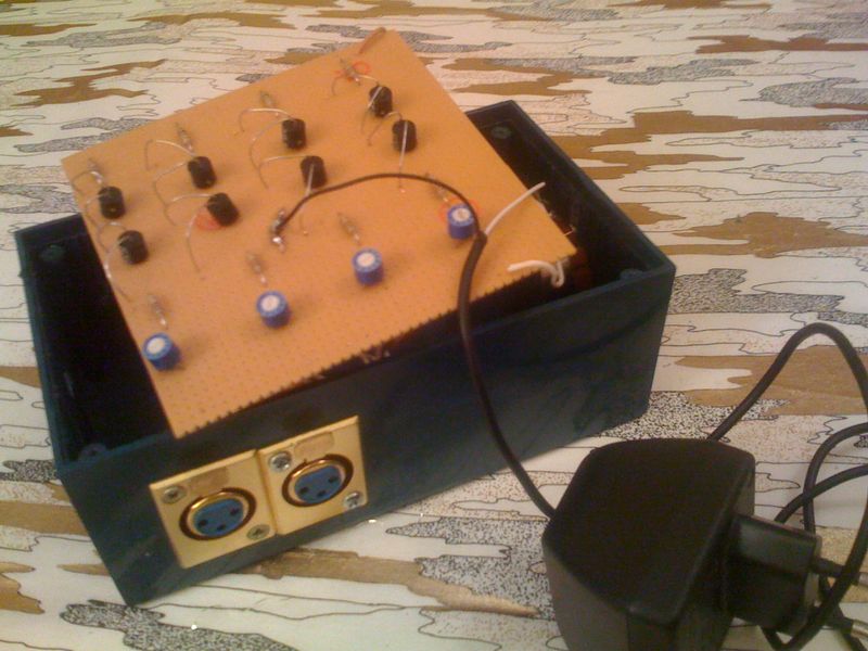

Thank you James. I did a try before going to bed yesterday night with a very simple operational amplifier mounted in follower mode (a couple of LME 49720) and the observed phenomenon at low level remain... I concluded that there isn't an impedance issue !
Moreover, the impact and intensity of the lows are just amazing, that wouldn't be the case with an impedance mismatch, or this mismatch just appears for low levels ?
Perhaps somebody knows what happens if one use a too high or a too low power supply ? Anyone tried batteries instead ? With a charger, it'll be perhaps the best solution isn't ?
I'll try with different PSU now and we'll see...
For an enough high level, all is pretty good, the sound is just incredible, better than with my third opus of auto-transformer (which still reached a very very good audio quality indeed, much better than most active preamps, even some swiss made costly gear...). We have more presence, transparency, the sound stage is very large, the voices are more natural, with a very good stability for high frequency at high levels, the dark side is the mixing errors are more evident too !...
Enclosed a picture of my first balanced LS opus !

Hello George,
As explained in one post above, the anomaly at low levels is not just a lack of bass, but really a degradation of sound becoming like a not well tuned FM radio station, with very audible crackling and duplication of the sound (a sort of echo), do you see what I mean ?
I'm quite sure this is not due to an impedance mismatch... When I increase the volume, this phenomenon disappears totally and the sound becomes clear, punchy, with very consistent bass and a beautiful transparency, presence and details, well a quite perfect audition indeed, better at this point then with my best auto-former !...

Yes I did delete, I jumped the gun I wanted to wait for more info from you before I commented.
You have a real big problem, I fear maybe you have faulty NSL32SR2S's, your post back a while, you stated that the impedance range you got was
Quote:> I finally did the job ! I found 2 groups very close from each other with resistances ranging from 35 to 110 ohms for 2 to 5 Volts. The third group had a larger dispersion (from 20 ohms for the lowest value to 140 ohms for the highest) <:Quote
This to me sounds very very odd as the full light to total dark reading of these units from the specs is 40ohms to 5megohms, and you got 20-120ohms????
I have never ever had one that goes down to 20ohms ?
And as far as the upper reading of 120ohms you got, this is 4,000 x less than spec.
Cheers George
Well, George I think my English is far from to be perfect unfortunately and I am sorry for this but anyway I must do with it...
Of course, for the full 5 Volts I got more than this 110 ohm (or 140 ohm) values ! The range reported was for matching purposes only (5 points measured for each of the 20 NSLs). After these measures I got the 3 groups, I built my LS with the first group (i. e. having the closest values for the 5 measured points).
It's almost impossible that the NSLs are faulty, since I suppose if it's the case I'll never reach such a degree of audio quality (see waht I said about it on two posts above) as soon as the voltage control through my 100k pot is increased to reach even not so louder levels...
Then otherwise the NSL can be only partly faulty I think the issue is not to be searched neither from the NSL themselves nor to the impedance mismatch... I observed that the open value of my phone charger even supposed to be 5 V 300 mA indicates 5.6 volts on my DMM. I need to try a regulated PSU or batteries to be more confident with this point.

It becomes obvious now after all this that you do not have good power supply, so comments about low level sound of the Lightspeed is not of the Lightspeed it self but the phone charger power supply you are using.
As I have stated many times on this thread the production Lightspeed Attenuator that I make has first 12vdc Linear Regulated 300mA supply that is then fed to a second 5vdc Linear Regulated supply, I also have stated on the forum and in the instructions that a Switch Mode type (phone charger) regulated supplies are not to be used, they have too much HF garbage in them, that can be detrimental to the sound.

Well George, with another PS the sound is now quite perfect ! I face a new incident (as it wasn't the case yesterday night...) : I have a noticeable balance mismatch with my left channel much louder than the right one (no tweak has been performed yet on the trimpot since I haven't any oscilloscope at home). I correct the drawback for the moment by changing the input sensitivity of my left monitor, but I need to determine what's wrong now ! Any suggestion welcome as usual !
Looking again the figure you provided few post ago, I noticed you draw a double pot... In the design I follow initially (i. e. the balanced one) you just drawn a single pot. Is there any possibility to introduce some balance mismatches with the mono pot ? Do you think a double pot will be a better solution ?
I'll modify my new PSU with some rectifiers to achieve a more stable 5 V supply...

NOW all is perfect !... The pot was faulty (why ????).
No more crackling no more echoes, just THE music !...
Again thank you George you are indeed a great guy !
Hope a lot of audiophiles have the opportunity to build this really amazing interface !
