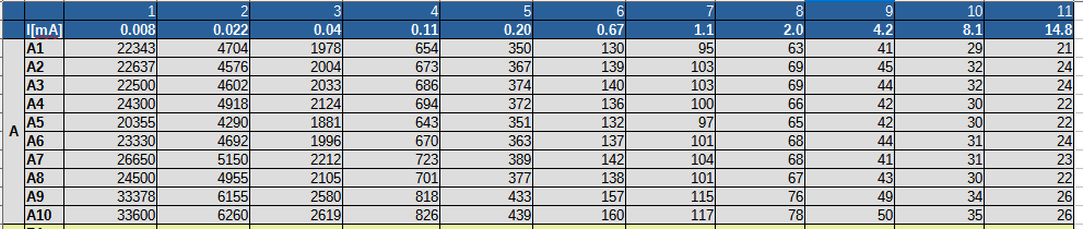

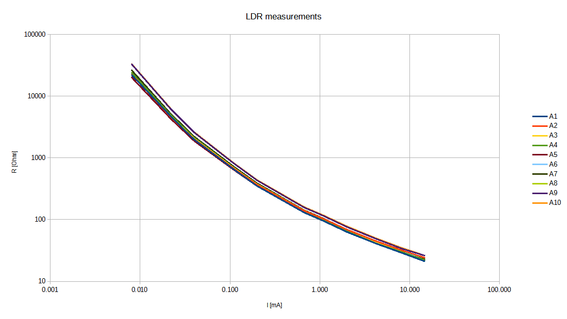

I completed the measurements on the first set of 10 units. These are in series so they all share the same current:
What I noticed is that at 14.8mA I get 21-26 Ohms. I think I have a good match on the first 8 units. I will look into the statistics on these 8 units to see how good the match is.

If you ask me, you're making a mountain out of a mole hill, simply all you have to do is match up the impedance of the quad set of NSL's at 3 x mA points 2.5mA 10mA 20mA and then calibrate out any differences and the end with the 1kohm trim pot on the loudest channel, or if you want them even more matched so that maybe you can omit the trim pot then match up the impedances at 5 x points, say 1mA 5mA 10mA 15mA and 20mA

thx for the advise. I found the first 4 that have a good match (within 5%). I will build in the 1kOhm trim pot for final adjustment with a signal generator and scope.

Some questions:
- I noticed that I already get below 25Ohm at 14.8mA. Is this also what you get?

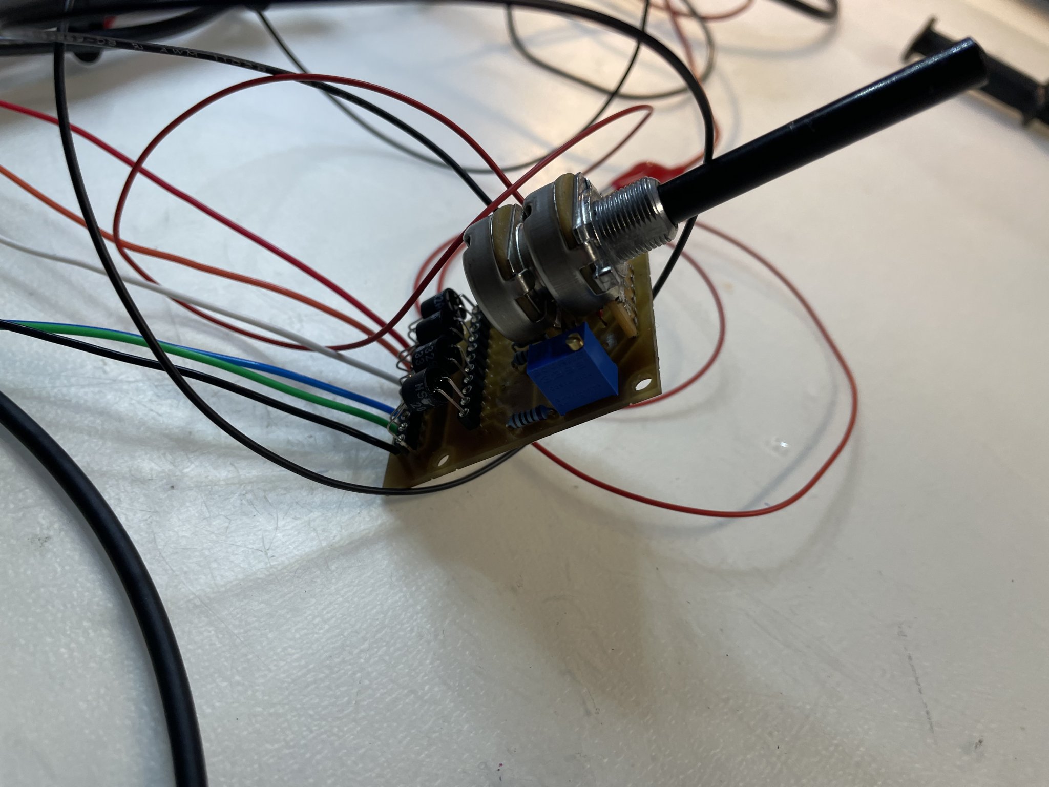

I milled a proto pcb to replace a pot in an integrated amp. I populated the pcb with the first quad of matched ldr’s. This is how it looks like:
the ldr’s are not yet soldered in but just inserted into the sockets.

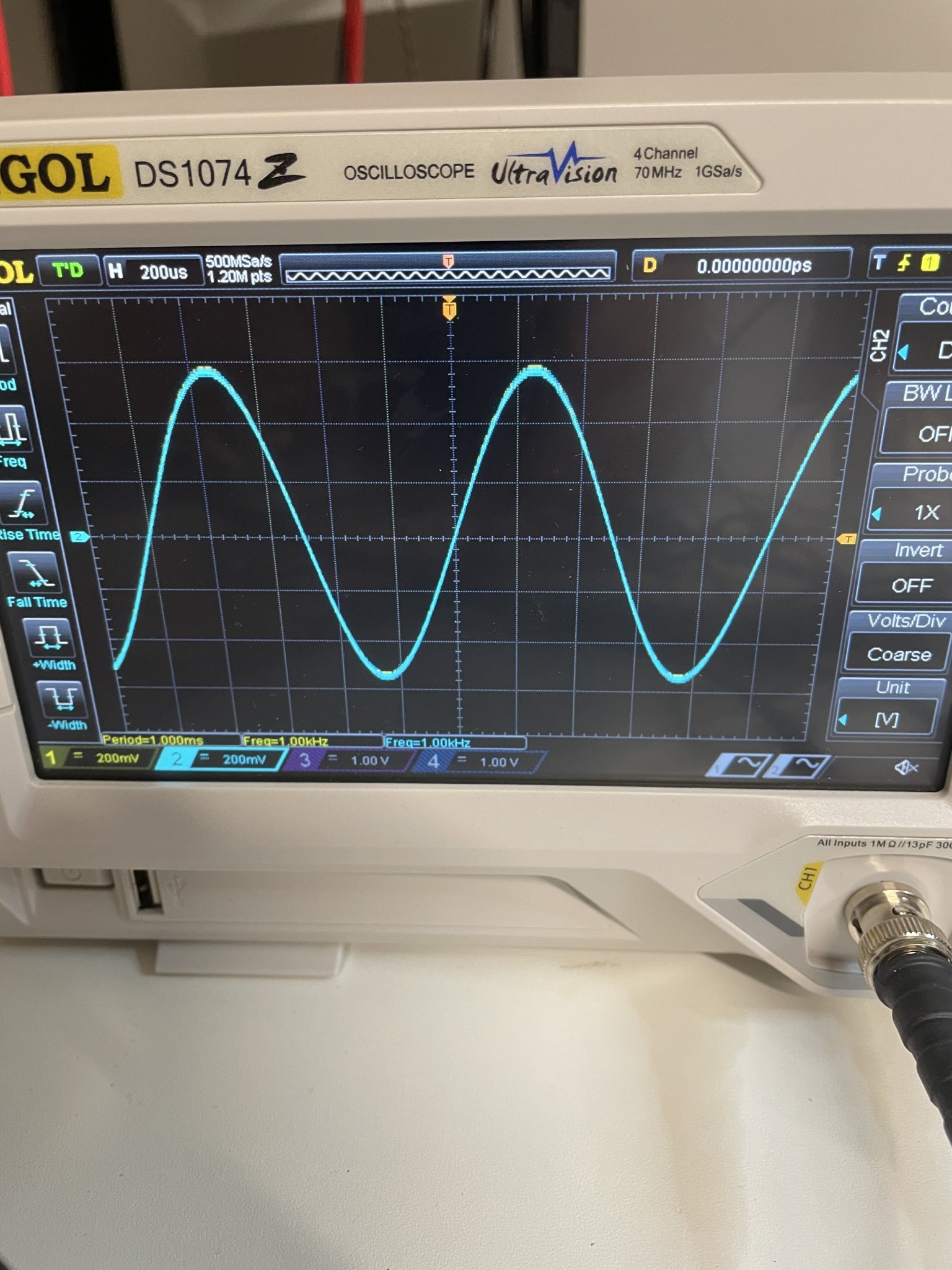

In this setup I can tune both channels with a trimpot ( I know one pot should be sufficient). I use a 1khz 1v sine wave on the input of both channels and only very minor adjustment was needed. This is how the channel match is now:

I have it running now in the amp and what can I say. I never expected this increase in sound quality. I am already very happy with as it is now. Still running on the lab psu. I am waiting for the lt3045 5V board now. I also designed a 3D printed housing for the the LDR's to pot them.

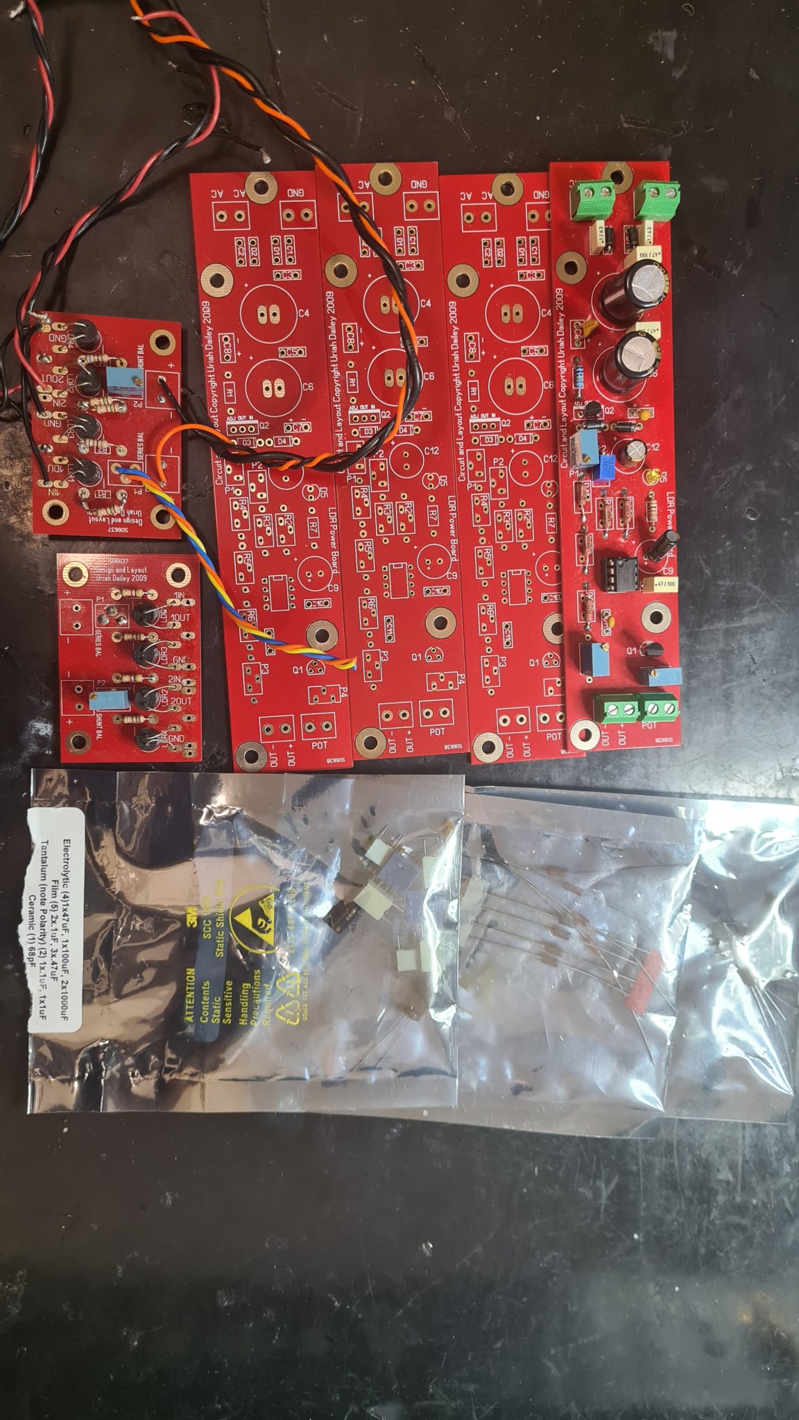

Hello folks,
The Lightspeed Attenuator journey continues !
Sourcing reliable, quality parts in our crazy world is certainly interesting….
At least at first, we’ll be offering the standard models ie The Single Level Control along with the Dual Level Control as an option.
Most importantly, if you have any ideas, constructive criticism, opinions or tips, please don’t hesitate to let me know.
Lastly, a new website is coming where you’ll find everything Lightspeed related in one place, with a clear & straightforward layout.

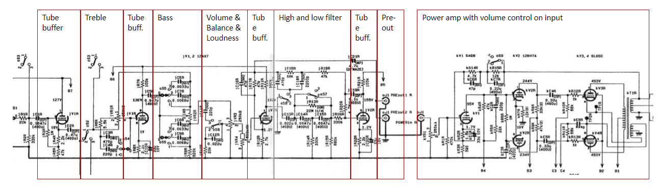

Another question:
I am also considering this volume control solution for a tube amp that I am working on. Originally i intended to replace the old pot's with a stepped attenuator.
The orginal amp has the following setup:
This is the shematic for tube amp
It looks to me that there are several section in the pre-amp with intermediate tube buffers.
Would it be possible to use the LDR in this circuit? I think the balance pot could still be used replacing the two adjustment pots for the left and right channel. I do not want to go to a pot for the left and right channel.
Could the power amp have another LDR?
regards
Harold

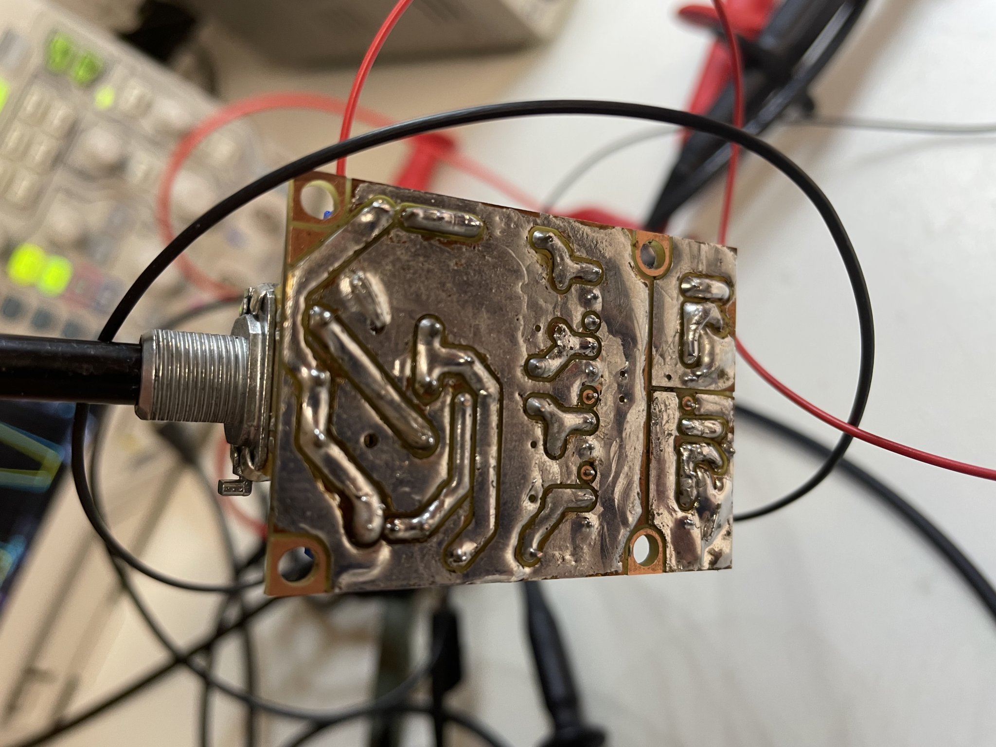

- I design a 3D printed housing for the LDR's so i can assemble 4 LDR's in a tight fit with some heatsink paste between the LDR's to couple them. I also milled a new PCB. This PCB is glued to the 3D printed housing and closes the housing on the top side. This PCB contains 4 100UF Oscons, 4 Murata 470nF SMD caps and the 4 100R resistors. Everything within a 31x23mm PCB. PSU is still the LT3045 but I am testing this with an LCR filter. Adding the SMD caps really was a next step in SQ but i am not sure yet if the LCR filter has any influence and If it contributes anything since I am using a linear power supply as source,
- With the new PCB the LDR legs are directly soldered to the PCB where normsally the wires from the original pot go (to have the shortest signal path).

Another question:
- a 250kB (linear) volume control pot with a log resistor of 33K and a loudness circuit
- coupled to a 500kMN balance pot
- a 250kA log pot in the input of the power amp
regards
Harold
