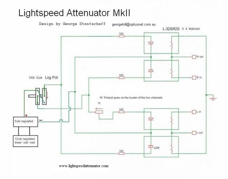

Changing gain is pretty easy. Can be done with one resistor. There are a lot of Dynaco buffs on the site. Im sure you can manage it. Other than that you can adapt your lightspeed to your situation by forcing series ldrs to stay high resistance and shunts to move slowly.
I suspect you also have efficient speakers. Efficient speakers and high gain dont work well with a lightspeed because of the minimum value you can achieve on the shunt ldrs.

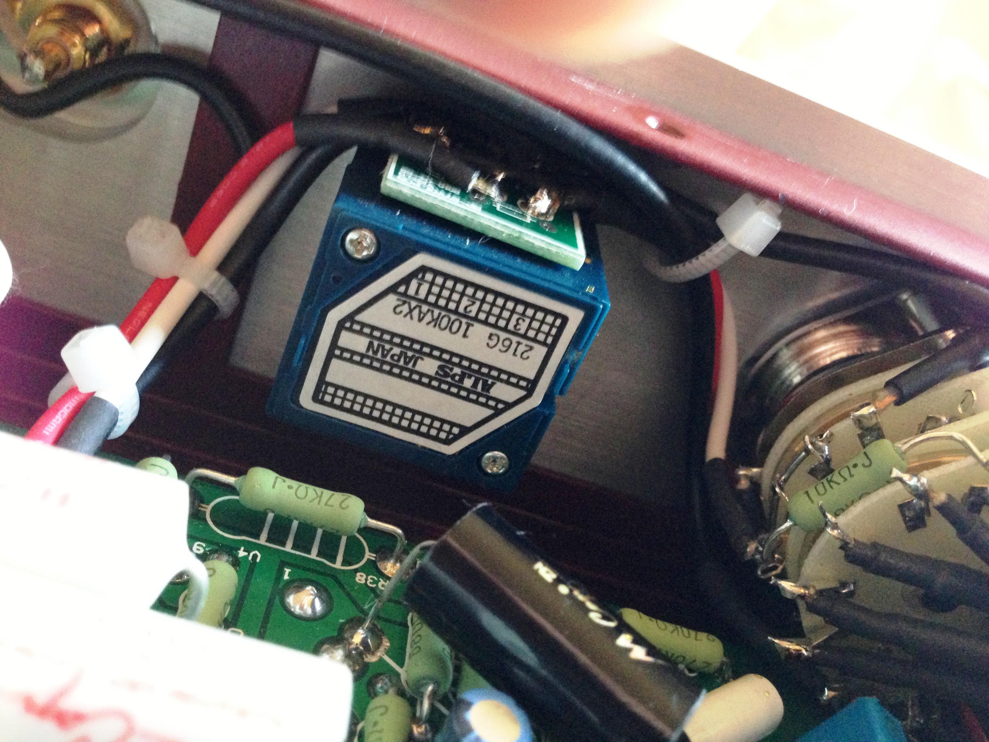

I put the Lightspeed Attenuator in place of a 100k alps blue pot and I ended up with excessive amounts of volume, I couldn't turn the pot past about 8'oclockGuys, I have tube preamp and it is 100K Alps there now. Would like to go and to try Opto-LDR, but not sure how to rich 100K as an original Alps has. Please advise.
Gdlen thats because of the system gain not the value of a pot/lightspeed. Were just dividing voltage and we could do that with a one ohm pot if we wanted. A buffer solves the issue like Andrew said.
I know that my pre has about 20dB of gain, but why does my alps "blue velvet" work fine with a normal range of adjustment?
does it have anything to do with linear vs logarithmic?
Try changing the 100kohm dual log pot of the Lightspeed I've seen the track/s crack with age or abuse, and seeing you bought yours S/H who knows it's history.

The ldrs may be changing value faster than the tracks on a log pot would. You could build a shunt attenuator with ldrs as the series elements. You set them where you want them then never change them. Use the pot as shunt element. Ive used this several time and it really works well. Better than I expected and sounds fantastic. Impedance varies but if you do the math it doesn't change much til the highest volume levels. No ldr matching required. Using a log pot means slow volume change.
20db is a lot of gain going into an amp. Huge really. Thats the kind of gain you need going into a power buffer like the F4 and not an amp with even more gain. I would try getting rid of the pre and just using the lightspeed into the amp.
Hi, I think I'd rather not change the Lightspeed if I can, as I do like to listen to it every now and then when the mood takes me, and it works fine going straight into the power amp. I am going to get a higher quality pot of some kind for the Dynaco, connecting the Lightspeed made me realize just how much a quality attenuator affects the sound.
20db is a lot, I'm going to try some 5751 tubes which should drop it down a couple of db, but I've never run into any problems as it is, 1 volt of actual music out of the preamp is deafening anyway.

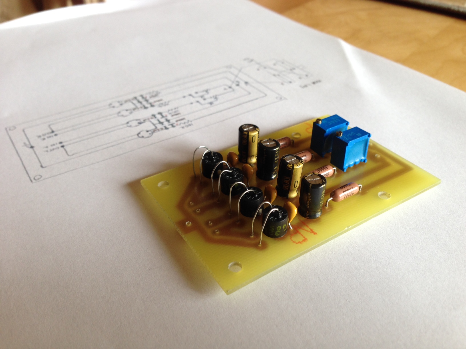

I used to sell them but you can build your own. Its not hard. Do not breathe the fumes. It hurts and is reaaly bad as in giving you asthma etc.
I made one for my DCB 1. Took me about 2 hours total. Not bad...
But then.. I saw these professionally made and I like to acquire one if you still have it for sale.
You only need the one trimpot, on the louder of the two channels.

I know and I shorted one on quiet side.
Thank you and it is a valuable point to others who are planing to build it.
