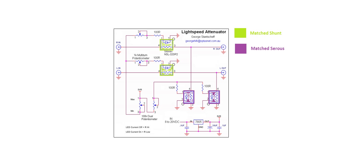

I'll try to re-match them again. Just to be clear 100%: 2 match will should go to shunt, and two other matched to serous?

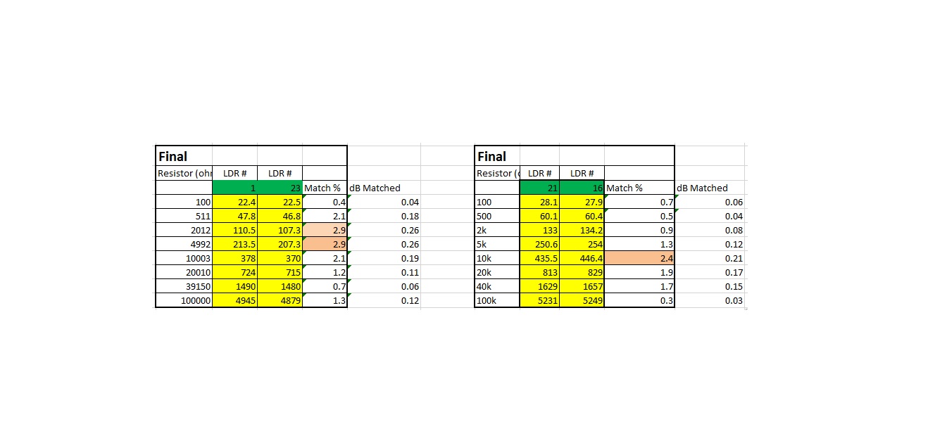

Finally, I'm done with the measurements and pair selection. It took me about 10 hours to finalized all 25 Optos.
So, in my previous selection (quick measurements) I got 1 set that matched after verification. 2nd set was way off particularly at the low mA. This way I got troubles I guess. So, now I used 15 min pre-heat and 2 min stabilization for each R value: 100R. 500R, 2K, 5K, 10K, 40K, 100K.
I have 2 new sets. Please see attached table. Also very nice P2P on potentiomer test when I placed Optos into PCB.
Thank you Andrew for dB cal. I calculated for direct R. I'll do soon for SpeedLight circuit when all components are in place.

Alexkosha, If you want to get a far better logarithmic feel to volume control progression, seeing your doing your own matching.
Try to get a quad matched set measured up as I do with the production Lightspeed Attenuator, this will give an excellent progressive feel to the volume controls advancement, instead of being too touchy, or way too slow.
And try to purchase the NSL32SR2S (sorted) as they have closer matched "on" resistances typically 40ohms for 20mA. Where the non sorted NSL32SR2 can have a much higher ohm variation in it's "on" resistance.
And at 1mA you get a (guaranteed +/- 1 range) of 100ohms to 110ohms with the NSL32SR2S.
(see attachments "typical" and "max" on resistance for both)
Cheers George

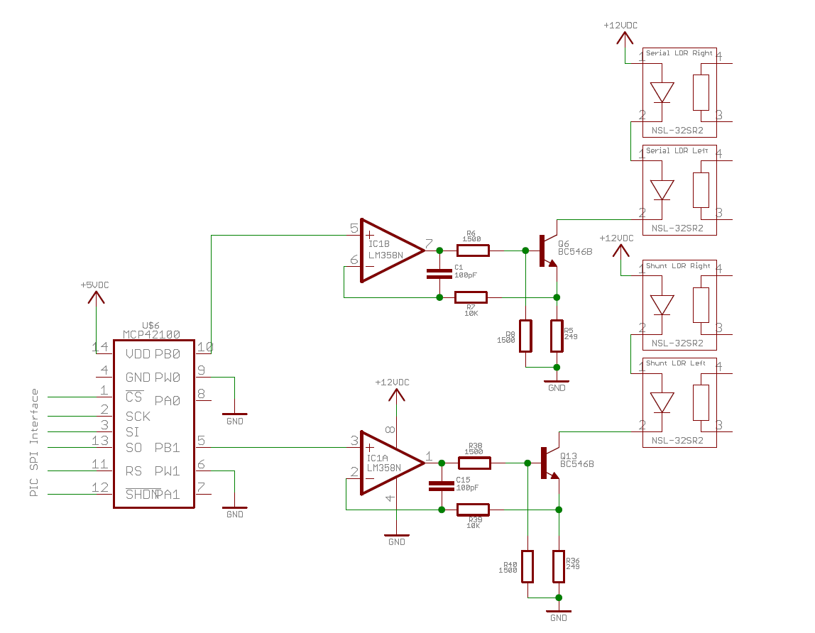

I have been using the "LDR-based-attenuation" for quite a while and am very content with it.

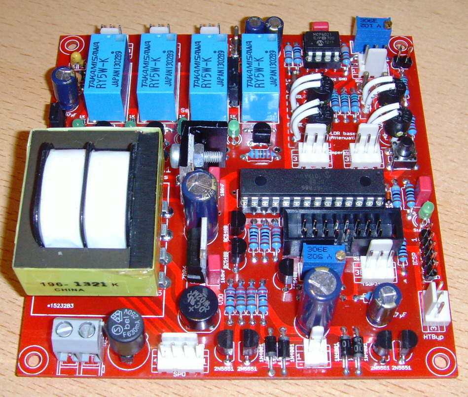

I am currently using a dual 100K log. motorized-potentiometer, which is driven by a MOTOR-H-Bridge and is controlled by IR by means of the PIC-processor of my PRE (see image 1).
But I found out that dual log. motorized-potentiometers differ a lot concerning their values.
For example: I have measured a 100K - potentiometer of producer x giving a value of at most 87K and have measured a more expensive potentiometer of producer y
giving a maximum value of 98K for section 1 and a value of 93K for section 2.
This is the reason that I have decided to change to a digital potentiometer for my future design.
Here it is (image 2):
I will use a 100K dual digital potentiometer (MCP42100) being followed by a VCCS, consisting of a LM358 and a BC546 and some discrete components.
The VCCS' sense resistor limits the current that is flowing through the LDRs to about 20mA.
My LTSPICE-simulation is showing the results that I am expecting.
I match the LDRs manually.
Will I do a big error following this idea?
Best regards - Rudi_Ratlos
