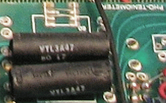

Looks like a VTL3A47, see pic
found these specs for it

tvi said:Looks like a VTL3A47, see pic

Not LED

If I read this right, there is a lightbulb in there and not a LED. Plus it is a 12 volt light. The LED based LDR should be more stable, linear, and reliable. This type of LDR might explain the negative reception from others.
But it is interesting to see what they used at the time. Remember reading about the light based attenuator back when these were first out. That was back in my tubes heydays, but owned a CAT and VTL Ultimate then. Being single at the time MIGHT have had something to do with it.

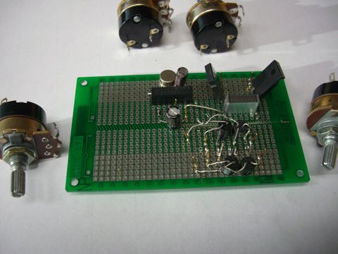

Like this?

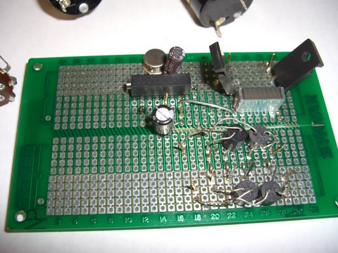

Recently built another board. This a top view, the reg is a LM317HVHP, the output is adjustable via the pot. A Vishay 1280G.
Lostcause said:Hey guy's,
Would it be a bad/good idea to put the 5V regulation and filtering on the same board? I'm pretty tight for space and this would help.

George (Houston), nice Vishay pot there. Lowest noise on the planet no doubt. By the way, I deal all the time with Texas Components, in your neighbourhood.

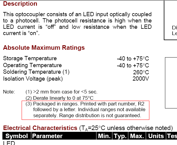

Although I can't seem to get these LDR's matched up The batch I got from Allied had a mix of ranges that go from A to E and trying to get 4 that are close enough is a nightmare.
Why do they not send all the same range? Seems silly to sort them and then mix them all back up again!

Lostcause said:Sorry...that should be thanks Panelhead!
When they are matched they should be all the same letter, I would email and complain that they sent non matched, this happened to me once and I kicked up a storm, eventually I went direct to Silonex with my complaint and they fixed it up.

I already complained but they just quoted the spec sheet and said they couldn't help! They did offer me 10% off my next order though...LIKE I'LL BE ORDERING FROM THEM AGAIN!!
Always read the small print!
