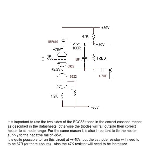

You still need your phono stage to do RIAA. The step transformer is just to get the cartridge output voltage level higher if too low.
Just post a schematic of your phono stage to see if it has low enough output impedamce and secondly to see if the gain can be increased.

Bins,
whats the input impedance of your amp?
whats the max resistance of your Lightspeed from input to ground?

I have only used a B1 and a DCB1. I prefer to get the right impedance out of my LDRs to match my system rather than use a buffer. The buffer giveth and the buffer also taketh away. Its the taketh away part that bugs me and doesnt sound as good as a well tuned set of LDRs.
Uriah
It helps with bass response. Thats about it from my point of view. Wider soundstage to but less depth is the worst of the taketh's. 3D imaging of female voices seems to collapse.
George recommends a tube buffer circuit that I have not tried and he recommends it with a caveat of 'no buffer is the best buffer.'
Honestly, getting this thing to work best with your system is way better than putting a buffer bandaid on it.
