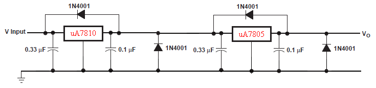

Hi George,
I am using the light speed MK II version. The supply circuit is based on uA7810 & uA7805. It is feed from a simple 12V DC wall wart adapter.
Best regards,
Bins.
Best regards,
Bins.
Post up your supply circuit including ldr's and all earth points.
Cheers George
