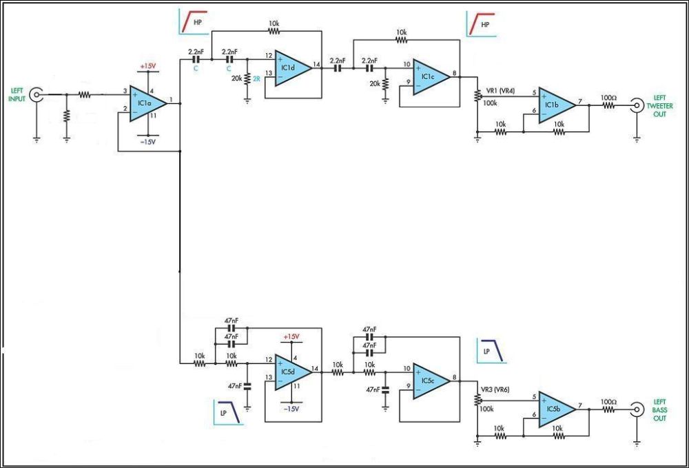

I will be doing a Lightspeed MkII and a Linkwitz-Riley Crossover from ESP. I was thinking about using the LM4562 with a 100k input impedance. Anyone have any other suggestion?
Oops!!! How do I increase the input impedance to 100k?
There are a lot of Analog Devices opamps that would be great as well, but you have chosen a very fondly looked upon opamp and while I have heard that it is a little bright I think that if you like the Lightspeed you will like the LM4562 as well since the main thing I like about the Lightspeed is its detail and accuracy which with a 'bright' opamp will just be more obvious.
If the LM4562 is fet input just make the input resistor 100k, if it is not you can still do it but your dc offset may vary or drift if it does then you'll need a coupling cap (dc blocking cap) yuck!

Yup, the cross over (with output buffer) that I am building is almost the same as the one you shown.
http://sound.westhost.com/project09.htm
It is too complex to use discretes, hence the opamp. I choose
the LM4562 as I think it one of the more accurate sounding one. I will use the TDA1541 dac to "tune" the sound. My only worry is that it will be too bright sounding as I will be using LM4562 for all the opamps in the x-over. I am open to any other opamp suggestions.
From the specs, LM4562 input impedance is 30k for Differential Input Impedance and 1000M for Common Mode Input Impedance (I have no idea what is that)
http://www.national.com/ds/LM/LM4562.pdf
George, what is your suggestion for the value for series and shun resistors before the input buffer.
the input and output buffers can be non-inverting, as shown in the post attachment, or as inverting.
In inverting mode one can set up the buffers to gain of 1 (+0db) or as amplifiers with gain>1 (+>0dB) or as attenuators gain<1 (-0dB).
A single J170 or BF862 can be used in the buffer locations.
or go the whole hog and use a B1 buffer at these locations.
Similarly a Jfet can be used in the active filter opamp locations.
A three leg transistor and a couple of resistors is not much more space consuming than a dip.

I don't like coupling caps too... Skipping them all the way and will be using Isolating transformers at the output of the crossover.
Anyway guys thanks for all the suggestions. I finalize to use LM4562HA for the crossover to keep inline with the clean sound of the preamp and use a JFET buffer or the B1 after the TDA1451 to tweak the final sound.
